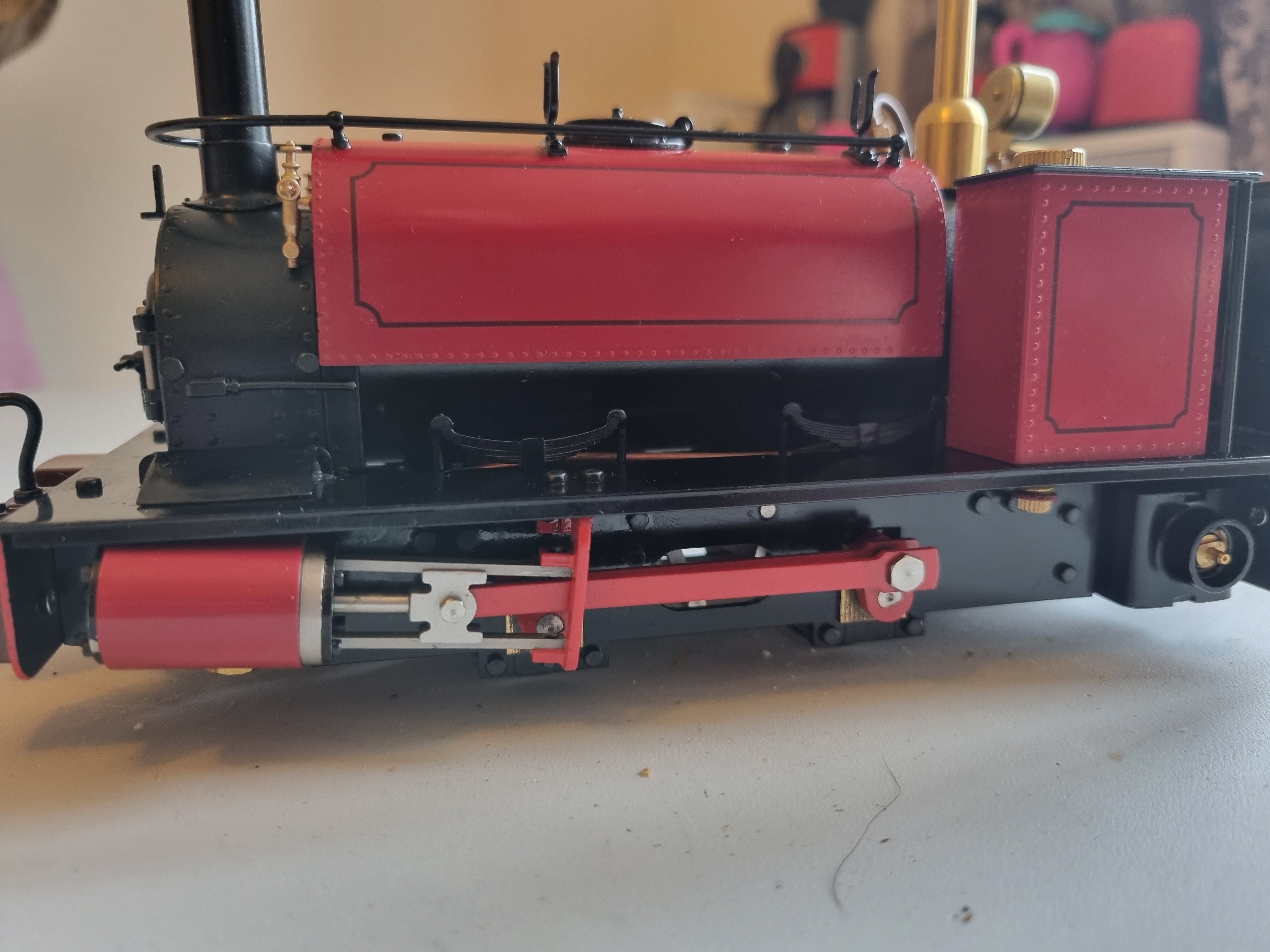

As an early 40th present to myself I decided to get a GRS/Bowande quarry hunslet.
It's arrived today & all is not well. The chimney & safety valves are at angles rather than straight. The saddle is also not sat straight with the tank going uphill towards to the chimney & the smokebox doesn't close properly.
I'm very disappointed as its a model I've wanted for a while. Has anyone else had this issue with one of the models?
The photos don't show the saddle angling up properly.

Well I have got to hand it to John at Grs. He has had a headache with dhl getting it back to the shop with them saying they've been to my house on several occasions for no one to be home even though we've waited specifically for them to arrive.
The models gone back & John couldn't believe it had been sent in such a state in the first place. He's talked me into a replacement which will hopefully arrive before Easter.

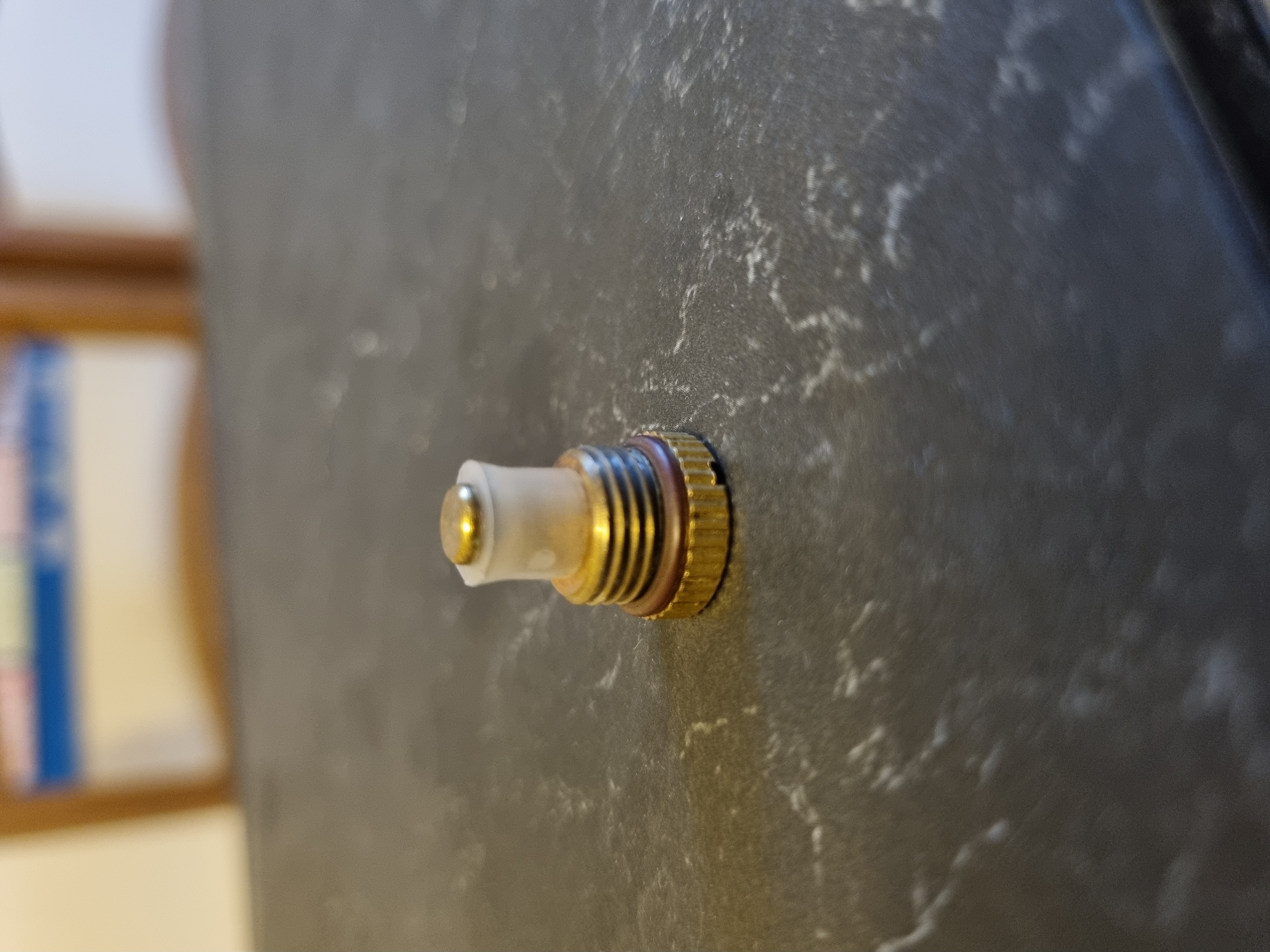

The loco is fitted with a goodall valve however it doesn't work with water just spraying back in your face.
The goodall valve has a large rubber sleeve on the inside but if removed I think it will not make the boiler airtight as I cannot see it working correctly.

You need to find a hose from your top-up bottle that is a good fit for the Goodall valve. I struggled as well with a generic water bottle, so cracked and bought a Regner top-up bottle. The hose on that has proved to be a good fit for both my engines fitted with Goodall valves.

I've spoke to Mark at GRS & he has told me to cut some of the silicone tube on the goodall valve to shorten it. Its tight sometimes & makes the goodall valve stops working.
The oil issues isn't an issue as such. It uses very little oil so that's a bonus.
I'm going to give the valve a cutting tonight & see if it can make it work any better.

Right, following Marks advice at GRS I've done a modification to the goodall valve by taking off a slice of the silicone tube. Unfortunately at the moment I cannot take a picture as my phone died & it's now here on charge by my bed. Basically the tube is too long & needs to be shortened so that water can just squeeze through. I will add a few photos of my modification tomorrow. I have steamed the hunslet a couple of times this evening to get her run in & whilst I still get a spray off the goodall the mods seem to work.
With the top up working I've discovered the best way to fire the little hunslet this evening.
First set the burner so It has a rasp sound. My usual method of firing most locos is to turn the gas right down once the pressure is achieved but doing this with the hunslet seems to drop pressure quickly & you get a stall. The loco seems to need a push off everytime & doesn't seem to gather enough pressure to move off its self no matter how the burner is set.
One thing I have noticed is that if you let the loco blow off I usually get a massive burst of steam & water shoot up out of the safety valve which puts the burner out. I tend now to let it get close to 60psi then open the regulator & clear out the cylinders.
Once done the little hunslet settles to around 40psi & will chug nicely around my track. Its a bit undulating in places so it does stop if pressure drops & needs a little push to restart. It flys off afterwards & will run at rather swift pace. I'm hoping with another few hours running it'll have got loosened off & may steam a little better.

Interesting. Definitely keep me posted how you get on. John had mentioned the same to me before I had steamed mine, that many of the valves had the tubing cut too long & just need trimming slightly.
Clearly I don't fully understand how the valve works. I figured the tubing seals the hole in the brass plug when acted on by boiler pressure, but that applying a greater pressure from the other side, with a filler bottle, overcame this pressure and allowed water past the tubing and into the boiler.
My tubing is cut slightly longer than in your pictures. If you manage to get it working please post pictures of your cut tubing & I'll do the same!

I cut mine last night & it's working, I still get spray back but it's filling the boiler, you can tell by the spikes on the pressure gauge & water gauge glass.
