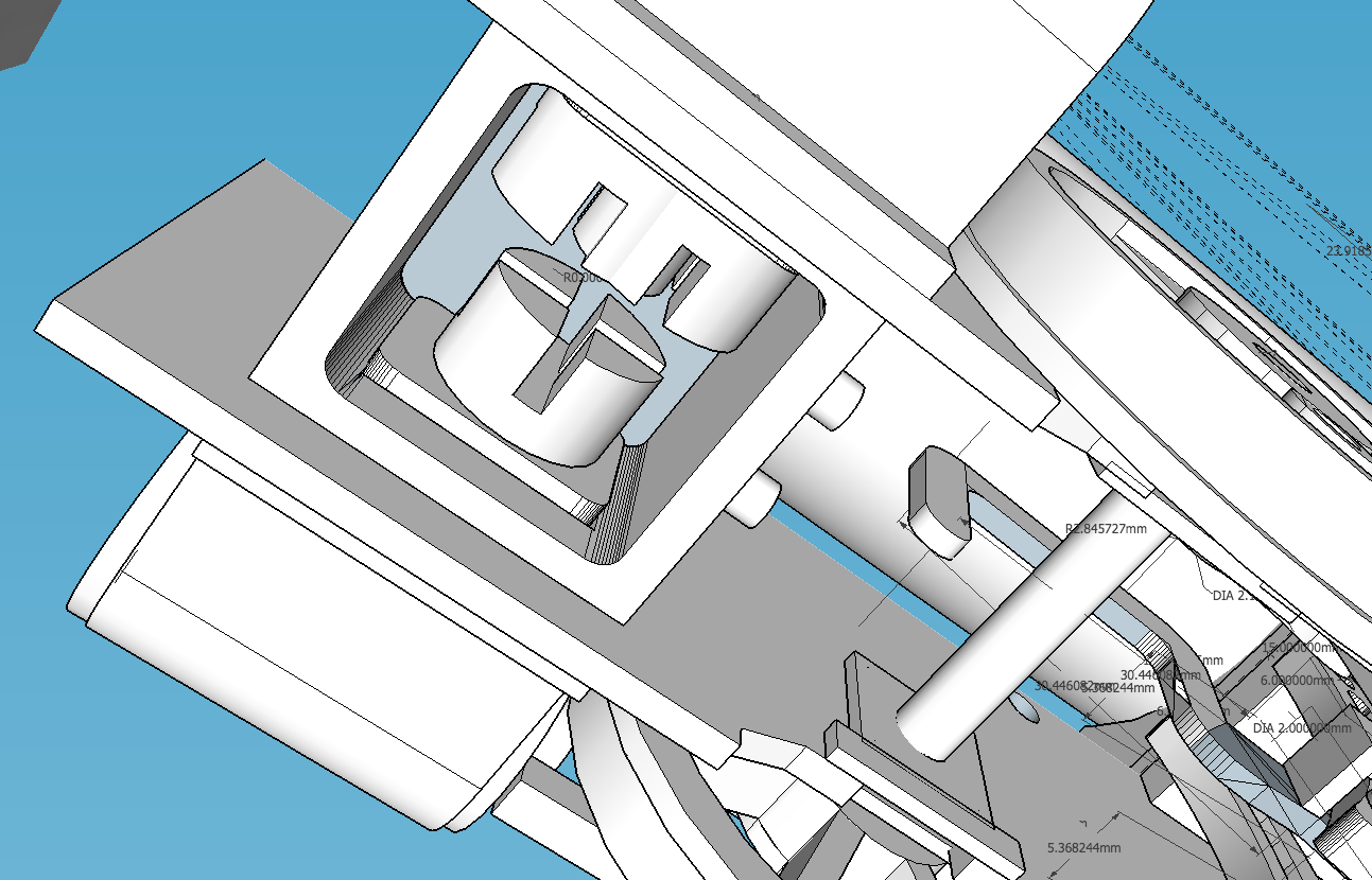

I would naturally have thought of making the frame stretchers next - so that I had something assembled to look at! However with this 2' gauge locomotive which has inside frames, outside cylinders and inside valve gear it seemed like the key component was going to be the valve chamber, which can act as the frame stretcher at the outer end of each bogie. I initially looked at the correct valve gear for this loco, which was "Gooche stationary link" motion. I tried to fit 4 eccentrics in between the frames, and realised that it would be much easier to simplify it. So one eccentric for each cylinder rocking the stationary link, and a lifting rod driving the valve. It will limit the valve timing - but I am sure it will be perfectly adequate in a model. So to show you how the cylinders and valve chest fit to the frames - in my model - the following screen shot:
Screen Shot 2022-01-21 at 09.59.49.png (207.51 KiB) Viewed 43288 times
The holes in the frames where the cylinders fit allow the valve port face, which is part of the cylinder, to poke through into the valve chamber on each side of the locomotive. This will allow me to polish the valve faces before final assembly. That requires both sides of the valve chest to have a hole in them - matching the hole in the frame. It seems to me a good idea to keep the steel frame separate from the steam - and this arrangement also allows that. It also allows for bolts to hold the cylinders, frames and valve chests together to pass through a flange above and below the cylinder, through the frame and thread into holes in the valve chamber. The screen shot has the valve chamber cover hidden, and it will cover the hole through which you can see the valves on their faces. The right hand valve is seen "double" with one at the full forward extent of its travel and the other at the full rearwards travel. The left hand valve is in mid position.

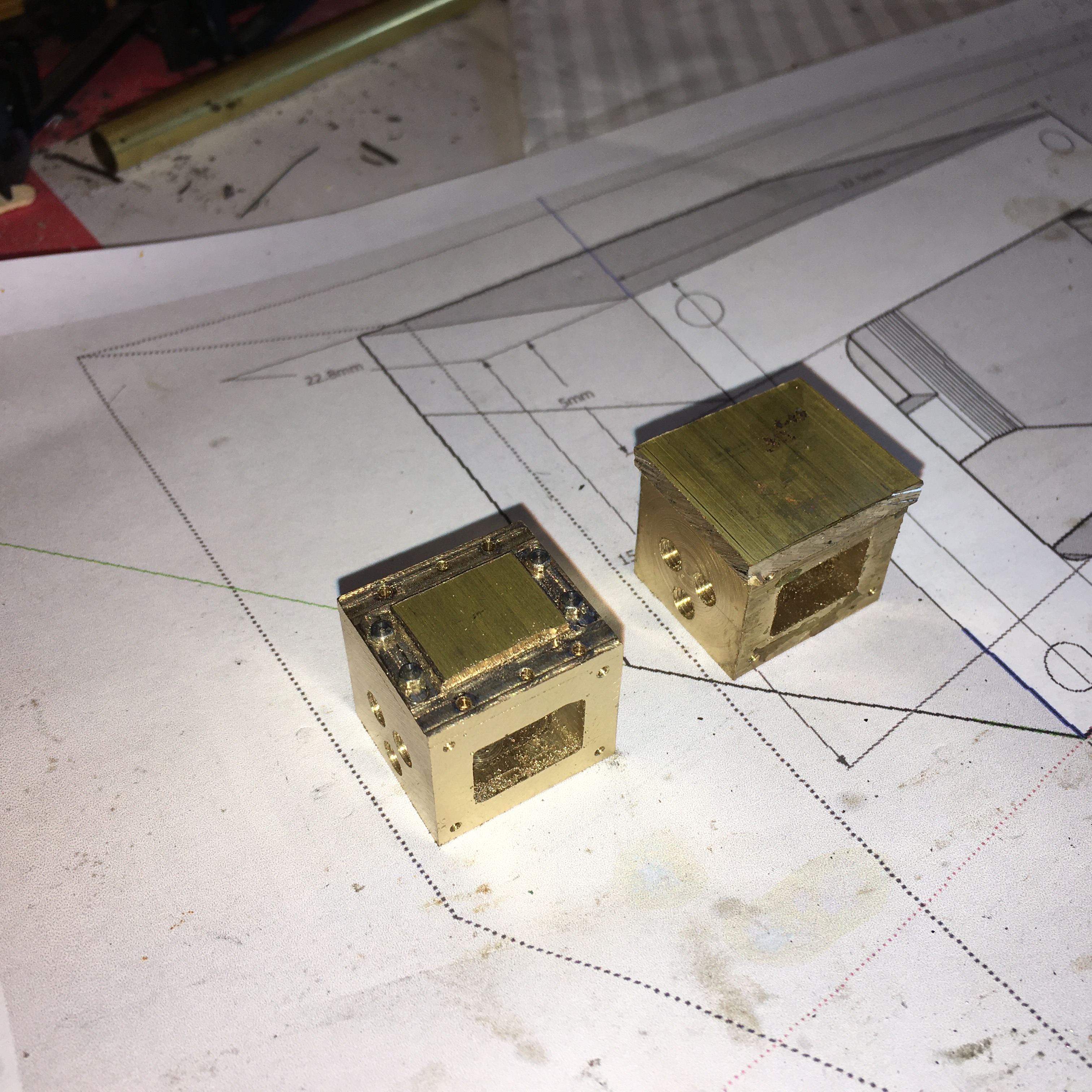

One of the problems with making a model of a complex locomotive is that there are so many duplicate components to make - 8 wheels, 4 cylinders and so on. I have learnt that it is better to make the multiple copies together, rather than coming back to make another when I have forgotten how I made the first.
So two valve chambers. It is the wrong way round to show you the end result before showing the valve chamber being made - but here it is anyway. The first is machined and has been attached to the first frame:
You can see the laying out marks on the top face. I start by scribing lines at measurements taken from the drawing, and then use a centre punch to pop marks at intervals along the lines. I particularly try to locate the corners. The idea is that when machining aim to leave half of the punch mark, and machine off half. Not my idea - but its how Bugati car components were made in the 1930's, apparently. I got the idea from a friend who made replacement parts for them.
I used locktite bearing retainer to fix the one frame in place before drilling and tapping the holes to hold it to the frame. I have now assembled the second frame using a flat surface and a set square, and bonded that in place. I will drill and tap the other set of holes later:
You can see the bolt heads sitting proud of the frame side. I plan to make pockets in the inner face of the cylinders to accommodate those bolt heads. I think it will be easier to assemble that way rather than trying to use countersunk screws. There are also holes in the frames outside the valve chest which I plan to tap and use to hold the cylinders to the frame. I failed to work out how to use one set of bolts to hold it all together! The holes in the end of the frames will take the "buffer beam" which in this case is more of a coupling mounting block, to hold the magnetic couplings that I am now standardising on.

And making the second valve chamber:
I used the lathe to shape a second bare block for the second chamber. Dimensions were copied from the first, and machining it like this in the chuck should make sure that all of the faces are truly perpendicular:
The block has had the lines marking where it has to be hollowed out scribed, and the punch marks made:
Re: Little Wonder

Milling out the first side face:
I started out by drilling right through the block with an 8mm diameter drill, and then milled the face away to a depth of 6mm. Turning it over and repeat on the other side. Then on to the bottom face where the chamber was milled out to a depth of 15mm:

I have made covers for the valve chests from 3mm thick brass plate, cutting them out oversize with a hacksaw and bonding them in place with locktite:
The left hand cover in the photo is finished, and the right hand one has just been bonded to the chamber.
Having filed it to shape it has been marked out for drilling the holes to fix it properly:
Drilled, tapped, and the holes in the lid opened out to 1.8mm. I think that 3mm is fine as a strong lid to withstand pressure, but it is too thick for 1/4inch screws to have enough thread in the brass valve chamber. So that will be sorted out next.
