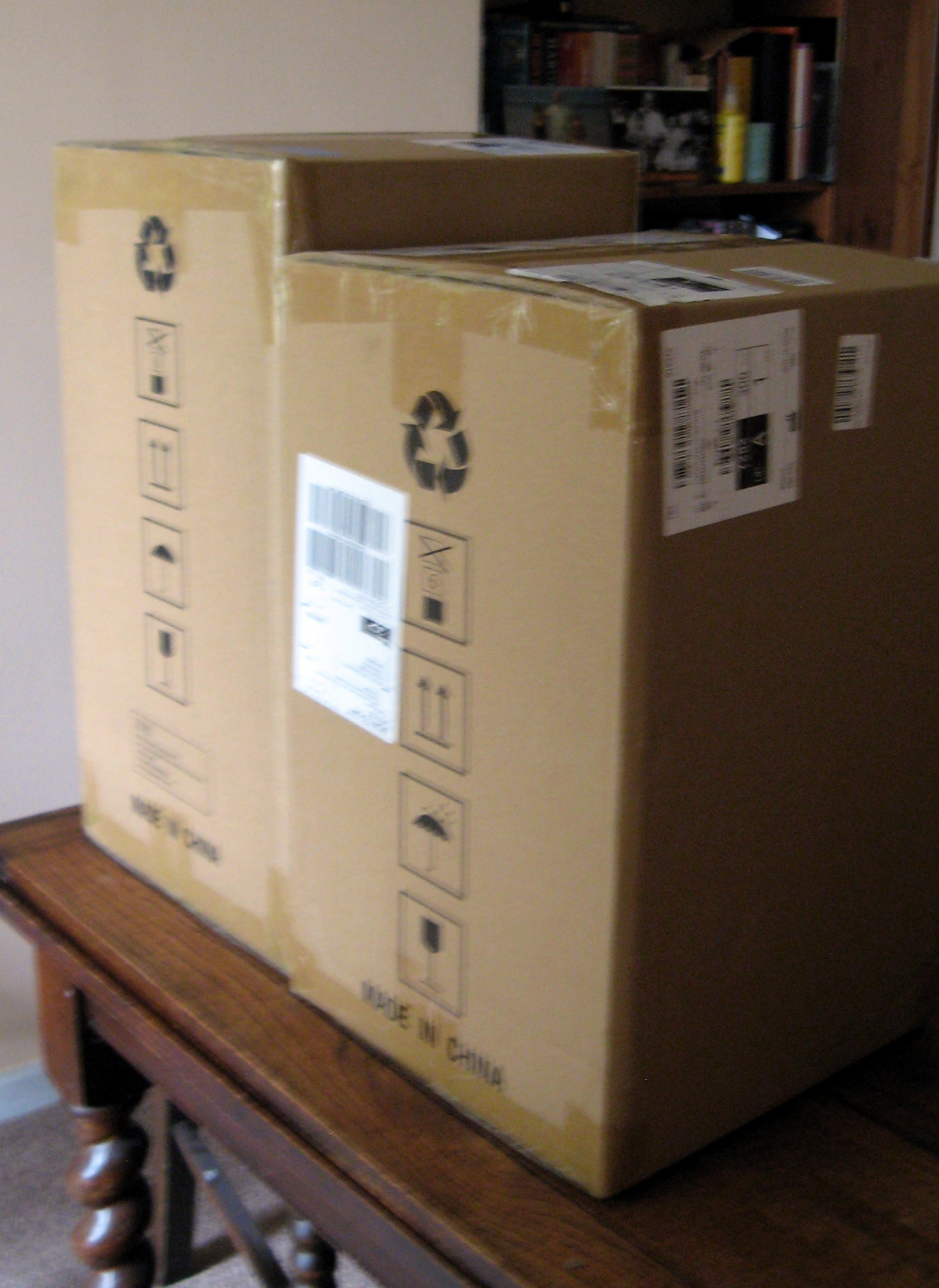

Very very quick ..... look what's just arrived.philipy wrote: Tue Oct 26, 2021 9:47 am It was a while ago but mine came from a UK warehouse, with no extra charges. Delivery was very quick.
