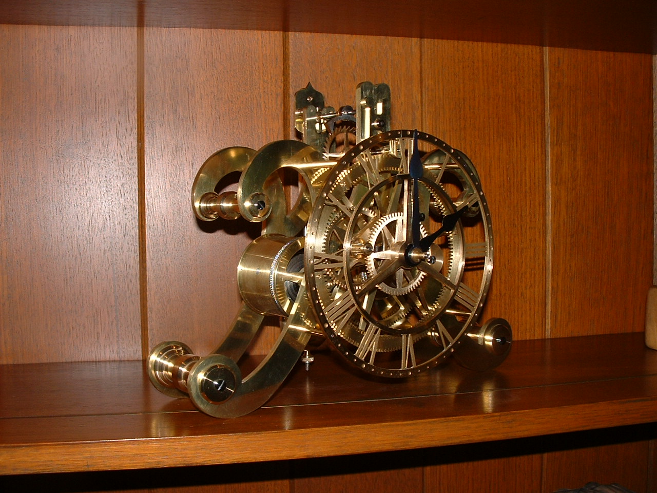

How does someone go from making these:
to these:
to steam locomotives. I don't know, but last month surfing the net I stumbled upon 16 mm Today. Now here was something I could get interested in. Not the garden railway side of it, the bucket list is already far too long, but making a steam locomotive would be a challenge. Reading through some of the back copies of SMT, a Wild Rose III appealed. I started with the frames and cylinders.
