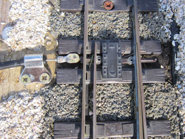

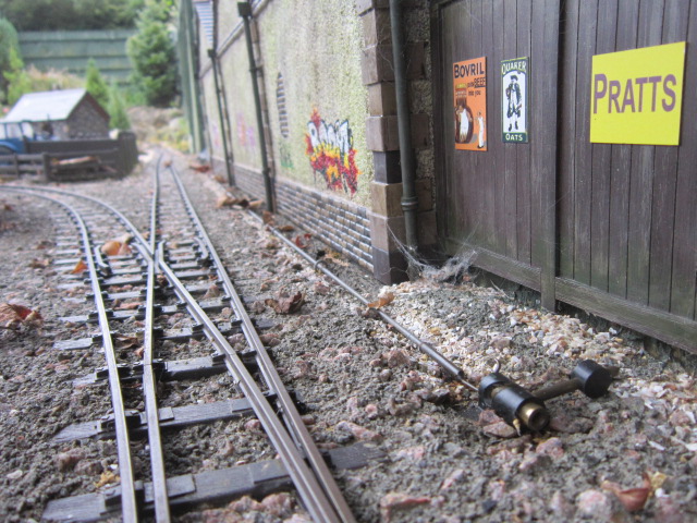

I've been playing around with a redundant reel of galvanised fencing wire and a few eyelets.
Happy with the results, I've now installed both systems for a couple of hard to reach outdoor points and the two leading to my storage sidings
https://riksrailway.blogspot.com/2021/0 ... point.html

In the second example, is the point switched by twisting the wire?
I've got a point which would really benefit from something similar, it's in a very awkward spot, but it needs a simple solution, ideally a solder-free one!

Andrew wrote: Thu Jun 03, 2021 12:16 pm I like the look of that!
Yep! The wire flexes a bit but is still effective. Seems to work ok for runs up to two foot.
