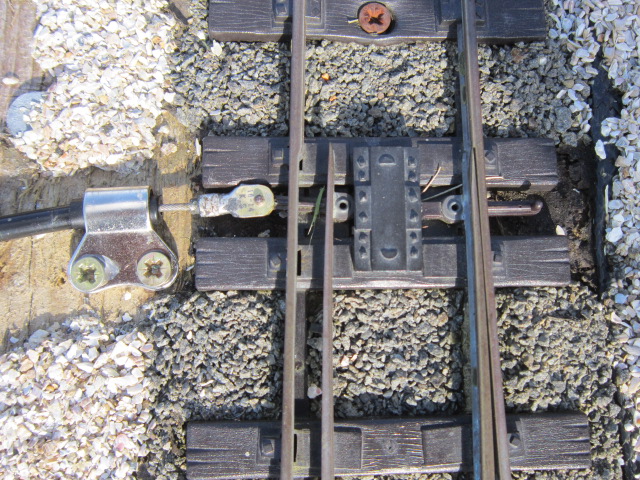

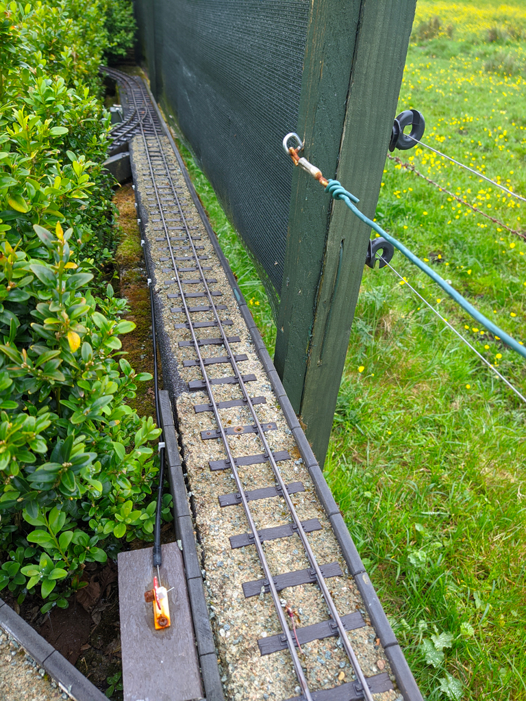

I've been playing around with a redundant reel of galvanised fencing wire and a few eyelets.
Happy with the results, I've now installed both systems for a couple of hard to reach outdoor points and the two leading to my storage sidings
https://riksrailway.blogspot.com/2021/0 ... point.html

In the second example, is the point switched by twisting the wire?
I've got a point which would really benefit from something similar, it's in a very awkward spot, but it needs a simple solution, ideally a solder-free one!

Andrew wrote: Thu Jun 03, 2021 12:16 pm I like the look of that!
Yep! The wire flexes a bit but is still effective. Seems to work ok for runs up to two foot.

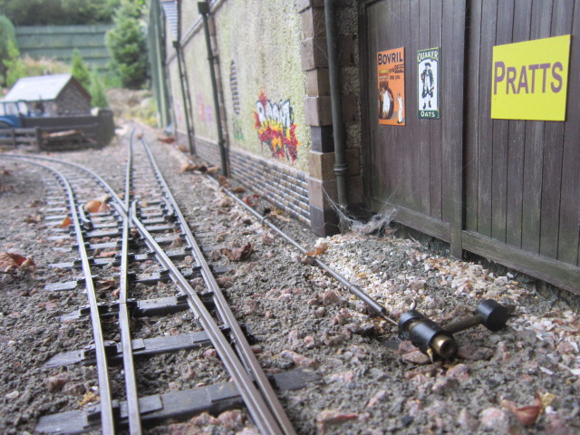

Just carrying on from your post - I have only 2 points with 'remote' hand control, both via bowden tubes - one a model aircraft ptfe 'wire'/plastic tube
and the second a bike brake cable housing, with stainless steel wire replacing the brake cable.
Both are connected to Cliff Barker point levers, which have an adjustment to change the throw from 6 to 8 mm. These are really nice point levers, but the tubes/capstans etc. were both a complete faff to set up - I do wish I'd gone down your route now :roll:

I have two points operated by bicycle brake cable in tube, one quite short, about 2 ft. the other at least 3m. in length. They have been in operation for some years now and work faultlessly. There is so little friction that a train can trail its way through without any problem......
Another point is operated using brass rod running through screw eyes operating a crank, similar to that shown above, every year it has to be de-rusted, cleared of moss etc, oiled and nursed back into working order...... nightmare!!!!!
I will change that to brake cable as soon as possible.
