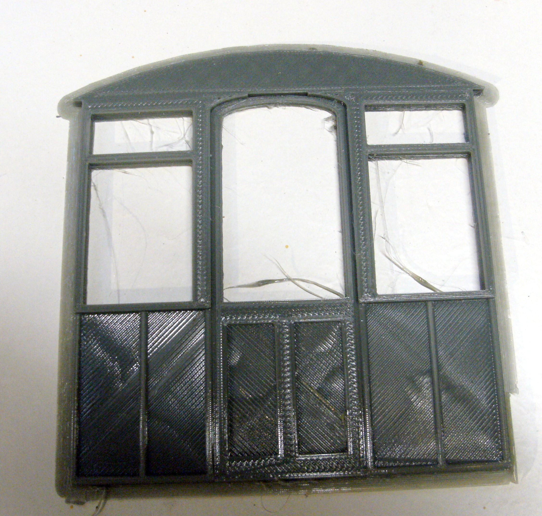

OK - so, I'm still getting to grips with PETG.
The test pieces actually worked out better than the more recent 'proper' pieces. The default temperature for PETG in Cura (210C) was less than the temperature recommended on the spool (220-240) so I upped it to 225 thinking this would improve the quality of the printing.
In actual fact, this seems to have exacerbated the problems of stringing and blobbing which were much less apparent on the test pieces
I tried using 'ironing' to improve the smoothness of finish on the final layer but it looks like I'll need to reduce the temperature as well Higher temperatures (and minimal fan speeds) are recommended to ensure good adhesion between layers. It seems to have worked on the roof section which was printed vertically, but as you can see there's a lot of stringing.
Bed adhesion is not a problem. In fact, it's suggested that Pritt stick is used, not to enhance adhesion but to help with the removal of parts from the glass print bed. The printhead keeps getting smothered in filament - I'm told PETG is more like glue than plastic filament so I might invest in a silicone cover for the printhead.
I'll persevere with PETG (I've got two spools to work through) but I'm already beginning to miss the relative simplicity of PLA. Another issue associated with PETG is that it is hygroscopic, which means that once it's unwrapped, the spool will gradually absorb moisture from the atmosphere which adversely affects its ability to print reliably. It can be dried out in the oven (on a low heat) but it's beginning to feel like PETG is more trouble than it's worth!

- Posts: 6045
Re: PETG or not PETG?
All very interesting Rik. Please keep us updated as you experiment further.

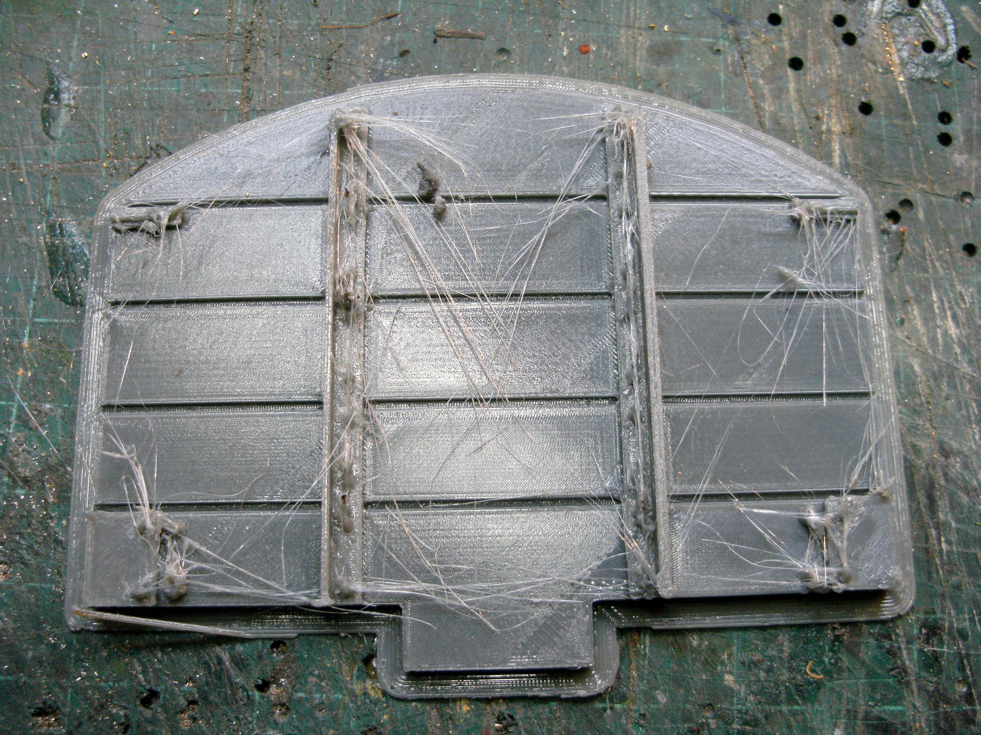

- Posts: 7992
Gradually getting to grips with PETG. I keep tweaking the settings. The greatest problem seems to be overcoming stringing.
It's surprising what a difference dropping the print temperature by 5 degrees makes
I'm now working on the retraction settings to see if I can get an even neater finish.
PS - Dropping the temperature by too much leads to blobs - so it seems to be quite a fine window to aim for

- Posts: 6045
Full marks for perseverance Rik.
Both of those look OK-ish but still a lot of cleaning up needed, not sure it is giving overall better results than PLA though?

Nickclarke
- Posts: 13
- Joined: Fri Jun 11, 2021 12:07 pm
A hairdryer on hot or very careful use of a heat gun gets shot of all the hairy bits, you could try printing a temperature tower to get ideal heat setting...
- Posts: 7992
Thanks Nick. I'll give it a try.Nickclarke wrote: Mon Aug 23, 2021 2:59 pm A hairdryer on hot or very careful use of a heat gun gets shot of all the hairy bits, you could try printing a temperature tower to get ideal heat setting...

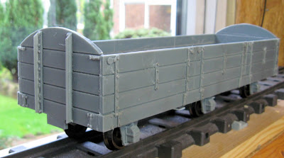

- Posts: 7992
I've now finished my first complete model with PETG. It's taken a while, firstly because I've been busy with non railway related projects (and socialising) and secondly because it took me quite a while to experiment with adhesives and solvents.
Here are my conclusions so far:
Bed Adhesion
PETG sticks to the print bed like the proverbial to a blanket. I use a layer of Pritt on the bed, not to help with adhesion but to help with the removal of parts. I coated the bed with a thin layer of Pritt several weeks ago and haven't needed to replace or add to it.
Stringing
I've reduced stringing by lowering the print temperature and reducing the fan speed while printing, but I've not eliminated it. As a consequence, finer details like rivet and bolt heads tend to get gummed up and even with Nick's tip about the hot air gun, are tricky to clean up.
Joining parts
As indicated above, I really struggled to join parts together. Superglue didn't! PVC Pipe Weld worked OK when the two large surfaces were joined but was useless with parts with a small surface area. Revell plastic glue didn't make any impression but eventually, I discovered Plastic Weld (Methylene Chloride / Dichloromethane) worked, but it takes a while to harden off and so increases construction time quite markedly compared with PLA and thick Superglue.
I've not yet tried painting this model, but some previous test pieces seem to accept paint quite well.
I don't have problems with excessive sunny temperatures (yet) in this part of the UK and I've been reassured that the biodegradation of PLA won't be an issue (certainly in my lifetime), so I'm not yet convinced that PETG will replace PLA as my filament of choice. Unless, of course, I make a major breakthrough with stringing and joining parts.
Bed Adhesion
Stringing
Joining parts
- Posts: 6045
Thanks for the update Rik. I've always doubted that PETG would be worth the extra hassle, and atm you seem to be confirming my suspicions.
Having said that, the wagon looks pretty good overall.
