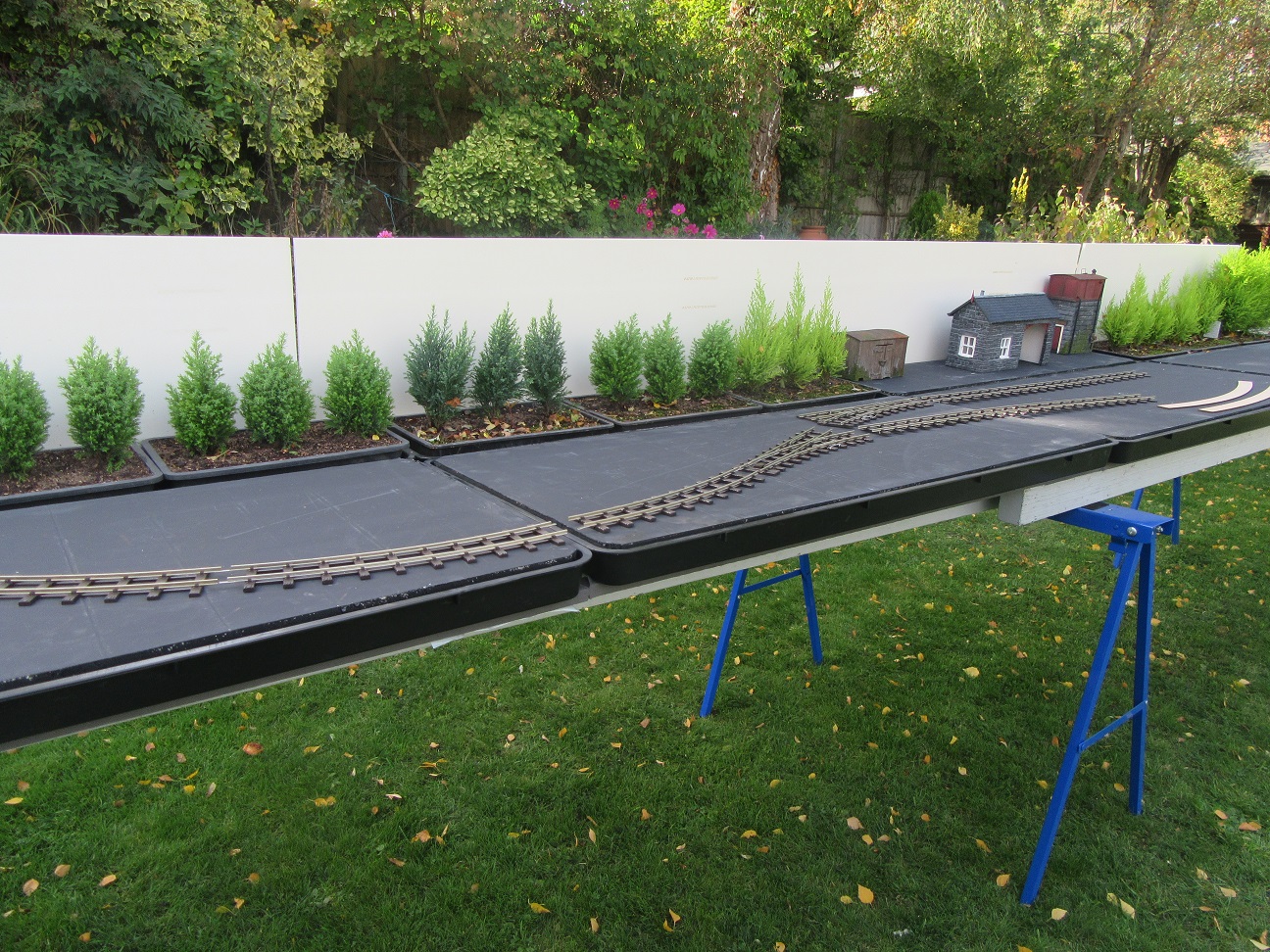

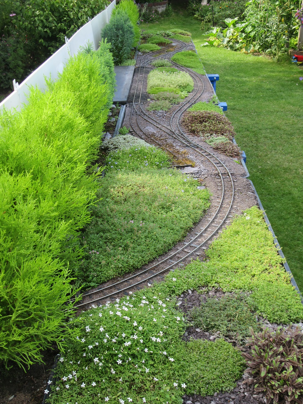

After 5 years and 30+ exhibitions it was time to think about a replacement for my 'G' scale 45mm gauge Hambleden Valley layout. It had to be something different. Hambleden was unique in using radio controlled live steam locos on an end to end layout involving lots of shunting of rolling stock. So this time it had to be a 'round and round'. However it also had to be different from the usual offering of unballasted track, a nod to scenery and out of the box rolling stock.
The new layout, called Pen-Y-bont, is 16mm scale on 32mm gauge track and based in Welsh slate territory. The unique feature this time is that all the scenery is made with real plants, growing in soil and it would be left outside all year, except when dismantled and transported to model railway exhibitions in the back of my van.
It's still work in progress but here's an early photo of test setup in the garden

Re: Pen-Y-Bont A new portable garden layout
The image has not appeared ?

- IMG_3141r25.jpg (843.61 KiB) Viewed 20201 times
- Posts: 6050
Looks fabulous. I hope you have good muscles, if not you soon will have, shifting that lot in and out of exhibitions!

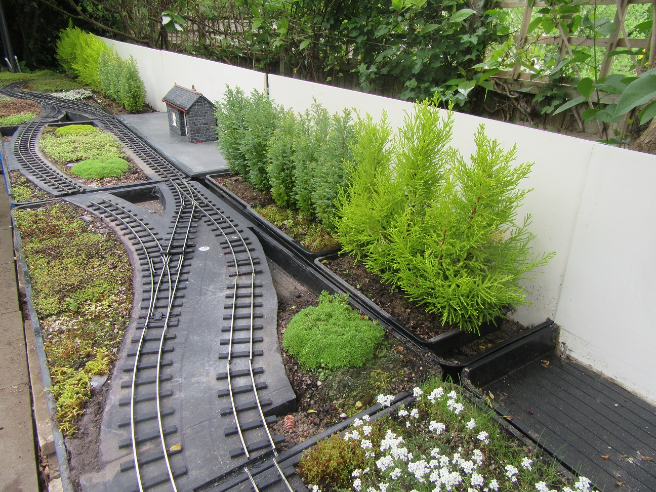

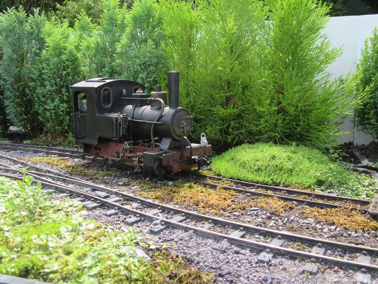

Billy re-gauged from 45mm to 32mm waits next turn of duty
https://gardenrails.org/forum/download/ ... w&id=13927
- Attachments
- IMG_3162r25.jpg (794.91 KiB) Viewed 20188 times
- -steves-
- Posts: 2473
Looks brilliant, but as Philip said, a lot of hard work to shift about, but worth it as it's quite spectacular for a portable layout.

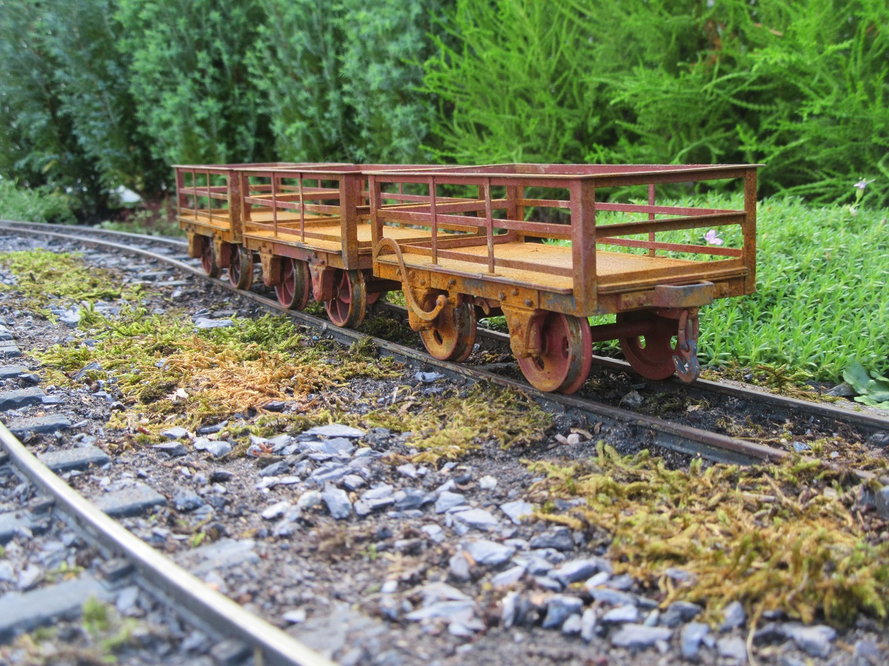

I am sure it will attract a lot of attention if and when we ever get to exhibitions. I am hoping to be ready for 2022 but I have a lot of new stock to build because of my change in gauge.
Here's a first batch of Slaters etched brass slate wagons suitably weathered as I hate pristine stock.
https://gardenrails.org/forum/download/ ... w&id=13928

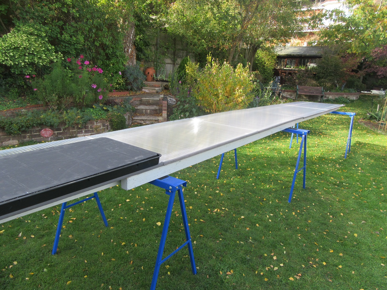

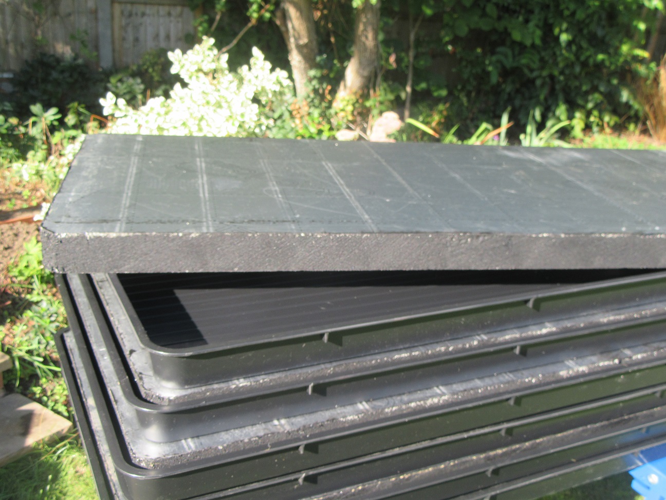

OK Due to the design brief, no wood could be used in the baseboard construction. So like Hambleden, the starting point was polycarbonate roofing sheets to which was bolted 2in deep plastic plant trays. These were fitted with 2in expanded foam insulation sheets painted matt black as a base for the track and to keep weight down as much as possible.
https://gardenrails.org/forum/download/ ... w&id=13929
https://gardenrails.org/forum/download/ ... b09960423c
Once the track was in place, the rest of the foam was cut away to make pockets for the plants,

A couple more pictures under construction before I get to the detail of planting and rolling stock. more to follow.................
https://gardenrails.org/forum/download/ ... w&id=13933

steveh99
- Posts: 92
- Joined: Tue Jan 31, 2017 5:06 pm

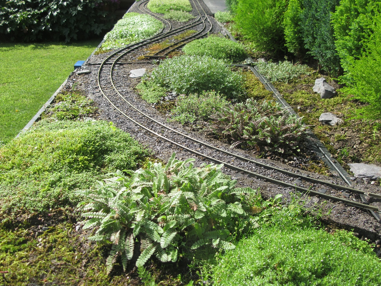

- Location: Oxfordshire
the weight is no too bad. the bare 'baseboards' and the track base are all lightweight plastic. The only soil is between the tracks and is 2in deep or less so the weight is not really a problem. Just need to keep the boards level whilst transporting hence the need for two people. I have dismantled and set it up several times with no problems. At the moment, it is set up on staging in the garden and been left to over-winter. The plants have spread well and are now covering up the joins. I will need to cut along the joins with scissors before attempting to move it again.
You're right, the scene changes with the seasons, In the summer it is a riot of colour, but right now its all green and mosses so depending which month the exhibition is, will determine the look of the layout. It will probably never look the same at any two exhibitions.
https://gardenrails.org/forum/download/ ... w&id=13935
