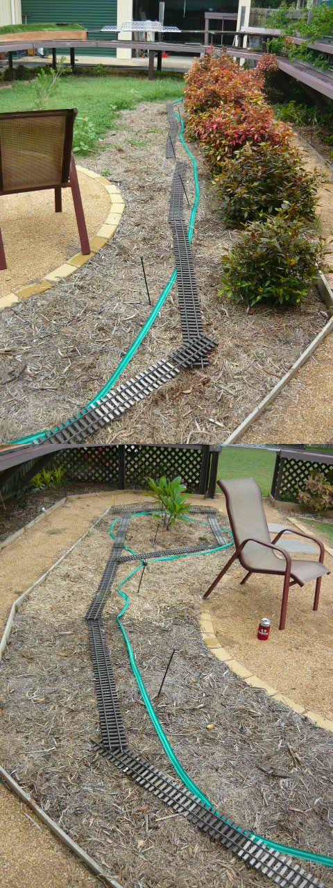

It will be stand alone with a line that will connect it to the main layout(interchange); both will be at the same height.gregh wrote: Tue Feb 09, 2021 7:58 am I don't quite follow the idea. Will this be totally stand alone and not connected to your main, raised line?
The track at the moment is "roughed in" to get an idea of where I can run the "farms" line and how many posts I will need.
I was originally planning on making a peninsula for the sugar mill area but that put some of the tracks out of reach if there was a derailment. So I have come up with the idea of having the mill on an island so I can walk around it.
In real life cane lines and the mainlines never connect to each other because of the different guages, cane 2ft main in QLD 3ft 6 inches, the mainlines do run spurs into the mills to load the bulk raw sugar this is the logic behind the plan. I will run a spur into the mill from the mainline via a drop down bridge.
The end loop of the "farms run" will have a Y point that has no centering so a loco can push the blade to change it. I used this idea with 2 points at each end of the line when I first started in Bomaderry. The way it worked was a train entered on the LH leg and exited on the RH leg changing the point; the next train will enteron the RH leg and exit on the LH leg and so on, each alternate train travels around the loop in opposite directions.
So I can have a train running around the loop do some shunting collecting the bulk sugar.

This is a basic idea of what will be built at the mill end (green hose gives some indication of track layout), with an extra loop outside for the interchange; I have 2 LGB 3 Way points that are just asking for a job.
The interchange bridge could get more complicated because of it being on the outer loop.
Consultation with the local population about land usage was involved.
I don't think I mentioned that the track I an using for the cane railway is "Code 250" as opposed to the Code 332 for the mainline.
