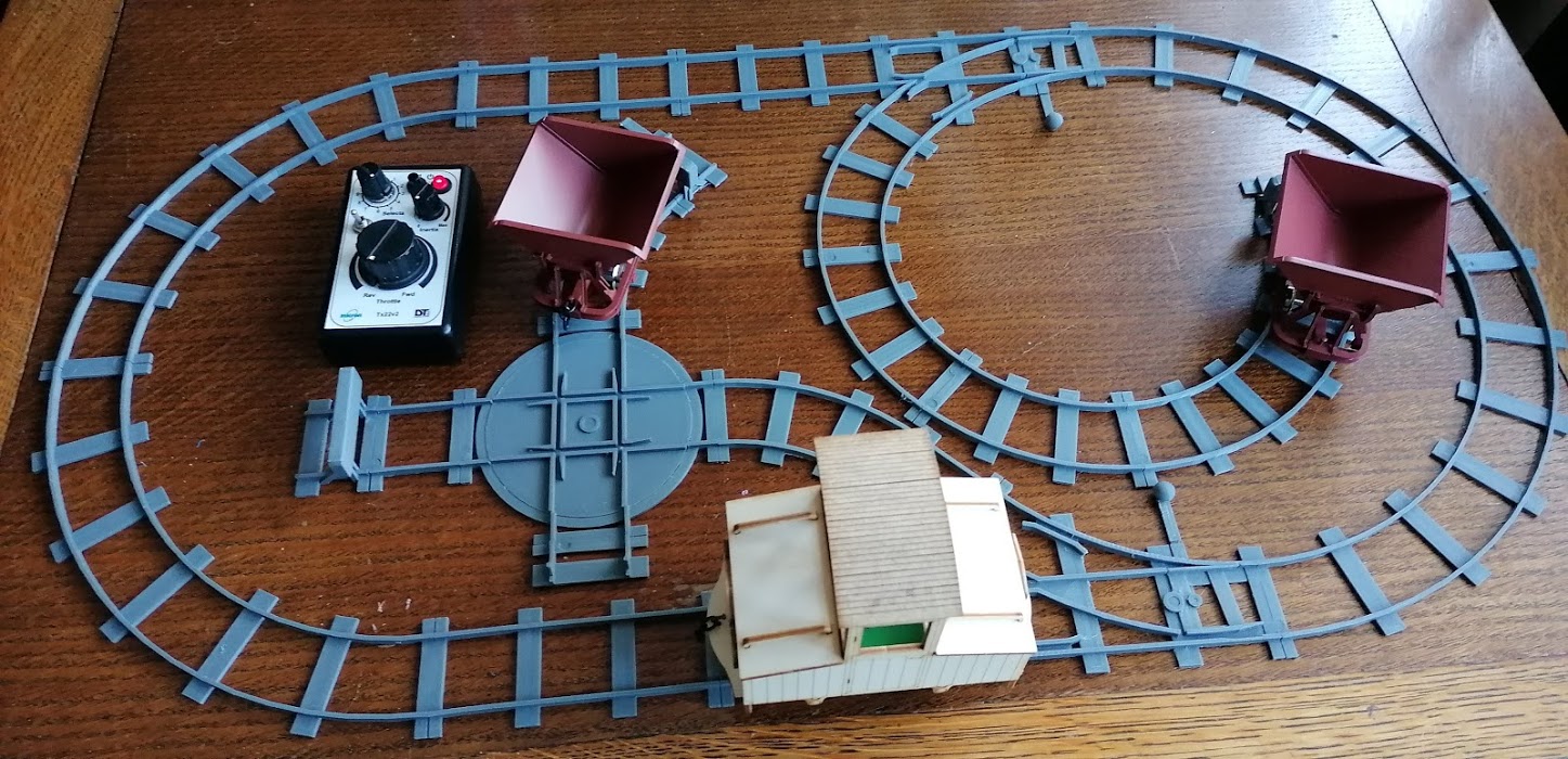

I thought I would download and try the loco remote track, I didn't get on with their controller in the slightest little bit, shame as a great idea. Anyway, their free downloadable track is quite superb for small wheelbase 4 wheel drive loco's. I put this together today, it's not finished as I am yet to print the buffer stops. Neat for anyone not wanting to go outside in freezing temperatures. NOT recommended for steam I wouldn't think, lol :shock:
I have yet to print the rest of the turntable too, awesome :thumbup:
Total measurement of layout is approx 25" x 16", the outer radius is around 8" and inner radius is around 6", not really for the larger ones in the fleet, lol :lol:

Now that looks intriguing.

ge_rik wrote: Thu Dec 31, 2020 6:02 pm Now that looks intriguing.
Yes indeed. :D
I think for the sake of a few quid on PLA, it's a good test track without going outside in the cold. Only thing I had to do is there is a sharp corner on the inside of both points which it kept riding up on, out with the scalpel and get rid of it so it runs along it rather than up it. :thumbup:

SimonWood wrote: Fri Jan 01, 2021 12:07 pm I have printed some of this, it's a really clever design. Had a bit of trouble with derailments on the point though - doesn't look like you've had any such problem? I'm not sure if it's down to the issues with the accuracy of my printer...
I said above somewhere, but I had to get a knife to both sets of points as there is a sharp angle where it derails when going on the curve of the point. You just need to nick the angle off and make it smooth. After that, it's fine, I doubt it's the printer and would guess it's the design as both of the sets I printed do it too. Just push a small wagon round it and see where it lifts off the track and get rid of that sharp angle :thumbup:

Seriously, I'm not sure if I may have the answer to the 'sharp bit that needs to be cut off" the point. As downloaded, the point was a bit of a tight fit on my printer bed and to make it easier I imported the stl into Sketchup so that I could move the two small pieces to a more conducive position. That was no problem, but SU always adds loads of extraneous lines when importing an stl. They don't affect the subsequent print but look messy so I usually get rid of as many as I can. In doing that I found a couple of defects in the actual drawing, with two sharp edges that need to be deleted to allow the switch rails to sit neatly against the stock rails.
The other thing I have found is that the mating nobbles don't sit properly into the matching holes. Not a big deal but I suspect that it is a manifestation of the print shrinkage issue we were discussing recently.

philipy wrote: Fri Jan 01, 2021 2:36 pm In doing that I found a couple of defects in the actual drawing, with two sharp edges that need to be deleted to allow the switch rails to sit neatly against the stock rails.
I found those sharp edges after printing - and deleted them. With a file!
Yes, this track was the main thing that brought the 'shrinkage' to my attention, so it sounds like you are experiencing the same thing I did...!
