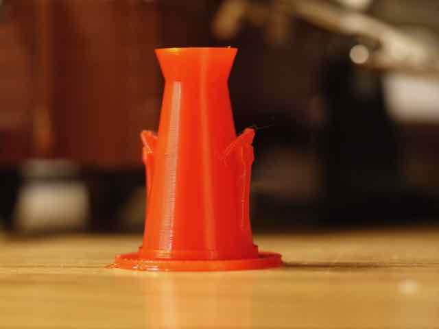

So I’m a complete newbie to 3D printing (though I’ve done a little 3D modelling in the past to create images or animations) and I have little to contribute by way of expertise… though I’m certainly soaking some up in the other threads here.
But what I can do is offer a few observations from the perspective of a beginner on getting garden railway stuff out of the particular printer I’ve bought - a Flashforge Adventurer 3. Incidentally this is the same printer Trevor has… although not incidentally really, since the instant I decided to buy one was more or less the moment I saw it in his workshop along with the very fine models he has produced with it! But it also suits my needs rather well: it is considerably pricier than the cheapest printers you can get now but it requires very little configuring to get going - and since work-wise I’m in the fortunate position to be about to start something that will help me afford it, while leaving me with even less time to spare - it fits the bill for what I’m after right now!
Trevor's threads show what amazing things the machine can do in the hands of an accomplished modeller. But how easy is it to get started, in terms of just printing something? I was quite astonished: I got it out out of the box - plugged it in, load the supplied filament, and pressed a couple of buttons and within minutes it had started printing its built-in test print called “20mm cube”. You can probably guess what it looks like…
To print something a bit more interesting, I needed it to talk to my computer (which can talk to the internet and hence the Thingiverse…) This requires a few more button presses on the printer menu to get it on the wifi (taking note of the IP address) and downloading and installing Flashprint on the laptop (and inputting that IP address). Then I downloaded -steves- milk churn from Thingiverse imported into Flashprint, which is slicing software for taking 3D (virtual) models and converting them for the printer. Again it’s literally a couple of clicks to set things up and then hit ‘send’ and the printer starts warming up to print…

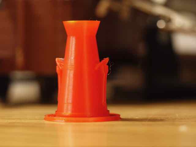

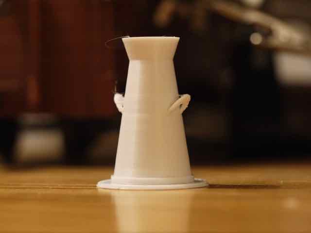

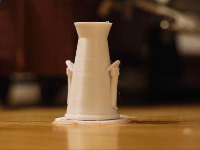

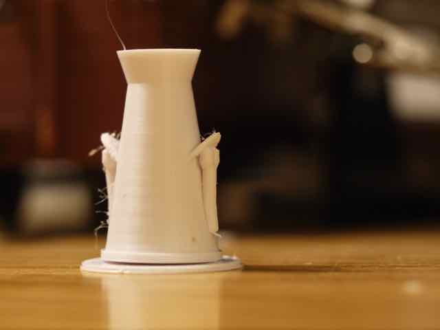

I printed the churn out several times with different settings to try to get a sense of the printer and what difference these made - standard resolution vs high (or even ‘hyper’), with/without supports, different types of filament (PLA/ABS). Fortunately they were all usable (as I need some milk churns!) though with noticeable minor differences. Probably too minor to photograph well until I put some primer on them, but anyway, here’s what they look like straight out of the printer:
Standard resolution (PLA layer height 0.18mm) - print time 40 minutes
Hyper resolution (PLA layer height 0.08mm) - print time 1 hour 57 minutes
Standard resolution (ABS layer height 0.18mm) - print time 47 minutes
High resolution (ABS layer height 0.12mm) - print time 1 hour 39
High resolution (ABS) no supports

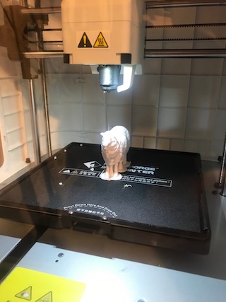

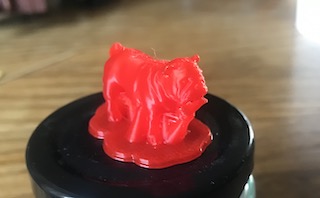

As you can see, I wasn't able to resist downloading some livestock from Thingiverse...
Still no CAD work required, just a bit of scaling to make things suitable for 1:19. (Hence my Google history mainly now being queries like "how tall is a chicken?"...)
The white ABS is the perfect colour for a sheep...

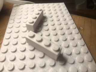

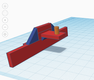

I've been working on a 'lego wagon' for my sister's children. I bought them the Tesco trainset last Christmas in a not-so-subtle effort to get them into garden railways (I'm just waiting for them to persuade my sister we should build a line in their garden) with a couple of open coaches for Playmobile people made from The Works boxes. I thought I'd make them flatbed wagons this Christmas, with a Lego top, so they could build their own superstructure. So I've been playing with Lego from Thingiverse, which has lead me into discovering parametric 3D designs and downloading OpenSCAD... and also into doing a little bit of designing of my own in TinkerCAD in order to create buffer beams with Tesco-compatible couplings.
Screenshot 2020-12-15 at 18.06.09.png (118.13 KiB) Viewed 18768 times
TinkerCAD I am hugely impressed with. It has an extraordinarily well designed interface - I'm used to 3D drawing packages having a steep learning curve, but this is a remarkable piece of software which has clearly not just been through many iterations of user testing but some very focused development. It's incredibly quick to get going and produce something I can throw at the slicer and get printing. I will say I did buy a cheap graphics tablet at the same time as the printer, as I find doing these things with a mouse virtually impossible (hats off to those who manage it) but even so it really has a low threshold for actually producing something! Just as well, as I need to get these wagons sorted before the last post goes...

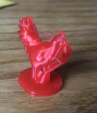

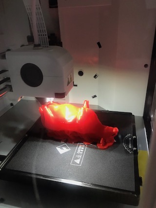

Meanwhile I've moved on from printing livestock to people... When Trevor's 4415 driver came through, I was already printing my first human, and a knight of the realm no less.
But can you guess which one?
"Great men are forged in fire. It is the privilege of lesser men to light the flame."
Then I threw Trevor's pre-sliced driver at the printer. In this case I did break off most of the supports before I put him in the cab of 4415, but otherwise he is as-printed.
Look at the fingers!
There are several hairy filament bits that need tidying up, but that shouldn't prove tricky.
