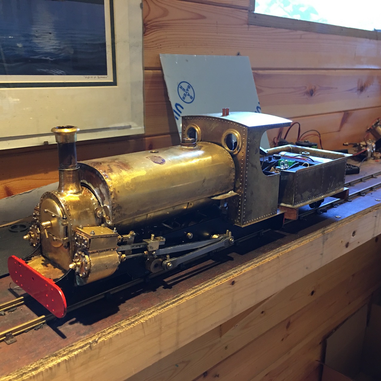

I have been building this for about 18 months.
It is based on drawings which Keith Bucklitch kindly placed on the steam model builders group files. While the original design was for slip eccentric he also provided a drawing for Stephenson valve gear - and that was why I built it. I couldn't get the valve gear to work as drawn - but I have now got it working after making some modifications.:

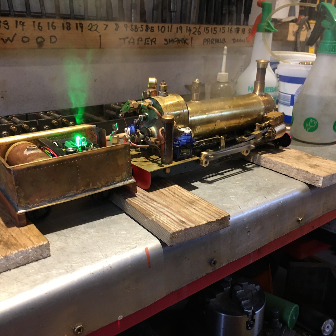

The red and green lights are the electronic water gauge which so far seems far superior to the usual glass water gauge.
and finally a link to video of its first test run in the workshop:
https://www.dropbox.com/s/kzn4y7leac3bj ... 9.m4v?dl=0
It isn't finished but getting it to run feels like a major milestone!

The electronic water gauge is in the files section of the steam loco builders website. I have a cover to go over the tender which will have coal stuck on it. That should tone down the red and green lights ( which I plan to be visible between the lumps of coal. They have to be bright apparently to be seen in bright sunlight. The flashing is quite interesting - it is caused by the water in the boiler surging back and for as the loco moves. I find it quite reassuring to see that there is actually water sloshing about. The 3 d printed inserts in the tender are described in my thread on 3 d printing for 16mm garden railways in the general section.

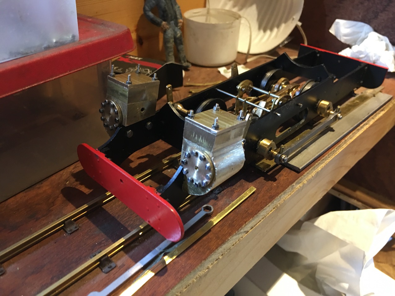

As for the stephenson valve gear. Someone on the steam model construction group asked about stephenson valve gear - and Keith responded with a drawing. You would have to search for that to see what was described etc.
As to what I changed - well I changed most of it really. I could not get it to work as drawn so I went back to the books and simulators I have for valve gear design. The first thing I learnt was that the Stephenson valve gear has to be robustly built and well supported against sideways movement. Secondly I had to adjust the dimensions to get sufficient valve travel. And recently I had to dismantle quite a bit to get at the cranks and pivots which transmit the valve motion from inside to outside. I was losing the valve settings - because the arms were moving on the shafts. I have now pinned all four of these joints with 0.9mm brass wire.
The video was its first run - and it was going a bit fast for my taste. However now it has had a few runs I am able to control it better and it is running nice and slowly - and I won't need any form of flywheel device. The only issue left is that the valve gear is a bit stiff going from ahead to astern, and I am sure that will run in in time.
A photo of the underneath to show the valve gear. If I was making this again I would suspend the expansion links from both sides - its stiffer that way. And I used the valve cam followers in the slip eccentric drawings. I wouldn't do that again - I would make split ones like car connecting rods in future.

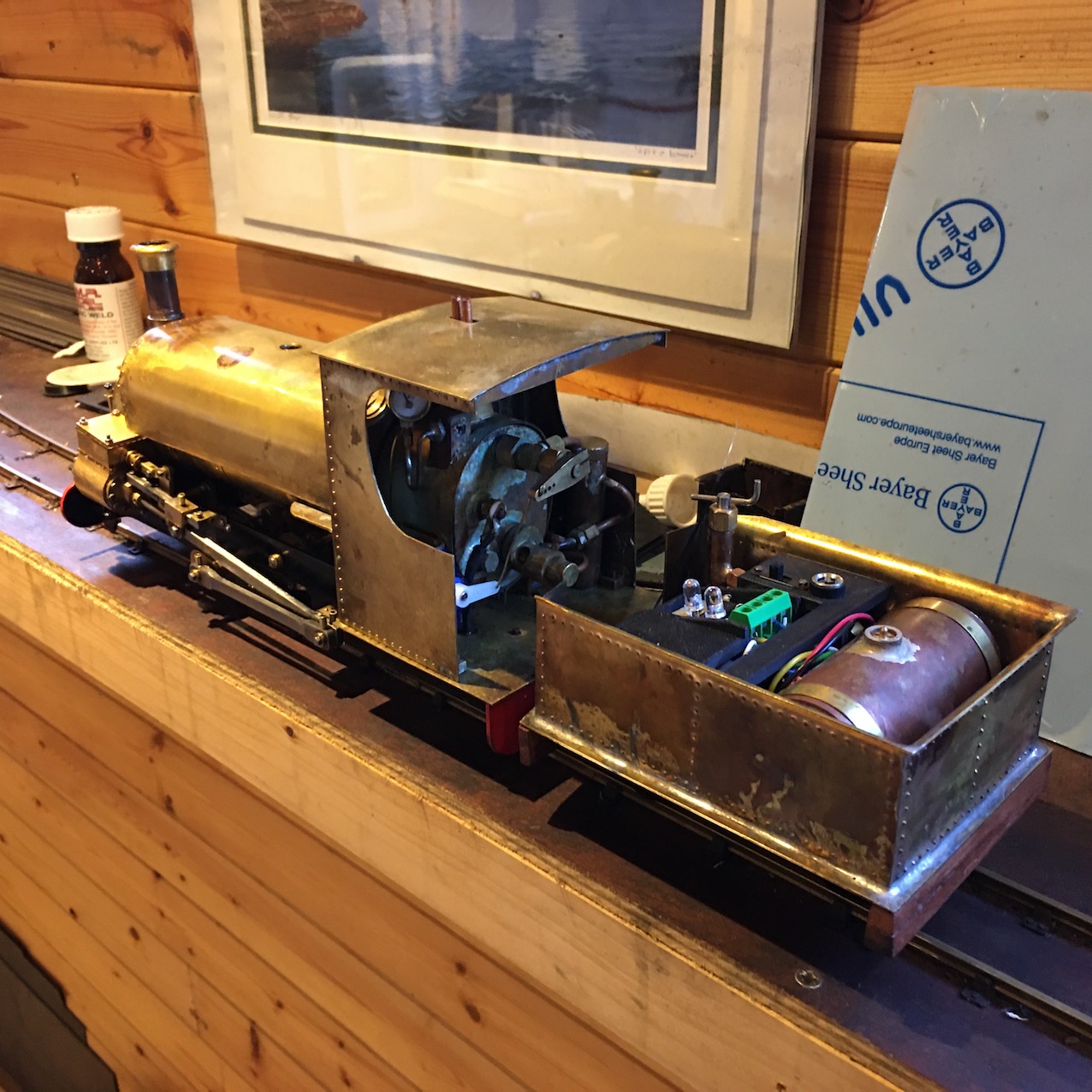

And photos of the loco as it is at the moment:
