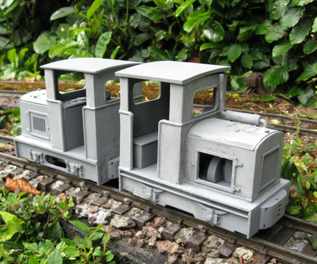

The latest project ..... a 3D printed diesel loco (x2)
I thought I would try something a bit more ambitious with the printer. The model was downloaded for free from Thingiverse and then the parts printed out an assembled. I wasn't entirely happy with the first print (I discovered the X and Y axes weren't perpendicular), so I printed out a second one. I then decided the slightly wonky first one was OK and so will run them back to back (as per Australian sugar cane railways) - one powered and the other a trailer (for now).
So far each loco has cost around £3.00 in plastic, wheels - £9.00 (IP Engineering), brass bearings - £1.20 (G-Bits) and then the motor and gears for the powered loco - £12.00 (IP Engineering) plus 2 x li-ion AA - £8.00 (Ecolux) and a Deltang receiver/controller - £40 (RC Trains)
Total = £86.40
Many thanks to Ivan at IP Engineering. While fitting the gears, the insulating bush in one of the wheels shot off across the room and disappeared into that void where all small screws and washers end up. I contacted Ivan for a replacement and four bushes with wheels arrived FOC. Excellent service!!

They look really good together Rik and the printing looks tidy too. When I first read the title of your thread I expected to see the two conjoined, Fairlie style!

Who's got the bug then??? :lol: :lol: :lol: :lol:
Well done though, I've looked at that on Thingiverse several times, including literally 2 or 3 nights ago.

You'll notice that there are slight differences between the two locos. One is the original and the other uses additional / replacement parts which a fellow modeller added. That's one of the things I really like about 3d printers: the willingness to share ideas and resources. Just like Garden Railway modellers!

That’s really neat. 3D print has to be the way to go, I guess. Hmmm...

Great work Rik, you've certainly grabbed this 3D printing with both hands.

Great looking brace of locos Rik.
I still reckon they should be nose-to-nose not cab-to-cab. I guess that in Queensland they would get better cooling airflow with one loco's radiator at the front. But heat shouldn't be a problem on the PLR surely. :?

I'll give it a try to see what it looks like
