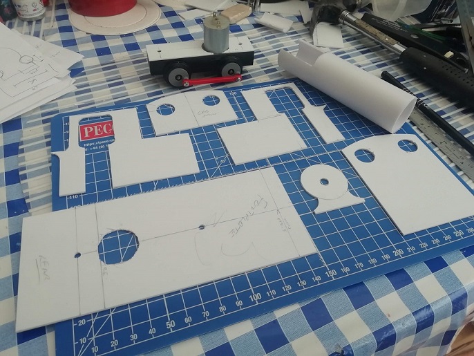

Hi folks, first of all thanks for this great resource. As a lockdown project, I have been putting together a PDF models 3D printed Fowler Peldon kit. It whetted my apetite to try something a bit more ambitious - building my own loco from scratch. I've never tried this before, but I was inspired to do so by Rik's Peckforton Light Railway blog, where he details in a pretty much step-by-step way, his process for scratchbuilding steam outline locos (if you are reading this, Rik, thanks very much!).
My loco will be based (loosely!) on the Bagnall 2-4-0 locos that ran on the Rye and Camber Tramway. My reasons for choosing these locos were:
- They look relatively easy to build
- They were very small, and most photos show them pulling only 1 or 2 coaches, meaning I could use a cheap budget chassis and it wouldn't matter if it cannot pull much.
- I just love the way they look - idisoyncratic and almost like a toy engine.
Mine isn't based on either of the Rye and Camber locos in particular. The idea is to make something that Bagnall might have made around the same time, but to 2ft gauge (Rye and Camber was a 3ft gauge line).
I found a second hand book on Amazon about the Rye and Camber tramway, which contained drawings of the locos. I scanned these and blew them up to 'real life' (16mm scale) size to make measuring straight forward. I then furnished myself with a little motor chassis kit found on ebay, for £16, some plasticard in various thicknesses, and a length of plastic pipe of more or less the correct diameter for the boiler, and blithely got to work. The intention is to build a body from plasticard, buying as few proprietary fittings as possible. Power will be from in-built nimh batteries and an IP engineering manual speed-control kit.
Here's what I've done so far.

Looks like a good start to me, please keep us updated as you go.

The parts so far look well cut out. Good luck with the rest of the build, and above all keep enjoying it !!

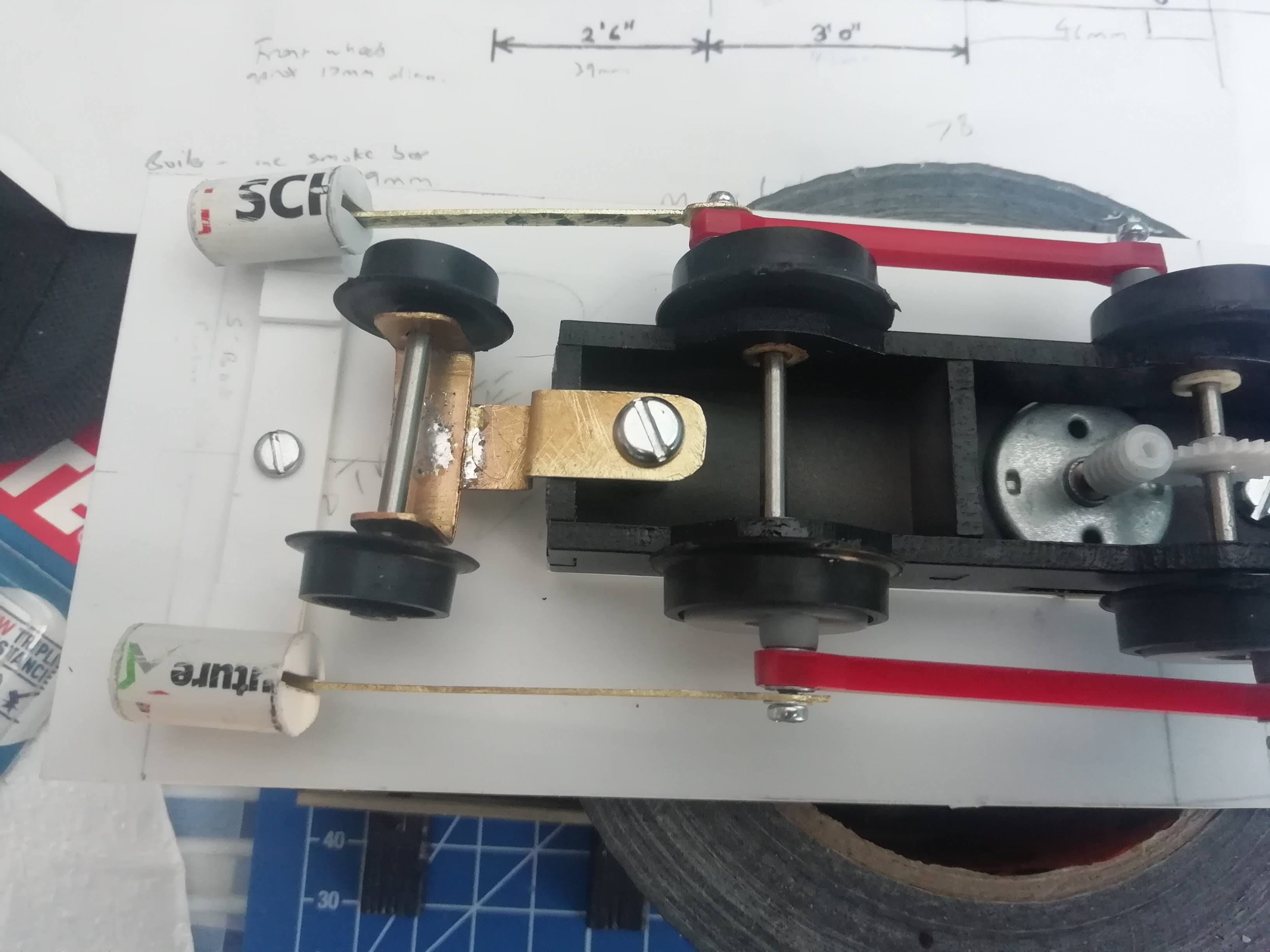

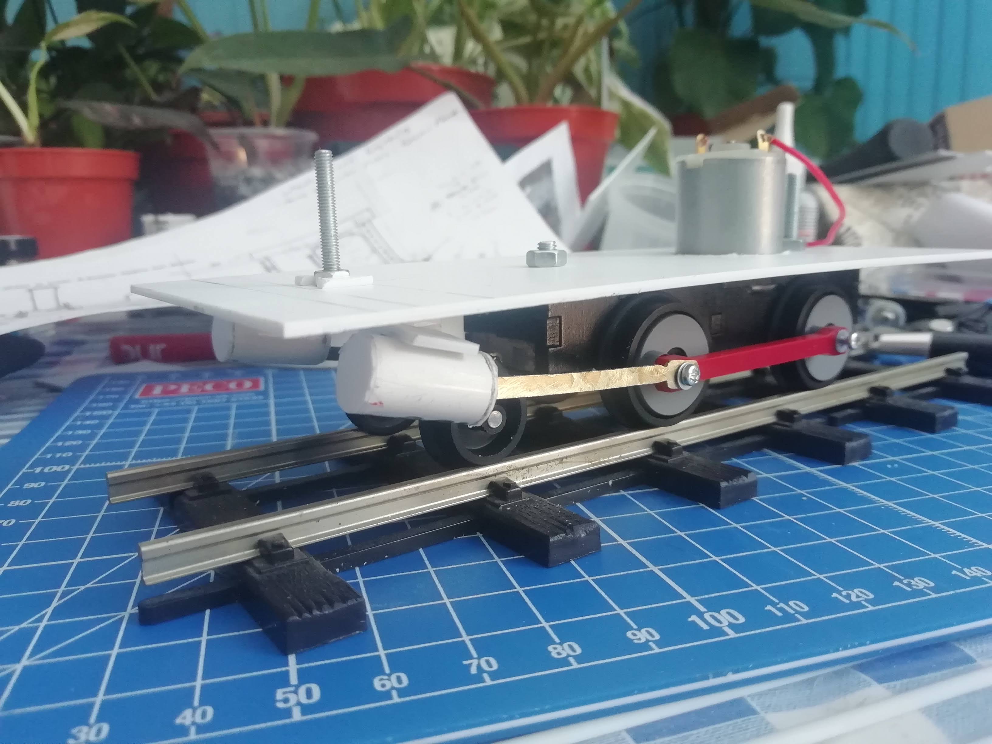

Post by Tom85 » Thu May 14, 2020 5:37 pm
Thanks for the encouragement, everyone. Today I completed the chassis, making and adding the front pony truck, then the connecting rods and cylinders. So my brass work might not be the neatest, but this is literally the first time I have soldered two things together that weren't wires!
The connecting rods were cut out and filed to shape from brass sheet, and the cylinders are sections of a biro. I chickened out of trying to construct working motion for the cylinders, but one advantage of the prototype is that this was hidden by a flap (the only concession I can see by the Rye and Camber to 'tramway' type safety features) meaning I could get away with a simpler arrangement.

Post by Andrew » Thu May 14, 2020 5:56 pm
Looking good! I approve of anything that uses bits of old biro and am impressed by any soldering skills - mine are hopeless!
I believe the flaps were to stop sand from the beach getting into the motion - the wagons had bits of sack over the axleboxes for the same reason, I think...

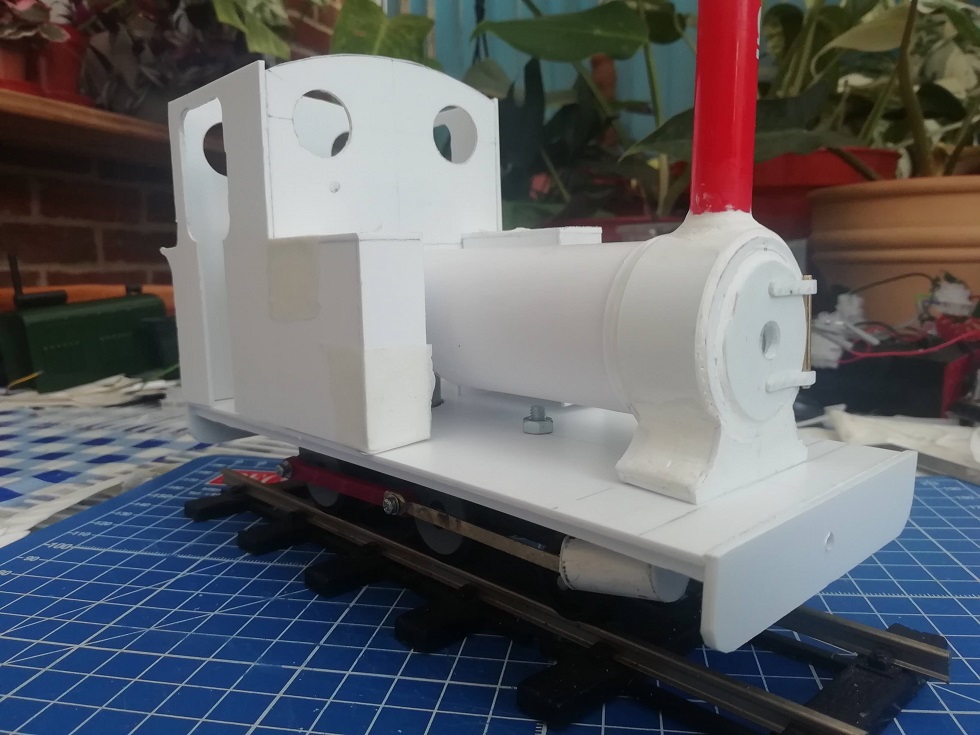

Post by Tom85 » Sat May 23, 2020 6:22 pm
After an enjoyable afternoon's work today, it's beginning to look like an actual loco...

Re: First time scratchbuild project - Bagnall steam loco
Post by philipy » Sat May 23, 2020 7:03 pm
Coming on well,Tom. Keep up the good work.

Post by LNR » Sun May 24, 2020 12:52 am
Tom85 wrote: Sat May 23, 2020 6:22 pm it's beginning to look like an actual loco...
It certainly is Tom. There's no stopping you now, your hooked!

Post by Old Man Aaron » Sun May 24, 2020 9:37 am
Impressive. Certainly looks like you've needed less filler than my first scratchbuild!
Post by Tom85 » Sun May 24, 2020 10:25 am
Thanks for the encouragement folks. I have used quite a lot of filler... And I haven't attempted the dome yet!

Post by philipy » Sun May 24, 2020 6:43 pm
Tom85 wrote: Sun May 24, 2020 10:25 am I have used quite a lot of filler...
Haven't we all? :lol: :oops:
