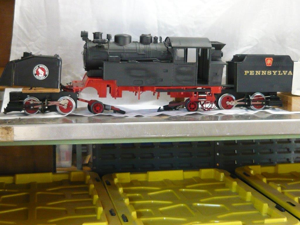

On another note I am now looking again at a Garret type of loco, it's procrastination city in the shed at the moment. Picture of a mock up below.
Garret mock up 2.JPG (97.93 KiB) Viewed 10024 times
Re: Making an Articulated loco from a Newquida loco
Posted: Thu Apr 23, 2020 10:01 pm
by GAP

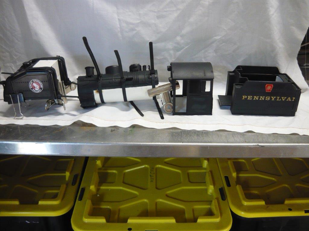

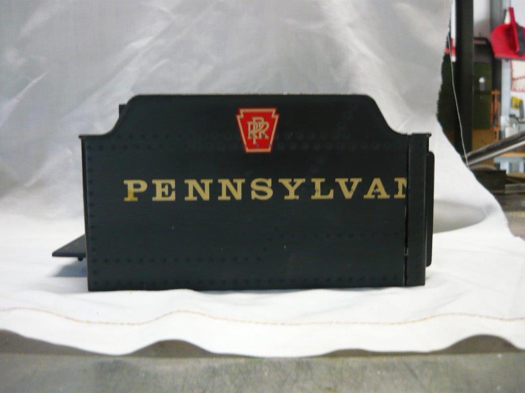

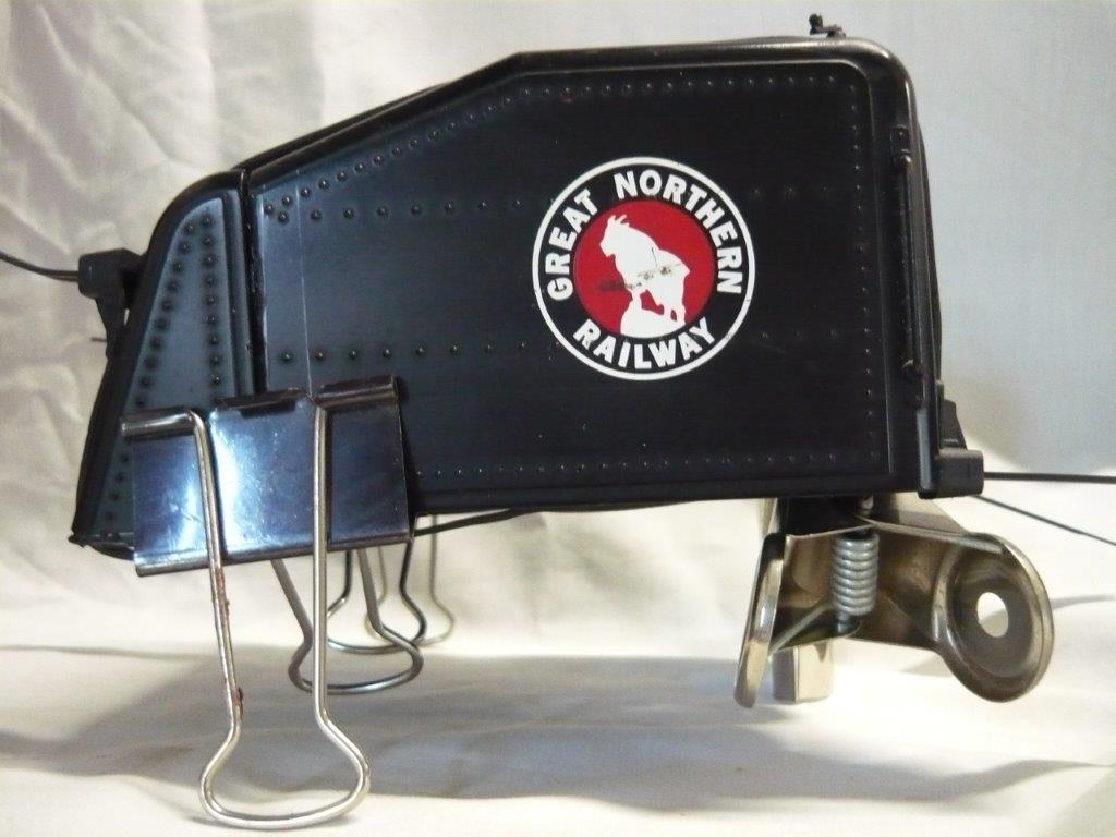

After much procrastination I decided to go with the Garret style for my articulated loco.
Progress so far;
1. Cut the coal bunker and side tanks off the Newquida loco.
2. Cut the back wall of the cabin off
3. Made a bottom for the boiler from a piece of 60mm PVC plumbing pipe
4. Cut a slope back tender up to make the front tank
5. Cut the water tank part off an LGB tender (from a "Shorty" loco)
All the components have been glued together (used Plastic Magic) and are now waiting for the gaps to be filled then sanded/filed smooth
Below are some pictures
Garret Boiler new lower section.JPG (64.25 KiB) Viewed 9966 times
Garret front tank cut and shunt.JPG (83.68 KiB) Viewed 9966 times
Garret front tank top view.JPG (71.79 KiB) Viewed 9966 times
Garret Tender cut and shunt.JPG (57.33 KiB) Viewed 9966 times
Garret components.JPG (87.14 KiB) Viewed 9966 times
