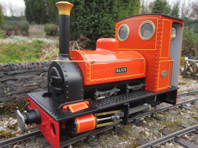

PDF Double Fairlie. This one is being detailed with pipework, bunkers ect. Bespoke, laser cut steel chassis's will be used with steel wheels and rods.
Lineside hut slate waggon and scratch built NWNGR slate box wagon

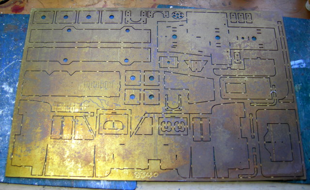

I've just dug out an enormous etched brass kit for County Donegal Railcar No.10 which has been sitting there for around five years.
1. I've never made an etched brass kit before
2. The kit does not have any instructions
I persuaded John Campbell to sell me a kit at the Llanfair Show - John is the chap who used to exhibit those wonderful operating crane layouts where sand was loaded and transported. He doesn't normally sell them but I twisted his arm by promising to make him a bespoke Deltang transmitter. I hadn't realised there would be no documentation with it so have been repeatedly putting it on the back burner.....
The brass is now quite tarnished and so it's not just a case of separating all the bits from the fret, they also need a fair bit of elbow grease before I can start trying to figure what goes where - and actually what some of the bits are.
Any tips on making etched kits would be most gratefully received.

Just in the process of separating all the pieces from the sheet. Taking ages. It's quite heavy gauge brass and the only way I can get through all the little tabs is with a slitting disk. I think I've got through over a dozen disks so far and I'm less than half way through.

Progress of sorts ....
There are three sheets (not to the wind..... :? ) and I've so far prepared one of them.
Before .....
..... and after ....

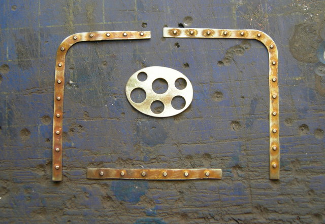

It took a while, but I've now figured out how those parts fit together. Well, nearly all. I just cannot figure where these parts go.
I've tried the rivet strips against all the other parts and they don't seem to fit any of them. And Goodness knows what the elliptical piece is for. I wondered if it might be an instrument panel for the cab, but there's nowhere obvious for it to fit. I've downloaded as many photos of the railcar (which is preserved in the Ulster Folk and Transport Museum) as I can find, but cannot spot this missing jigsaw piece.

ge_rik wrote: Sat Mar 21, 2020 4:05 pm Thanks Tony
Hi Rik
Try using a cheap wood chisel to cut through the tangs with the etch on a flat surface, certainly works with my 0 gauge stuff.

ge_rik wrote: Sat Mar 21, 2020 6:17 pm I've tried the rivet strips against all the other parts and they don't seem to fit any of them. And Goodness knows what the elliptical piece is for. I wondered if it might be an instrument panel for the cab, but there's nowhere obvious for it to fit. I've downloaded as many photos of the railcar (which is preserved in the Ulster Folk and Transport Museum) as I can find, but cannot spot this missing jigsaw piece.
That should keep you off the streets for a while...... ;)
If you can find a copy of Roger Crombleholme’s 'County Donegal Railways Companion', that has a good drawing and some useful photos of CDR #10.
The elliptical part is indeed the instrument panel, it was mounted inside the driving compartment under the window, on the left.
The riveted strips fit around the engine cover where it meets the cab unit. One curved one is on the front of the driving compartment, the other curved one is on the front of the recessed part of the cab and the straight one is on the side of the cab, connecting the other two. The other half cab Walker railcars had the same arrangement.

Thanks Doug. I did consider using a chisel but I was worried I might distort the parts in the process. I suppose putting a wood block underneath might help.
And thanks for "tangs". I wondered what they were called.
