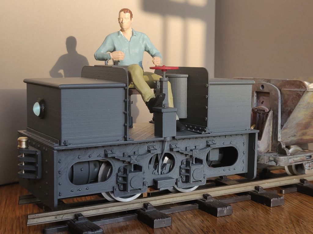

When I saw Mike Pinder's drawings for this loco in May 2019's 16mm today, I thought this it would make a nice quick build, a couple weekends worth of work. 5 weeks later and it's still not done...

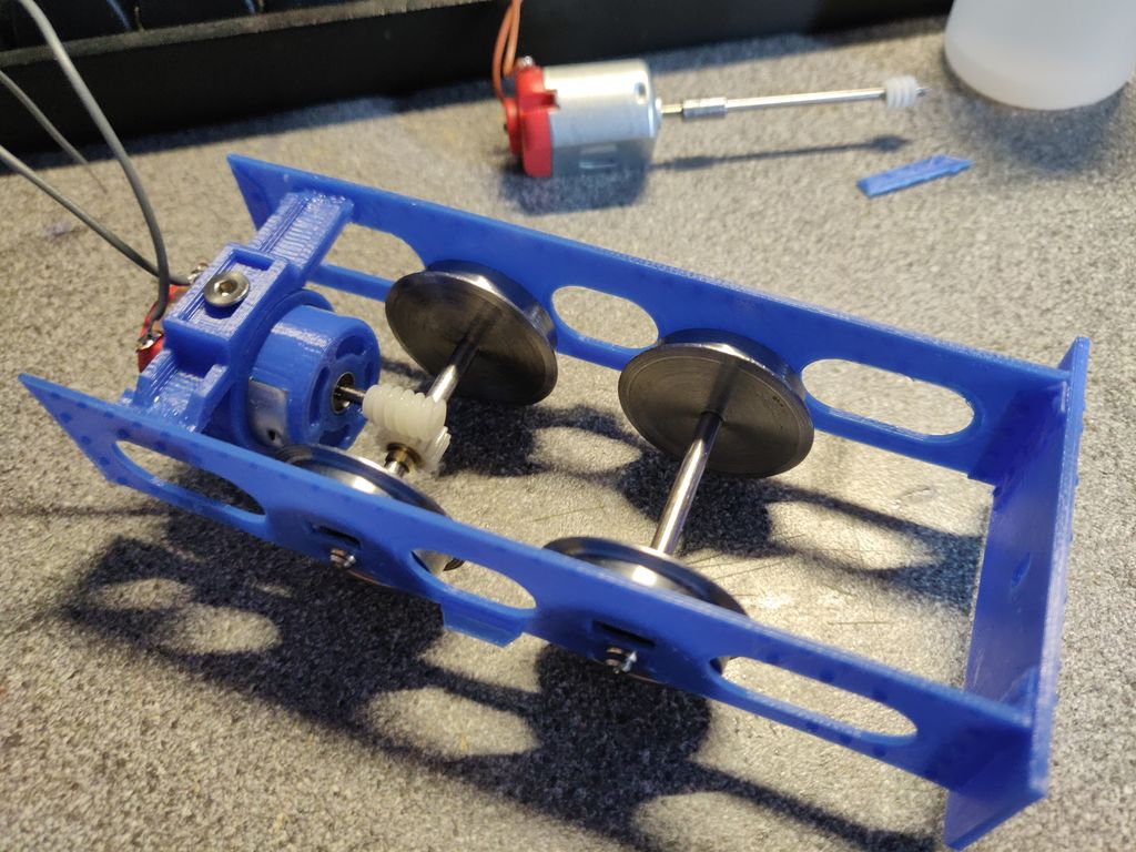

I recently got a finer 0.25mm nozzle for my 3D printer, and wanted to see what kind of detail it could achieve. I built a prototype chassis, with an extended motor shaft driving a worm on the opposite axle, like the underside photo of loco in the article. A printed clip on assembly held the worm to the spur gear and gave the appearance of the gearbox from the underside.

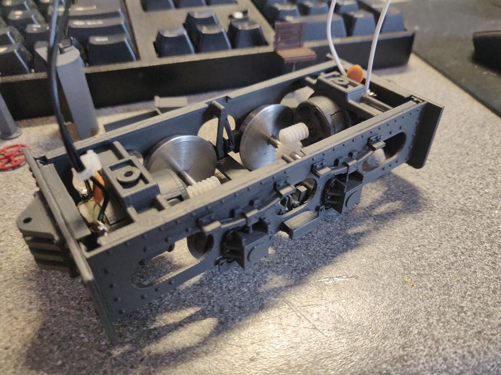

This didn't work. There was too much friction for the little 130 size motor, so I went for a traditional setup, but still with two motors.
The motors are the type with the flats on each side, so to try and make them look round extra printed bits were added, also used to mount the motors.
I found a photo of one of the later versions in use, and printed a driver in a similar pose.
The driver model was generated in a program called Makehuman, loaded into Blender to pose the limbs, and then exported to an .stl for printing. This was my first time doing this - came out OK for a first go, its pretty useful to be able to generate figures in custom poses.
The lights have red/white bicolor LEDs, with the diffuser printed in clear PETG.
In the back box there is a power switch and removable LiPo battery, and in the front box there is a horrific mess of wires, but an NRF24 based RC system does just about fit.
The 0.25mm nozzle did reproduce a lot of detail, which basically comes for free as it is just copy and pasted in the CAD program, but the defects from it being printed are still obvious. No effort was made to sand the surfaces smooth, the prints were very quickly blasted with a hot air gun to get rid of any hairs of plastic, then painted. The NRF24 RC system seems to work OK, no issues with range have been noticed so far.
Still need to build a proper boxed transmitter for the RC, also plan on etching some brass nameplates for this and other locos.

Brilliant!.... the frame detail is amazing, especially as you have left it untouched out of the printer.

Overall that is a very nice job, although it's a shame that the flat surfaces show so much printer surface defect.

Glad you have left the build without smoothing it. It looks absolutely brilliant. worth making some and selling..... :mrgreen:

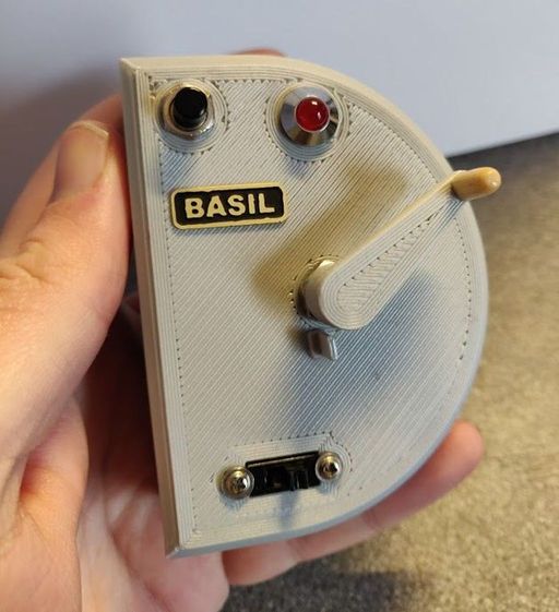

Had a go at making some brass nameplates for this loco yesterday.
I'm still working on my etching process, but it looks very similar to what you would do to etch a double sided circuit board at home.
I'm using the type of UV resist that comes on a roll, you apply heat and pressure to stick it to your substrate. You expose it to UV light with a pattern on top, where it hardens and turns darker. I used a normal halogen bulb for exposing. Then you wash off the unhardened resist with washing soda to reveal the metal underneath, ready for etching:
The fact a 3D printer has a temperature controlled flat plate can come in handy for things other than printing. I used it for applying heat to stick the resist to the brass, and for gently warming the ferric chloride etchant while rocking it back and forth.
The finished etch here has a few imperfections, I think I took it out too early so the etchant didn't get into the sharp corners of the text, leaving it more rounded.
They were spray painted black, and then the paint was sanded off in the high spots. Fitted to the loco:
I made three in case one etch failed, but all three came out OK so I stuck the last one to the controller.
The controller is a bit prototype looking, being unfinished 3D printed parts. It is supposed to be reminiscent of the control panel on the loco itself, and it ended up fitting in the hand quite nicely, you can use your thumb to adjust all the controls.
Inside is just point to point wired, with an arduino pro mini and NRF24 board, powered by a 9V battery. Unfortunately, while the R/C system worked great while it was outside the loco and controller, once put inside it's been a bit troublesome. More tinkering required...

Excellent all round. I do like the controller! :D

metalmuncher wrote: Sat Dec 07, 2019 2:42 pm
Love the controller. The loco is a thing of beauty too, of course, but the controller is the pièce de résistance!
