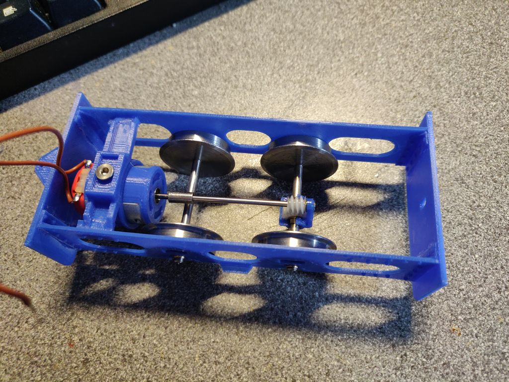

When I saw Mike Pinder's drawings for this loco in May 2019's 16mm today, I thought this it would make a nice quick build, a couple weekends worth of work. 5 weeks later and it's still not done...
I recently got a finer 0.25mm nozzle for my 3D printer, and wanted to see what kind of detail it could achieve. I built a prototype chassis, with an extended motor shaft driving a worm on the opposite axle, like the underside photo of loco in the article. A printed clip on assembly held the worm to the spur gear and gave the appearance of the gearbox from the underside.
This didn't work. There was too much friction for the little 130 size motor, so I went for a traditional setup, but still with two motors.
The motors are the type with the flats on each side, so to try and make them look round extra printed bits were added, also used to mount the motors.

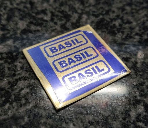

Had a go at making some brass nameplates for this loco yesterday.
I'm still working on my etching process, but it looks very similar to what you would do to etch a double sided circuit board at home.
I'm using the type of UV resist that comes on a roll, you apply heat and pressure to stick it to your substrate. You expose it to UV light with a pattern on top, where it hardens and turns darker. I used a normal halogen bulb for exposing. Then you wash off the unhardened resist with washing soda to reveal the metal underneath, ready for etching:

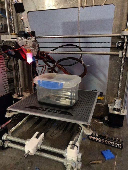

The fact a 3D printer has a temperature controlled flat plate can come in handy for things other than printing. I used it for applying heat to stick the resist to the brass, and for gently warming the ferric chloride etchant while rocking it back and forth.

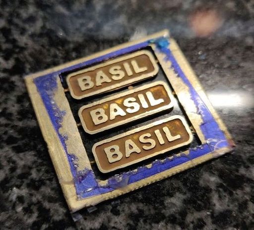

The finished etch here has a few imperfections, I think I took it out too early so the etchant didn't get into the sharp corners of the text, leaving it more rounded.
They were spray painted black, and then the paint was sanded off in the high spots. Fitted to the loco:
