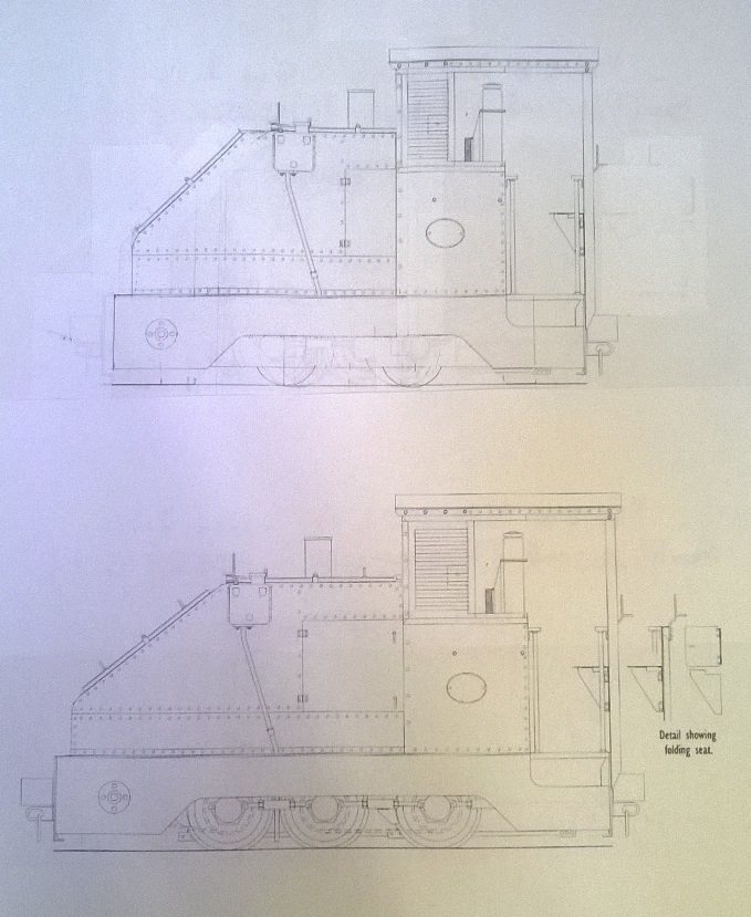

I got to thinking about my trusty RH Little John... If only I could use that rugged and reliable chassis for something WHR-ish... And then RH released Hercules, the same sort of thing but without the outside cranks, and I began thinking... And looking at pictures of Kerr Stuart diesel 4415, which was tested on the WHR and FfR in the 20s (and has since returned...) and which has voluminous skirts to hide all manner of inaccuracies:
It's got a different wheel arrangement of course, but - I thought - what if I didn't model 4415, but 4416, an imaginary sister loco, almost the same, but not quite... Perhaps the shorter wheelbase would be better suited to slate wharves at Dinas and Minffordd???
The top drawing, below, is what I've come up with so far - a tweaked and shortened drawing to work from, which should - just - accommodate a Hercules chassis, as long as it's the same as a Little John one anyway...

Looks promising, Andrew. A neat reinterpretation of the original to my mind. As I understand it, loco manufacturers were more than happy to adapt their stock products to meet the requirements of their customers so I'd say your shortened version is certainly in keeping with that ethos.
I like the way in the photo the lettering saying 'Diesel Locomotive' has equal prominence. Presumably to explain to any onlookers why there was no smoke and steam in evidence ....

Thats a nice project and should work out well, Andrew.
ge_rik wrote: Fri Sep 27, 2019 6:35 pm
Rik, I suspect that may have been a catalogue photo, so a long the same thought track, the label was probably to explain why there was no chimney, SV, and other 'normal' bits sticking out.

Andrew wrote: Fri Sep 27, 2019 4:01 pm With the proportion of "proper" Welsh Highland and Ffestiniog stock on my railway gradually increasing, I've been thinking about a suitable battery powered loco to pull it when I don't fancy raising steam.
I looked at building a Kerr-Stuart ng diesel a while back and started accumulating the necessary info. None came to Aust., but 4415 was converted to 3' gauge and trialled on the C&VBT in Ireland, hence my interest.
Andrew,
You may not know, but K-S did build 4 wheeled diesels. Yours looks about right for the 30HP model.
The drawing below is from a pamphlet K-S published at the time they were introduced and shows the 30HP 4w version as designed. Brian Reed in his book on early British IC locos states four were built before K-S collapsed in 1930, builders nos. 4465, 4466, 4467 and 4470. I've seen references to these locos having a different outline to the drawing in the pamphlet, but never found a photo of the 30HP type.
There was also a smaller design of 4W diesel loco designed for civil engineering work that looked more conventional, with the radiator in the normal position at the front, instead of mounted off-centre in the cab like 4415.
KS-30 side-end small.jpg (106.39 KiB) Viewed 105153 times
Rik, Philip,
The photo Andrew posted is said to be KS 4415 while being tested on the WHR and the Colonel must have worked it hard. The patches of dirt/rust on it would be unlikely to have been present when first completed, especially on a works photo taken for catalogue purposes. Photos of it in use on the Ffestiniog show it after modifications and even grubbier, but still lettered.
A photo of the loco with the same background as Andrew's photo is shown in the pamphlet, but it looks like the photo has been airbrushed to remove the lettering and dirt patches. There's nothing in Photoshop that the old photographers couldn't achieve in the darkroom........ ;)

I wouldn't mind having a go at knocking up an 0-6-0 chassis and body for one of these if i had those drawings :D Well done :thumbup:

-steves- wrote: Sat Sep 28, 2019 3:31 pm I wouldn't mind having a go at knocking up an 0-6-0 chassis and body for one of these if i had those drawings
It's an interesting project and unlike more modern diesels doesn't require panel beating skills and a miniature english wheel to build the bodywork in metal. ;)
The Industrial Railway Society reprint of the Kerr-Stuart pamphlet is still available. This has outline diagrams of the 30HP and 60HP ng designs, as well as some useful photos of how they were put together, including the chain drive arrangements.
https://irsshop.co.uk/epages/c06e4627-f ... ucts/0124S
The group restoring the original 4415 have a website with better drawings of the 60HP design, as well as a blog page chronicling the restoration progress, which has some useful photos of bits not usually seen. They've also got a cut away drawing they use for indicating progress, which is useful as it indicates what the cab controls looked like.
http://www.kerrstuart4415.org.uk/index.html
http://ks4415.blogspot.com/
There’s also a recently released new book on the Kerr-Stuart diesels that I haven't seen.

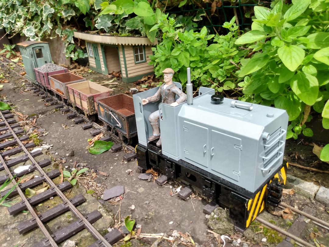

To recap, the plan was to use the chassis from a Roundhouse Hercules under a scratchbuilt body representing a 4 wheeled 30HP Kerr Stuart diesel, the "little brother" of the 60HP 4415, which was trialled on the WHR and FR in 1928 and 1929 - and to edit WHR history to fit, of course.
And so, for the past couple of years, visitors to my railway thread will have seen this little (well, quite big, almost 7/8ths-y looking) loco trundling about:
No 6 E.jpg (213.29 KiB) Viewed 99861 times

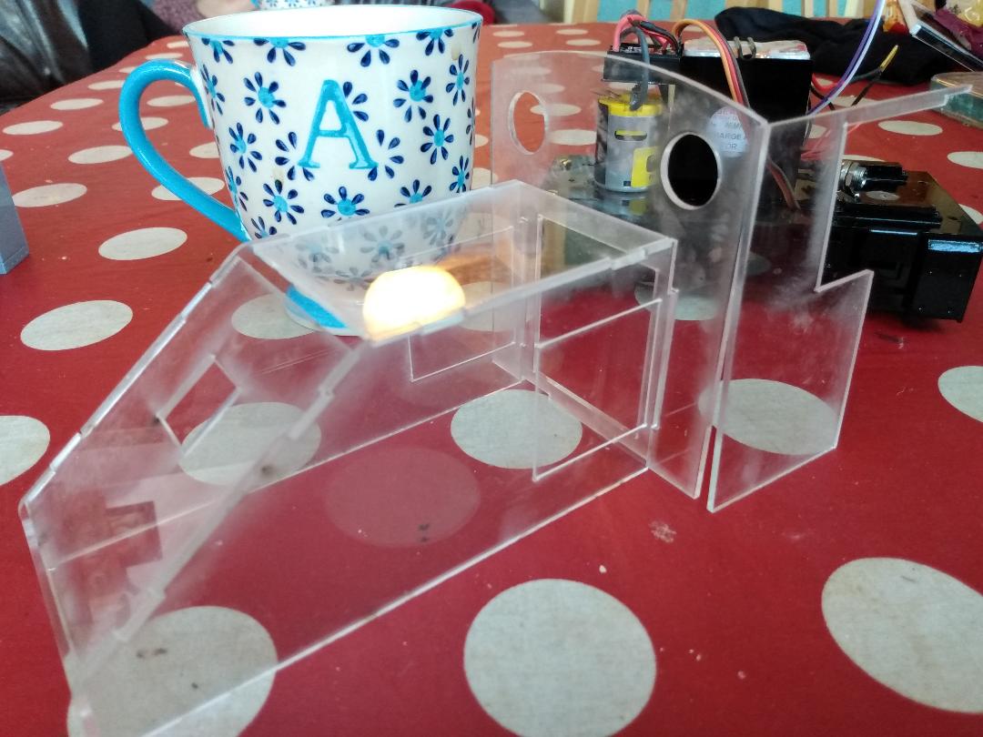

Here are some of the bits trial assembled. They say that see-through acrylic is perfect for loco kits, but I just can't see it myself:
KS 2.jpg (104.33 KiB) Viewed 99861 times
Sorry, very bad joke...

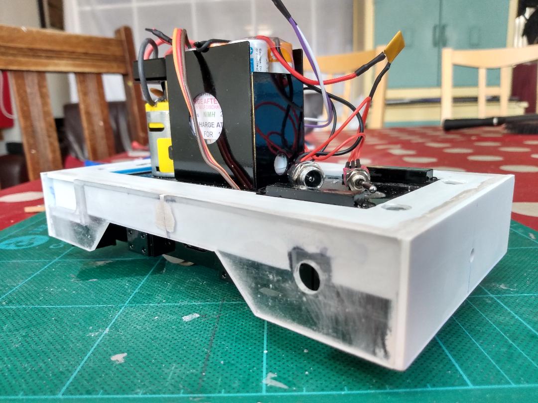

Hello!
Yes, that's what I'm finding! As per advice elsewhere, a knife was pretty useless. A razor saw did better, but I found it hard to stop it skittering off the line I'd drawn. I've ended up using a cutting disc in my Dremel, which cuts cleanly but is hard to keep accurate - I'll just be using a lot of filler! I did try to cut the cab down a little to change the cab:bonnet proportions slightly, but I gave up because I didn't feel confident I could end up with a clean edge. The bonnet will have to be cut, of course, but it will be easier to hide any mistakes.
Here's where I got up to this afternoon:
KS 3.jpg (123.72 KiB) Viewed 98585 times
The footplate is cut from 2mm plasticard, and is a fairly snug fit around all the RH gubbins. The side "skirts" are from the kit, shortened to fit by taking a slice out of the middle. The bufferbeams should have been the original acrylic ones, but I drilled the holes for the couplings in the wrong place, so I had to replace them...
Next up will be the cab, pretty much as per the instructions but with the spectacle plate hacked about to fit around the chassis.

Andrew wrote: Sun Jun 26, 2022 7:12 pm As per advice elsewhere, a knife was pretty useless. A razor saw did better, but I found it hard to stop it skittering off the line I'd drawn.
I'd be very wary of using a Dremel on acrylic, there's too high a risk of the plastic melting, shattering the disc and possibly the part.
How were you holding the part to saw it? If the part was flat on the bench and the razor saw was held horizontally, I'd imagine it would skid around. Making up a small bench hook from bits of wood and using that while making the cuts would be better.
I've been trying to remember how I used to cut small perspex parts when building HO passenger cars in the '70s, but it eludes me. Possibly a piercing saw, as I had one by then.
Nowadays I usually rough the sheet down on my little Proxxon bench saw and make the more complex cuts with a piercing saw. However you do it, I think the cut needs to be made with the part held flat and the saw blade vertical. It would also help, if using a razor or piercing saw, to file a little nick in the edge of the part to help keep the blade located as you start the cut.

I'll echo Graeme's point about a Dremel disc melting the plastic. On the few occasions when I've tried cutting perspex or acrylic sheet, I found scoring and snapping to work. But, of course, that only works with long edge to edge straight cuts and the scoring needs to be on both sides (easy to see the opposite score with clear sheet). Fiddly little cuts and cut-outs are much more tricky.
