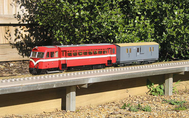

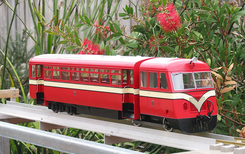

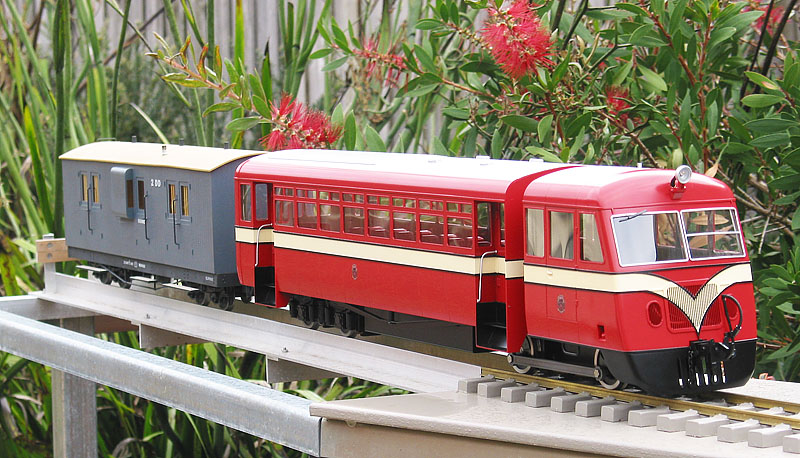

The photos below show my new toy.
I have been contemplating building a large rail motor for the TVT, but hadn't got past acquiring a motor and some gears, although a few concept drawings had been done, mostly based on rail motors operated by the EBR in Tasmania.
I remember the VR broad gauge Walker railcars from my childhood, although they rarely ran on our line. I mostly saw them on trips during holidays, which has probably left me with rosier memories than the real ones deserved.
I was aware that Trackshack were planning a model of one of the CDJR/IOMR Walker railcars, but they don't ship outside the UK. Then as you do, I was browsing Argyle Loco's website a while back and found that they had some Accucraft Walker railcars. Predictably they had sold the last one just before I rang them......
Anyway, to cut to the chase, Lesley managed to track down one of the last ones left in captivity and some of the kid's inheritance changed hands.
The model eventually arrived in Oz and was delivered safely last Wednesday. It is now sitting on the bench while I contemplate how to fit it out for r/c battery power. As it comes it is set up only for track power, although I believe Trackshack were offering to fit r/c battery power as an option.
The photos show it standing in the steaming bay on a dreary day between rain showers. The lighting is better for photography though.
The first photo shows it from the power unit end.
The next photo shows the back end of the passenger section, looking like the back of a bus, which they basically were.
The last photo shows it buffered up to a bogie guards van, showing that it fits in well with other TVT rolling stock. There's no space for goods and parcels in the railcar itself, so it will be getting a suitable trailer when I get around to building it. In the meantime a guards van will fill in for a bespoke trailer.

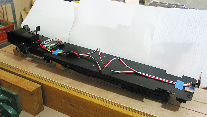

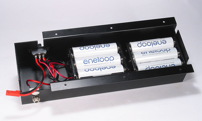

About a month ago I decided it was time to fit battery r/c to the Walker railcar, figuring it could be done in a weekend and I could get back to the steam loco on the workbench........
Big mistake, as it turned into a month of monkeying around to find out why it wouldn't work properly. :roll:
I already had a RCS Tx-1, so all I needed was an ESC and an RX and some batteries. The ECS and Rx came from RCS here in Australia and work started after the Ozpost delivery snail finally found it's way here.
Three weeks later and numerous emails between myself, Tony at RCS and Steve at FosWorks and it finally started working the way it was intended. The RCS and Fosworks hardware works well and I can't fault Tony's customer service. The issue was finally traced to the motor fitted to the model by Accucraft. Sigh...
The first job was to strip out all the pickups and wiring for track power, which is how these models are supplied. Not difficult, but I recovered enough wire for another couple of models.
The original plan was to fit the Rx and ESC into the cab and the batteries in the battery box already fitted to the model by the factory. There was enough space for 12 x Eneloops AA cells which are my preference anyway, but a 4S Li-ion battery takes up about the same volume.
The first two photos shows the original electronics fit in the cab and the battery setup.
That's when the fun started. The first problem was that the Rx/ESC didn't respond to the Tx. It turned out my Tx needed to be calibrated to the ESC. With this done, the model then ran on the bench, so the chassis was taken out for a track test.
That was the start of rounds 2, 3, 4, etc......... The model started to run, then stopped and had to be turned off to reset everything.
It looked like some sort of RF interference was going on, so the electronics were rearranged so the Rx was as far from the motor as possible. The rough lashup is shown in the photo. In the final setup the wiring is all under a false floor and is invisible to an observer.
No improvement, so then various suppression components were fitted. Some days it worked, some days it didn't. To cut a long story short, the problem was eventually traced to the motor.

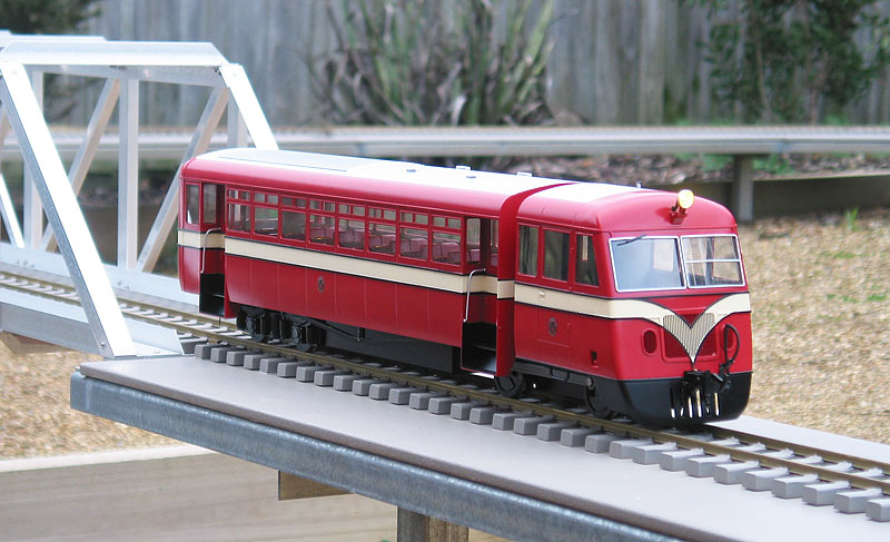

Replacing the motor sorted out the interference problems and the model was then re-assembled, after some modifications with a Dremel so the body would fit the chassis properly, without resorting to rude words. The model comes fitted with a headlight and internal passenger lighting, which now has an on/off switch. The LEDs were blue white, so they have been given a few coats of Tamiya transparent yellow paint, as Walker railcars had 24V incandescent bulbs and a pale yellow glow would be more appropriate.
It rained yesterday, but it held off this afternoon, so the next two photos show the model during a flawless test run on a gloomy SE Aust winter afternoon, just as the light was failing.
The new motor is a little slower than the factory original, which is not a bad thing. Top speed is now about 20 scale mph from a 14.4V battery and radio range is at least 75', which is as far away as I can get and stay in line of sight on my block. On previous experience with 2.4GHz r/c in a brass bodied loco, that seems pretty good to me. If it goes out of sight the ESC has cruise control, so it just keeps running anyway.
