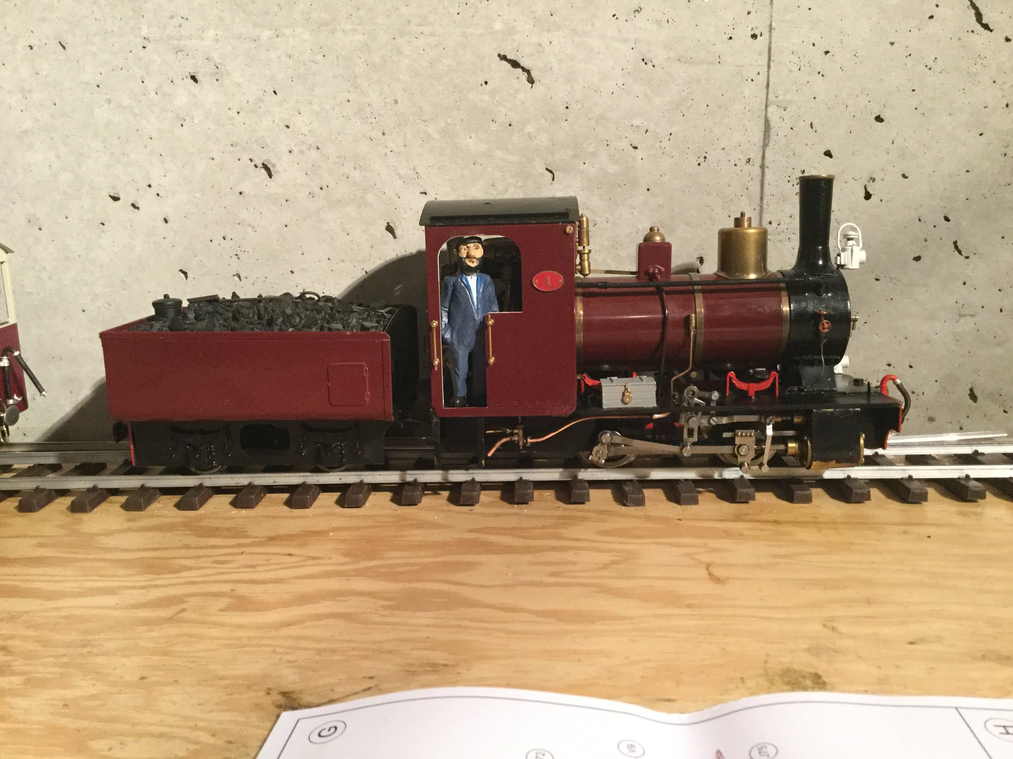

Here is one of the injectors temporarily installed on the locomotive. I think it adds some visual interest to the area under the cab. Still have to fit a pipe to the rear buffer-beam and a hose to the tender. I fitted it by threading the steam-pipe and using a nut and collar to secure it to the cab floor.

I don't know how much interest this will garner, but I've finished working out how to apply this particular detail to my "Billy", and have officially used up all the detail bits I binge-purchased at Peterborough in 2017.
I made the hose connection to the tender out of some silicone fuel tubing for model aeroplanes- I simulated the ridged rubber look by overlapping small sections of heat-shrink electrical insulation and then heating it over a flame to shrink and form the "u" shape. Although it's a bit over-scale, I think it does the job nicely. At first I thought this "injector" detail might be a trifle overkill for this model, but now it's finished I think the tender always looked like an unnecessary afterthought, wheras now it looks like it's part of the locomotive, as it should be.
I thought someone might appreciate my idea for making realistic-looking rubber hoses, too. If this was a coal-fired engine with actual water in the tender, the hose would be fully functional and look a mite better than a plain silicone tube.
