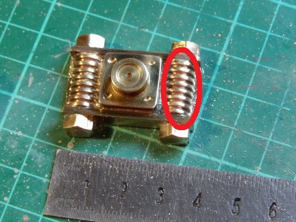

I have to ask though, but how on earth did you make the highlighted bit below?????

it's actually nice to know you have issues doing things like that sometimes too, makes me feel a little less useless when I can't get things to go right when I do things, lol. Like solder a few things to something, then watch them all drop off when I solder something else on, these days I use engineering clamps for all soldering work as I got fed up on the Peckett build with everything dropping to bits again, lol.Oily Rag wrote: Thu Apr 11, 2019 6:03 pm Hi Steve,
Well Ahem! Those dummy "springs" were turned from brass rod. I used a tipped tool with a triangular insert which is straight on and usually used for cutting threads. Cut in concentric rings to a common depth moving the saddle along the bed quite simply by measurement with a steel rule. I should n't say this as the health and safety are not happy with it but some careful jusicious dressing with a needle file finished the tops. Part them off to length ( I did fractionally over) and then file the back off to a full diameter, that means when assembled the pattern will come out of the mould with no undercut. A bit over length means you can adjust the fit. I did cheat and milled the back off.
The worst part of that job was getting the thing to solder up without previous bits falling off again. You can see quite clearly the flood of solder towards the back of the recesses. I should have used differing temperature solders or solder paste and warmed the whole lot through. There might have been less expletives.
