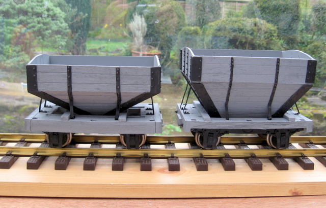

Hopper number two now completed.
I've adjusted the dimensions on this one - I think (personally) it looks better proportioned. I've also changed my construction techniques slightly. I was struggling to get the strapping right with brass. I've used plastic for all the strapping on this one - and had a clever wheeze for the diagonal straps which hold the hopper to the base..... :? ;)
This is the first one for comparison.
I'm not too worried about there being differences in the wagons. From photos it looks like those on the Snailbeach were a bit varied in their design and I've got a couple of rakes of LGB tipplers which are very uniform, so this train should look a bit more interesting, particularly after I've weathered and distressed them a bit.

Yes I agree Rik, No2 does look better proportioned.

I like both of the wagons and the mis-match works well. It seems more appropriate in narrow gauge than it would in standard gauge where there would be more control over capacity. The wood-grain effect is very good too! You should put that method on your blog.

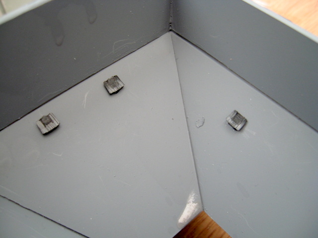

philipy wrote: Fri Mar 08, 2019 1:28 pm You mentioned a clever wheeze but then omitted to tell us what it is?
I was hoping someone would ask ..... I felt that styrene ties would have been susceptible to damage which is why I used brass for No.1. However, my metal working skills are a bit ropey, so I wasn't too happy with the outcome. And beside, I wouldn't have had enough escutcheon pins for all the wagons. At about 3.00am, I had a bright idea (well I thought so)! Cable ties!! They're designed to be flexible and strong. And also, if ever I needed to separate the body from the chassis, I could just snip through them and then replace them.
I carefully cut the clamping bit so there was enough left to stop the tie from pulling through - and there was enough left of the ratchety clamp thing to thread on underneath.
Voila!

ge_rik wrote: Fri Mar 08, 2019 2:16 pm I was hoping someone would ask ..... I felt that styrene ties would have been susceptible to damage which is why I used brass for No.1. However, my metal working skills are a bit ropey, so I wasn't too happy with the outcome. And beside, I wouldn't have had enough escutcheon pins for all the wagons. At about 3.00am, I had a bright idea (well I thought so)! Cable ties!! They're designed to be flexible and strong. And also, if ever I needed to separate the body from the chassis, I could just snip through them and then replace them.
Voila!
Genius.
I may well steal this solution for mounting "sardine tin" tubs on to Binnie chassis.

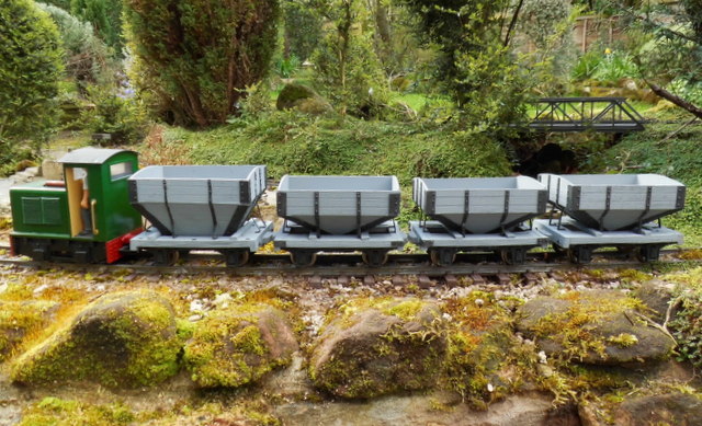

Now got another two wagons completed.
I've tweaked the design slightly as I've progressed.
Quite happy if there is slight variation between the wagons as those on the Snailbeach were far from uniform.
I've now cut and shaped the components for the remaining five wagons, so these ought to go together a bit more quickly (famous last words?).

Going to be a very impressive rake when completed. :)

They are wonderful Rik!
I've always admired the kits but, like you, paled at the cost of a rake of the things. You've inspired me again! :thumbup:
