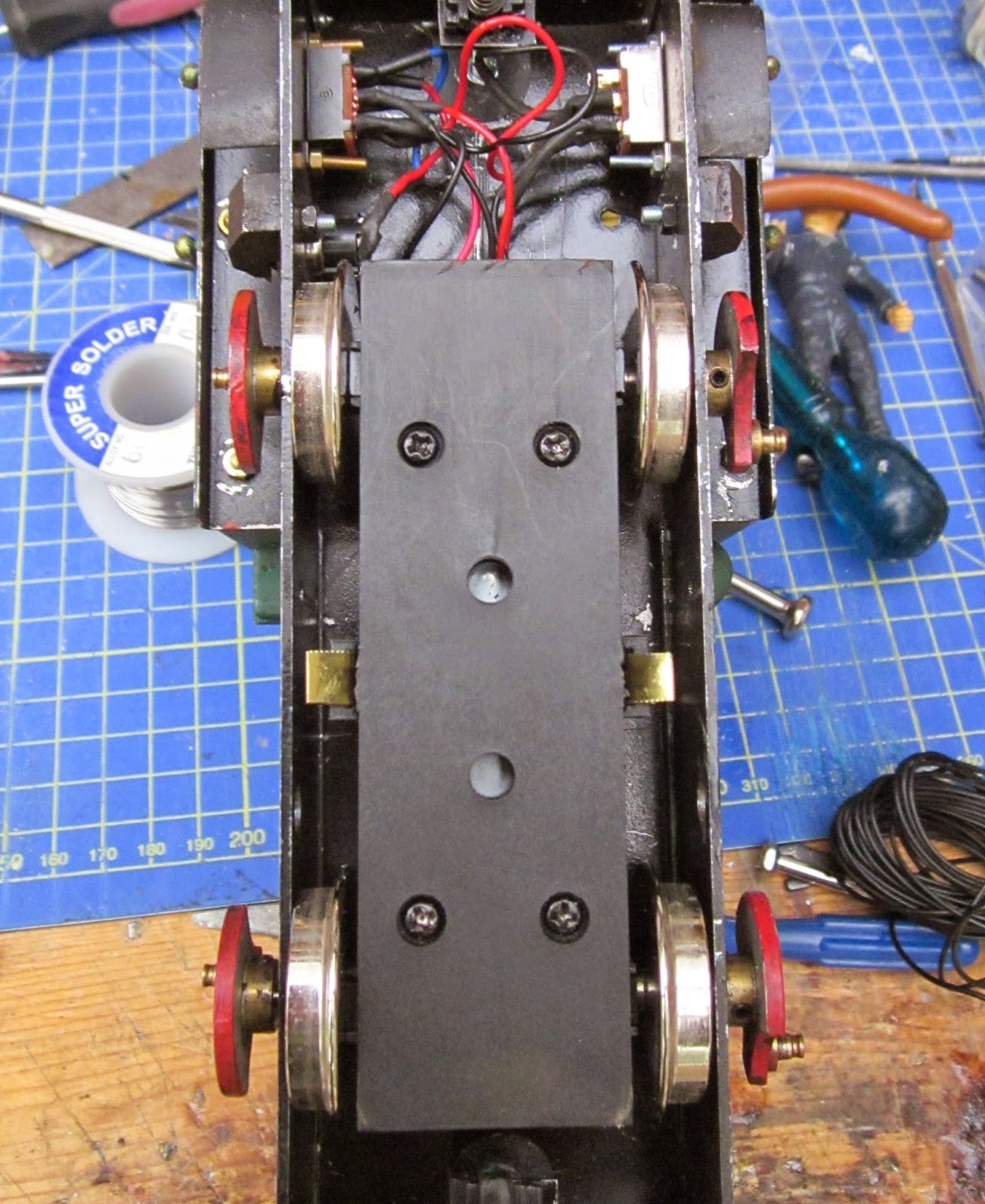

Posted: Sun Jan 10, 2021 8:16 am
Does anyone know the size and thread type for the grub screws on the fly cranks? There's one lying on or beside the track after my New Year's Eve midnight run and despite crawling around the entire layout with a magnet, it's not turned up.

Posted: Mon Jan 11, 2021 5:26 pm
Hmmmm ..... I've tried fitting metric screws into the hole. It's too small for M3 but too large for M2. I suspect it might be Imperial. I've lost track of my diddy Allen keys, but when I track them down I'll see what fits.
I've emailed Ivan asking what size and thread they are but not heard back yet.

by GTB
ge_rik wrote: Mon Jan 11, 2021 5:26 pm Hmmmm ..... I've tried fitting metric screws into the hole. It's too small for M3 but too large for M2. I suspect it might be Imperial. I've lost track of my diddy Allen keys, but when I track them down I'll see what fits.
Welcome to the wonderful world of thread 'standards'.......... :roll:
It might be quicker to wait for Ivan to reply, so let us know what he says.
With an OD between 2mm and 3mm, the easily available candidates in the UK, would be either 6BA, or maybe M2.5.
If you have a 6BA screw available try it and if it fits then 6BA grub screws are still available. I usually get mine from the local ME suppliers, but have also bought them from BA Bolts in the UK and I think EKP Supplies would have them.
If you want to play around and measure things while waiting for Ivan, 6BA uses a 0.050” key and M2.5 uses a 1.27mm key. The same size key actually, if you do the calculation. If you manage to remove one to measure, a 6BA grub screw will have an OD of 2.8mm and M2.5 will have an OD of 2.4mm.
I keep some M2.5 grub screws, but they are fiddly to use and I only keep them as spares for a couple of locos that use them. They are even harder to find on the workshop floor than a 10BA nut.........
Less likely candidates would be the US threads, #3-48UNC or #3-56UNF, which have an OD of approx. 2.5mm. Presumably available in the US, but as rare as rocking horse manure here in Oz, and also the UK I should think.
Small 'imperial' fasteners below 1/8” BSW and 3/16” BSF have been obsolete since Adam was in short pants, with BA sizes being the recommended alternatives.
Just to make life interesting, a 6BA screw will fit into an M3 threaded hole, but an M3 screw won't fit into a 6BA hole, which is why I think you might be looking at a 6BA grub screw in this case. Maybe.........
