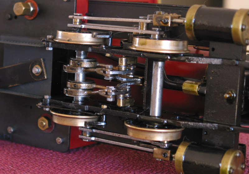

The following pic is the Stephenson valve gear that Gordon fitted to the 45mm gauge Philadelphia models that he built about 20 years ago. To give you some sense of scale, the coupled wheelbase is 53mm, the driver dia. is 33mm and the cylinders are 7/16" dia.
The 32mm gauge mm models came with slip eccentric gear, due to the restricted space between the inside frames. My loco was one of the machinist kits he sold and had a hard life before I found and restored it, so I was very familiar with the valve gear by the time I finished. There are a few general pics of the restoration in this old thread, but none show the valve gear.
https://gardenrails.org/viewtopic.php?f ... win#p58209
These models are smaller than a Roundhouse Lilla and being typical Baldwins, the valve gear is inside, with the valves and cylinders outside. Gordon supplied bronze castings for the eccentric straps and rods, but I've fabricated them on subsequent models, using gunmetal straps and brass rods/clevises. The eccentrics are fixed to the axles with grub screws so they can be adjusted and there is a hole drilled through the eccentric strap to access the grub screw once everything is assembled.
The rockers needed to transfer the valve drive through the frames is what takes up a lot of space which wouldn't be needed if the valves were also inside the frames. Also 45mm gauge inside frames are closer together than 32mm outside frames, which is why I think it can be fitted to a 32mm gauge Quarry Hunslet.
Clearances are fairly tight, but no worse than the area around the crosshead and slidebars on an outside Walschaerts loco. in this scale. The valve gear does run OK. It can be linked up and will use less steam when that is done.

That's most useful! - thank you!...The following pic is the Stephenson valve gear that Gordon fitted to the 45mm gauge Philadelphia models that he built about 20 years ago. To give you some sense of scale, the coupled wheelbase is 53mm, the driver dia. is 33mm and the cylinders are 7/16" dia....
Lilla wheelbase is 72mm and driver dia is about 34mm, so your pic is directly comparable. Your loco might be 45 mm gauge, but if you take away inside frames (and replace them with outside frames) it could easily be 32mm gauge?
I think I agree with you...The 32mm gauge mm models came with slip eccentric gear, due to the restricted space between the inside frames. My loco was one of the machinist kits he sold and had a hard life before I found and restored it, so I was very familiar with the valve gear by the time I finished. There are a few general pics of the restoration in this old thread, but none show the valve gear.
[url]...Also 45mm gauge inside frames are closer together than 32mm outside frames, which is why I think it can be fitted to a 32mm gauge Quarry Hunslet...

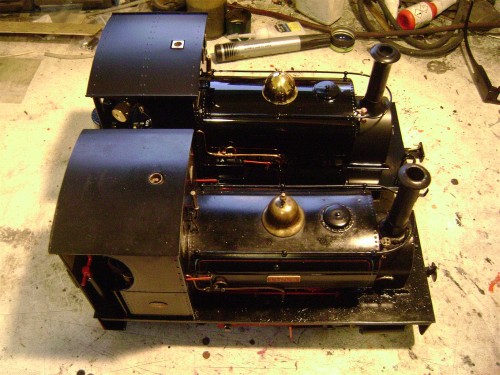

Twenty were made by Swanage Models, all with slip-eccentric valve gear. I own one and it took some considerable time to get running to what I would call an acceptable standard. Nothing wrong with the valve gear, but poor chassis design and construction did their best to stop it working as it should. Fitting radio control to the regulator prevents it from running away and I have to say that now it runs very nicely.bambuko wrote: Tue Feb 26, 2019 11:09 amA small batch to this design was built by Swanage Models some years ago. Unfortunately the valve gear as designed does not work, it jams. The builders substituted an alternative arrangement, it may have been slip eccentric but they wanted reversing from the cab. They also kept to the designed cylinder size of 3/8" which can make slow running difficult. 1/2" or 9/16" cylinders make for a much more controllable loco...
The plan then, I believe, was for GS Models/Western Steam to make another batch fitted with Gab (IIRC) valve gear so they could be reversed from the cab. This project went on for many years with their web site continually stating that they would be ready "in September", but September in which year was never specified and, in the end, September never came. A prototype model was displayed at Peterborough a few years ago but that is, I believe, as far as they got. I tried to buy some enhanced parts for my own Lilla but my attempts to give them money all failed.
And then the Roundhouse one appeared...

That's very interesting. I would love to know more about ( - better to learn from other people's mistakes
They all run on 40psi boilers?
I know about Roundhouse one (what type of valve gear does it have?) but I get excited more about designing and building than buying, so that one is not for me
p.s. how about side by side photo of Roundhouse and Swanage Models version
Pleased to hear, that she now :...poor chassis design...
I presume that 3/8" dia cylinder (when compared with RH 9/16" ??) wasn't "the" problem?...runs very nicely...

The chassis problems were more of poor construction than poor design, although the latter did come in to play. The axle boxes are sprung but on some locos the springs are so weak the boxes are always on their stops, while on others the springs are so stiff the loco bounces around as it runs. Add to this spring stops of different lengths (making the loco three-legged), non-parallel frames and a host of other issues conspiring to make the running poor.
Yes, 40psi boilers on both locos.
Swanage loco has 1/2-inch cylinders.
The Roundhouse version has their own design of valve gear.
Picture below ... Roundhouse at top, Swanage below.

Did 3/8" cylinder in Ross's loco cause it to be more temperamental than Roundhouse version? (as reported by David Jones on Yahoo group).
Do you know dia of Roundhouse cylinder?
Google search didn't come up with an answer so far...
Thank you for the photo of the two suspects
Strangely Swanage one looks slightly bigger than Roundhouse version (or is it photographic distortion?).

It did "scalded cat" very well, hence fitting of radio control. My experience of the Roundhouse version is that it is much more docile.bambuko wrote: Wed Feb 27, 2019 6:35 pmDid 3/8" cylinder in Ross's loco cause it to be more temperamental than Roundhouse version? (as reported by David Jones on Yahoo group).
No.bambuko wrote: Wed Feb 27, 2019 6:35 pmDo you know dia of Roundhouse cylinder? Google search didn't come up with an answer so far...
They were pretty much identical size-wise, although the chassis on the Roundhouse version is wider to accommodate use on 45mm track - no chance of that on the Swanage one.bambuko wrote: Wed Feb 27, 2019 6:35 pmThank you for the photo of the two suspectsStrangely Swanage one looks slightly bigger than Roundhouse version (or is it photographic distortion?).
The thing that puzzles me is where all of the Swanage ones are now...? I know of one other that is pretty much a Shelf Queen, and another is owned by a friend of mine (and runs nicely). I know several people who owned one but have sold them on. I know several people who had one on order but cancelled when their issues came to light.
