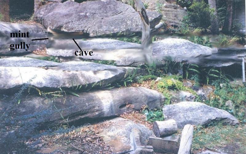

When I started building the SaTR, the first problem was to negotiate the big sandstone ledge. This is how it looked before I started: I finished up needing 4 bridges on this section.
The first was across a small gap between two of the large rocks, which I christened Mint gully for the plant that grows there. As I was in a hurry, my first bridge was a simple couple of bits of wood.

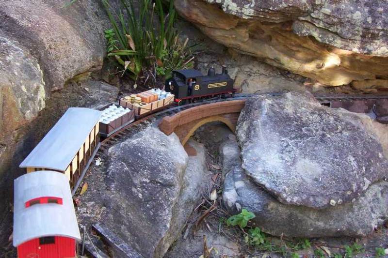

Many years later I got around to building a stone arch from Hebel lightweight concrete. It’s only about 40cm long but since it’s on a 1m radius curve I first had to cut the 60x20x20 cm block to fit into the gap, then cut the 1m radius curve, and then cut the arch out. For more info on using Hebel or Thermalite in UK, see my webpage here: http://www.members.optusnet.com.au/satr/hebel.htm
Here’s a train about to enter the ‘cave’. The parapets are cut separately from Hebel (very carefully – it’s fragile stuff when thin) and glued on using silicone.

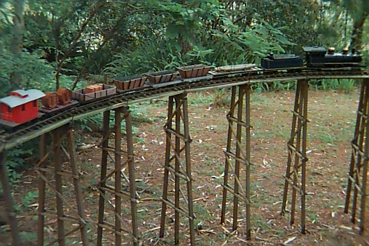

Now the track had to turn back on itself, so I decided on a curved timber trestle, made from 25mm x 25mm hardwood tomato stakes. At the time I owned one loco – a Bachmann big hauler and had no idea what minimum radius to use for the curve. I could most easily build the bridge on a 75cm radius so, much to my future regret, that’s what I used. The Big Hauler seemed OK on this radius. (I was building my own track too.) The track is also on a 1:25 grade. I even turned the posts on my lathe to a ‘rough round’ to simulate tree trunks.
Here it is on opening day in 1994.

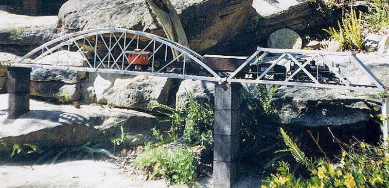

As that pic shows, it lead onto a steel arch bridge and then a timber truss. (I’ll return later to the replacement of the trestle on a larger radius.)
The steel arch was made from some leftover steel from an above ground swimming pool, 25x25mm steel angle and 6x3mm flat steel for the hangers. As I pop-rivetted each part I dunked the parts in ‘Kill Rust’ paint so there was a good covering at joints. There has been no rust in over 20 years.

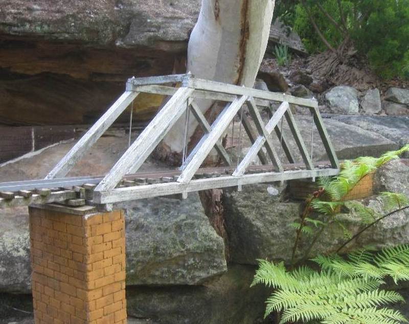

The 1m long timber truss is made from 25mm x 25mm tomato stakes. I took the easy way out and made all angles 45 degrees. The vertical tension members are 3mm threaded steel rod so they can be tightened to the correct tension to hold the whole thing together. There’s no glue. I tested it by standing on it before installation. It’s still in service after 24 years.

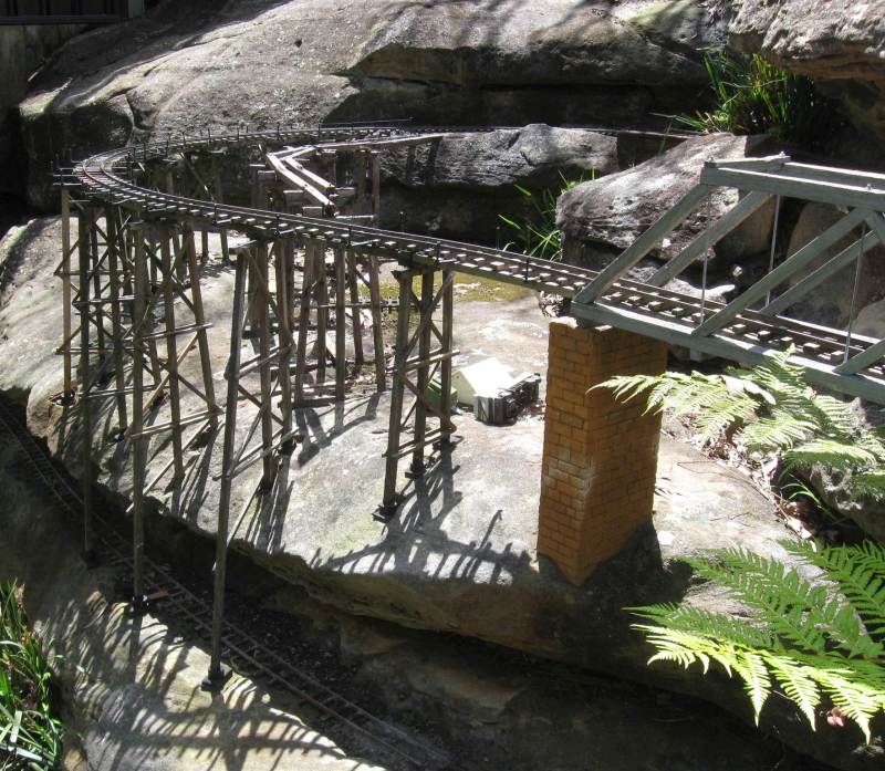

After 6 years of trying to run longer trains around the 75cm radius curve, up a 1:25 grade, I decided it was time for a deviation. By building a new trestle using posts up to 1.2m long, I could get a 1m radius. I reused the arch and truss bridges but in the process I ‘transposed’ their locations.
These pics shows the before, during and after alignments.
This time I used 20mm x 20m tomato stakes so they look more slender.
The old trestle was ‘saved’ by the local Historical Society, but with no funds to maintain it, it is slowly falling apart.
This pic illustrates the new arrangement of the truss and steel arch bridges and the curved deviation cut into the rock.
This pic shows the long posts I needed to get the 1m radius. Any larger radius would have needed posts down to ground level. It also shows how very difficult it was to layout the new curve ‘in mid air’ on the 1:25 grade, with no level ground underneath for a reference.

This shows that the tree is leaning onto the truss. I have removed the bark on a couple of occasions to give clearance, but ‘soon’ I will have to replace the bridge – maybe just turn it upside down.

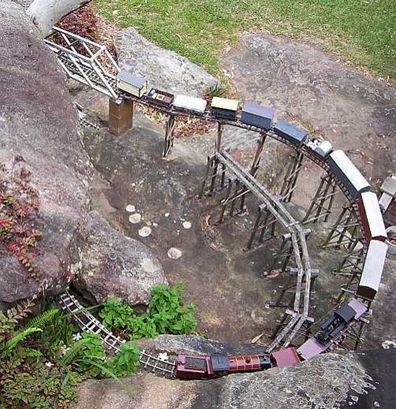

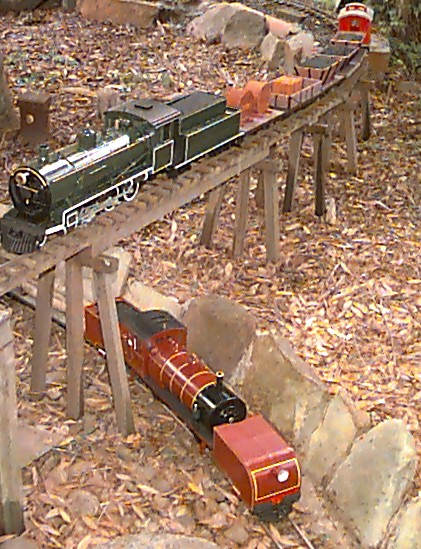

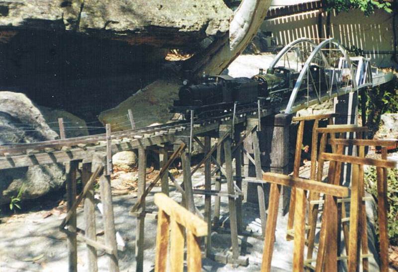

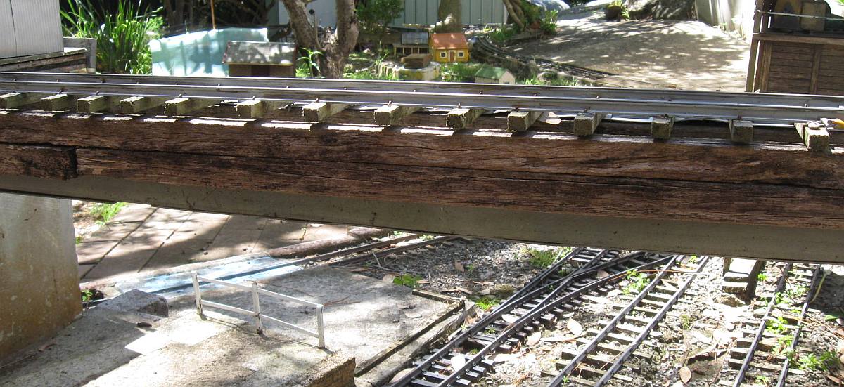

So after my success with tomato stakes trestles, I used a small one here.
The tomato stakes were driven into the dirt and guess what? They rotted away! So a replacement was required. As in the prototype, part of the trestle was infilled with dirt to make an embankment and a steel girder constructed.

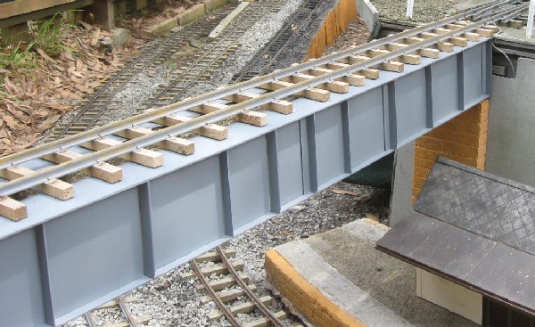

Actually this is still the same tomato stake stringers, but covered with a styrene ‘girder’ 1m long. It has not proved as successful as I hoped as it is too fragile and is damaged by possums (and clumsy feet stepping over it !) When and if I replace it, it will be solid timber inside covered by the styrene girder.
The old stringers under the styrene.

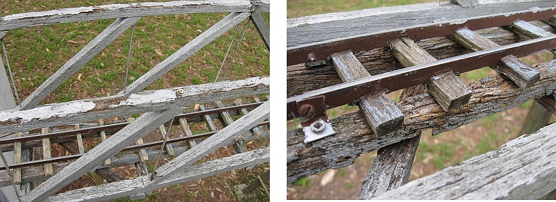

The truss is similar to the first one, but used the smaller 20mm square tomato stakes. These proved less durable than the larger ones and are rotting (after 20 years!). It is one panel longer than the other truss at 1.2m, but uses the same 3mm threaded steel rod for tensioning.

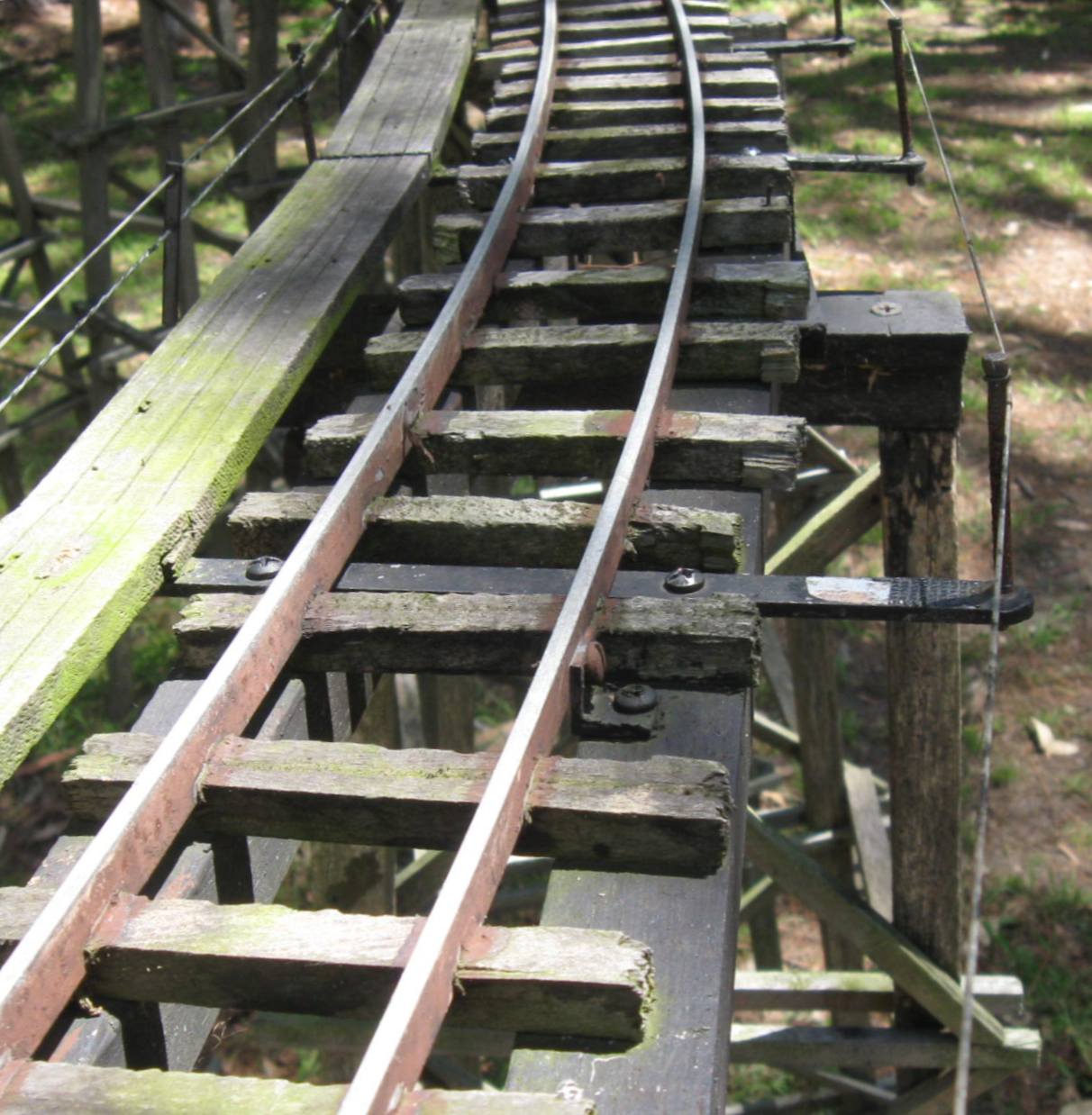

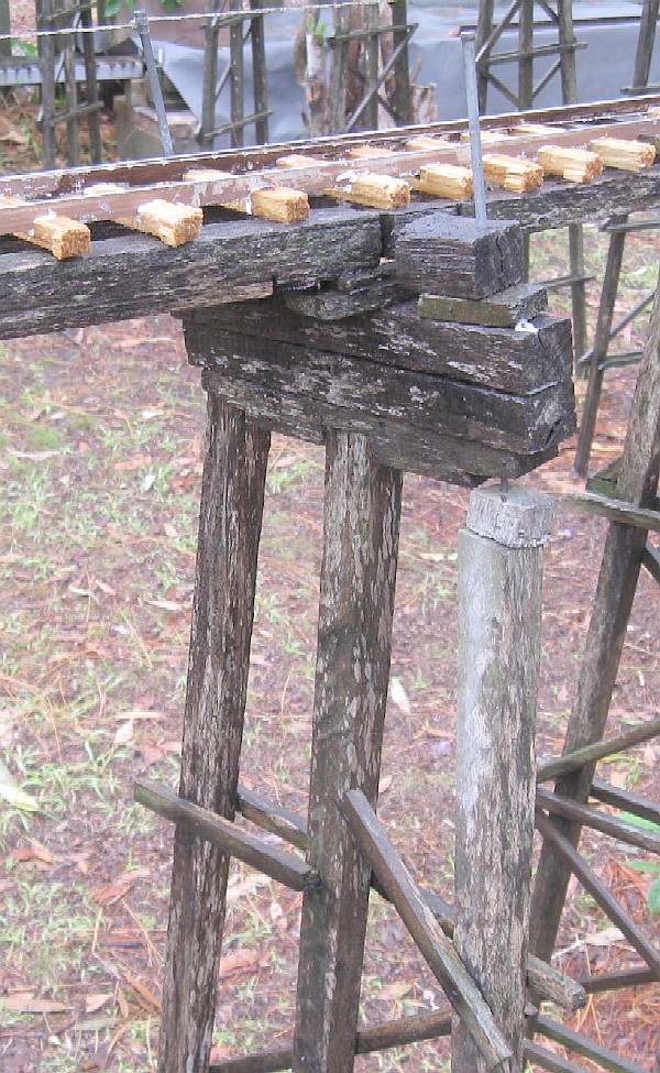

Rotting of the horizontal parts is becoming a problem as you can see here.

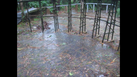

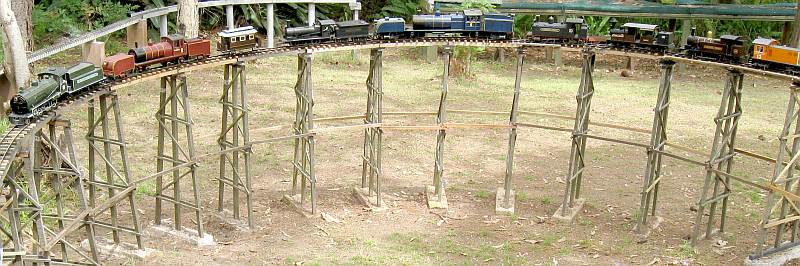

The big Horseshoe trestle.
Because I now needed a curve, it was back to timber trestle type for the biggest bridge on the line – 7.8m long. This time I had space for a 1.8m radius and needed a 1:40 grade to ‘head for the ‘ground’.
I stuck with the tomato stakes trestle, pounded into the ground method. Big mistake again – but it was quick, if quite complicated to pound them at at the required angle to form the bents. I marked out the centre line of the bridge on the ground, just using a centre peg and string. I started by pounding the centre, vertical post in to the correct height, then on the ground, measured out from it the distance to each of the sloped posts. And pounded them at the angle to give the required separation at the top.
There are 17 bents ( =51 posts), about 45cm apart. Along with the top plates and stringers, I must have used around seventy, 1.8m stakes – the nursery man must have thought I was going to grow LOTS of tomatoes. The cross bracing is the same 8mm thick treated pine I use for sleepers. The bents were pretty wobbly till I added the top stringers and the track – then it’s solid as rock. I did not paint or treat the timber in any way.
This gives a view of most of the bridge.

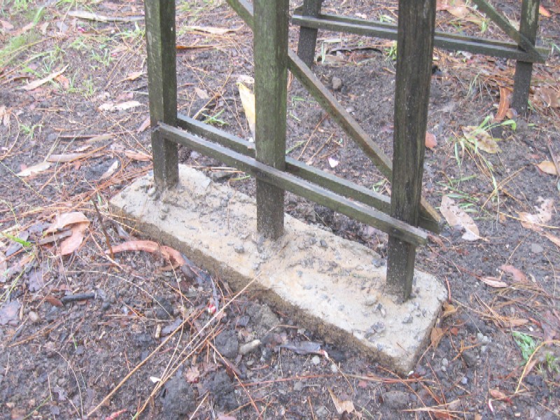

Within 10 years most of the stakes had rotted off at ground level, so I started pouring concrete foundations around them. Using a bolt together formwork and quickset concrete I was able to do 8 in a day. (10+ years on now the posts are rotting inside the concrete, so maybe I’ll have to increase the foundation height. Given enough time they will be concrete piers to the top :-) )
In addition, the horizontal bearers and stringers had started to rot so some of them needed replacing so a major refurb was done in 2013. Here’s an example of the ‘rot’.
work in progress
Load testing of the finished work. I added some horizontal bracing halfway up the posts. And I painted all the horizontal surfaces of the bearers and stringers.
I wanted ‘fences’ to catch any derailments, so I got my mates to bring their longest wagons and locos around and I marked the max overhang, so I could make sure the fence was far enough from the track. 10x3mm aluminium bar (my old rails) were used for ‘outriggers’ to get the fence far enough out for clearance.
The completed work with new access walkway and fence. The fence is just 75mm nails and fishing line, with some styrene spacers.
work in progress

That big trestle is soooo impressive Greg. I can understand why you didn't paint it but I am surprised that you didn't use creosote or similar preservative on it?
- Posts: 7931
Re: Bridges of the Sandstone & Termite
It's amazing that your wooden bridges have lasted so long without preservatives of any kind. I used to think that your part of Oz was fairly arid until you recommended a video to me showing the development of the Sydney sewage system which has to cope with more annual rainfall than London.

I think I did 'dip' the ends in creosote - probably should have soaked them more. Can't use creosote now.philipy wrote: Wed Nov 07, 2018 6:35 am That big trestle is soooo impressive Greg. I can understand why you didn't paint it but I am surprised that you didn't use creosote or similar preservative on it?
We do get lots of rain sometimes. The runoff from 2 neighbours' yards finishes up running under the trestle...ge_rik wrote: Wed Nov 07, 2018 8:19 am It's amazing that your wooden bridges have lasted so long without preservatives of any kind. I used to think that your part of Oz was fairly arid until you recommended a video to me showing the development of the Sydney sewage system which has to cope with more annual rainfall than London.![]()
Greg from downunder.

Just a couple of more pics to 'finish off' the trestle story.
Here's me beside the trestle 21 years apart. The shirt and my hair seem to have 'selectively' faded in the latest pic.
Kookaburras find it a useful lookout place for finding worms.
