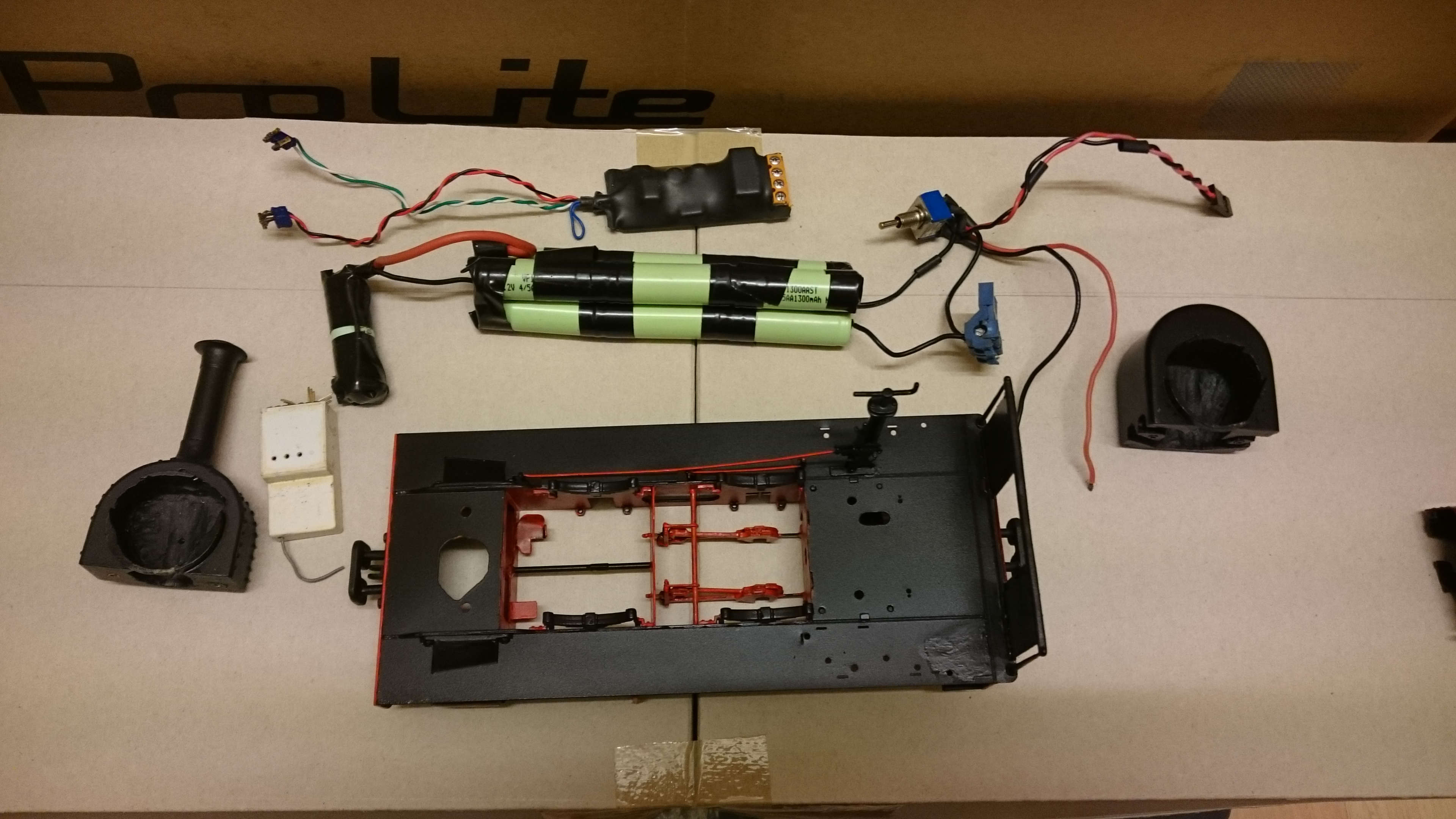

The pictures:

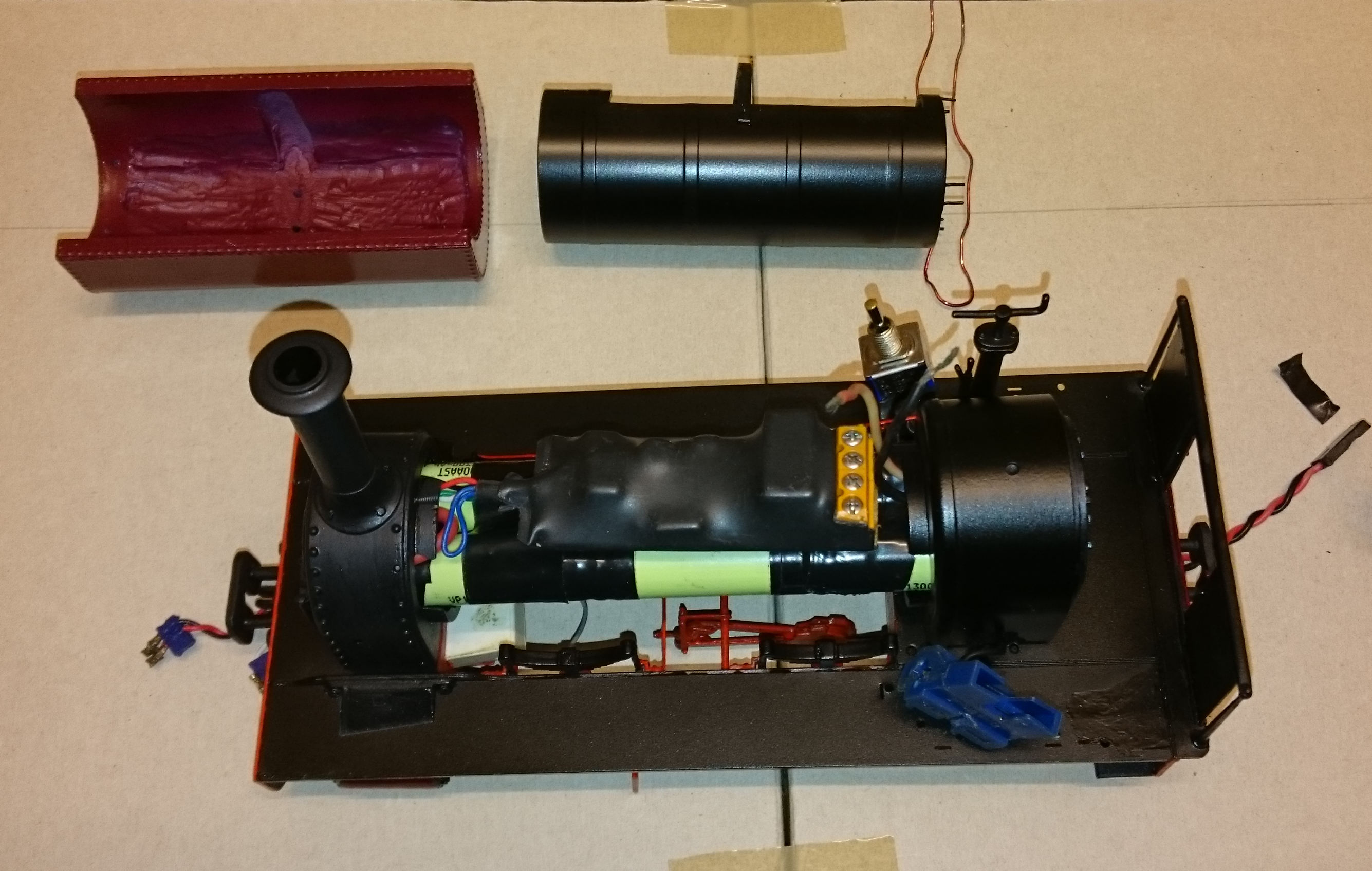

General overview of R/C components:
Top, speed controller (leads for reciver power and throttle channel to left, terminals for battery input and motor output to right)
Middle, Battery pack and wiring (l to r: 10th battery, 3*3 batteries, fuse holder and DPDT switch, wires to speed controller, charging lead with Servo type connector)
Left, Receiver (white box, replaced original folded film box with styrene stepped box (to fit through front frame stretcher))
Far left, back of smoke-box casting (originally solid)
Far right, back of fire-box casting (originally solid)
Bottom, loco frames (hole in front (left of image) for 10th battery and receiver wires to be threaded through smoke-box and frames, hole in rear footplate (right) for motor and charging wires).

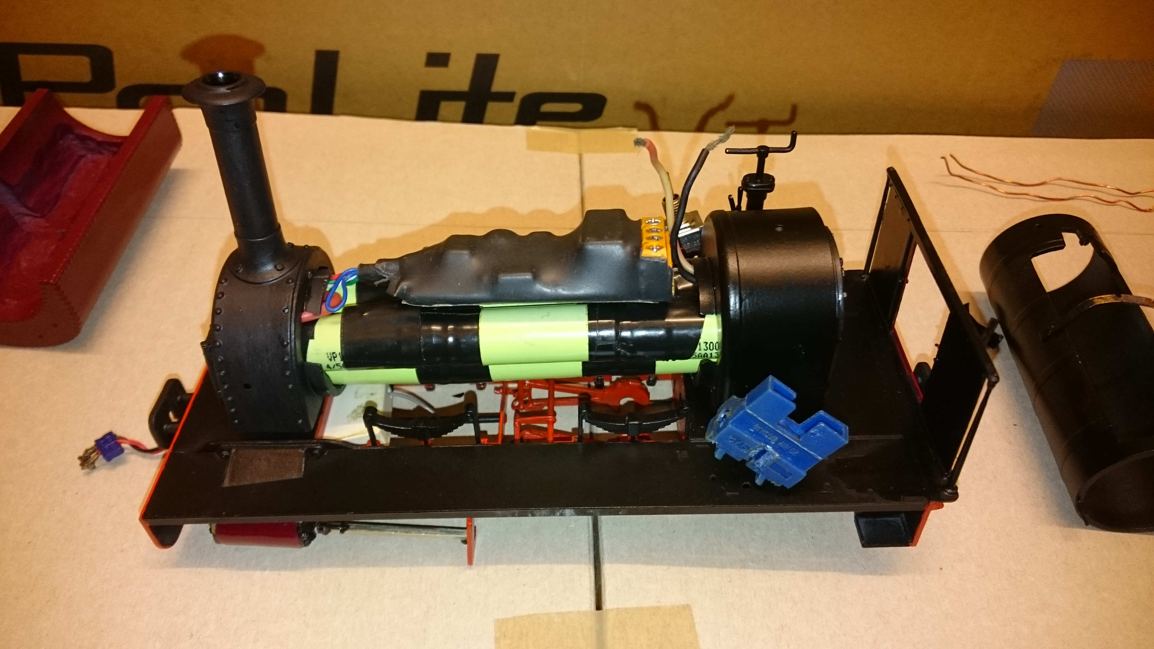

Overview of components in place (without boiler and tank):
Top left, inverted saddle tank showing void carved for speed controller
Top right, boiler barrel with top section removed to connect space in boiler and tank for speed controller.
Left side:
Right side (reach rod and reverser stand had to be cut back to allow the switch to be threaded into position):
NOTE: Fuse holder and DPDT switch sit in bunkers.

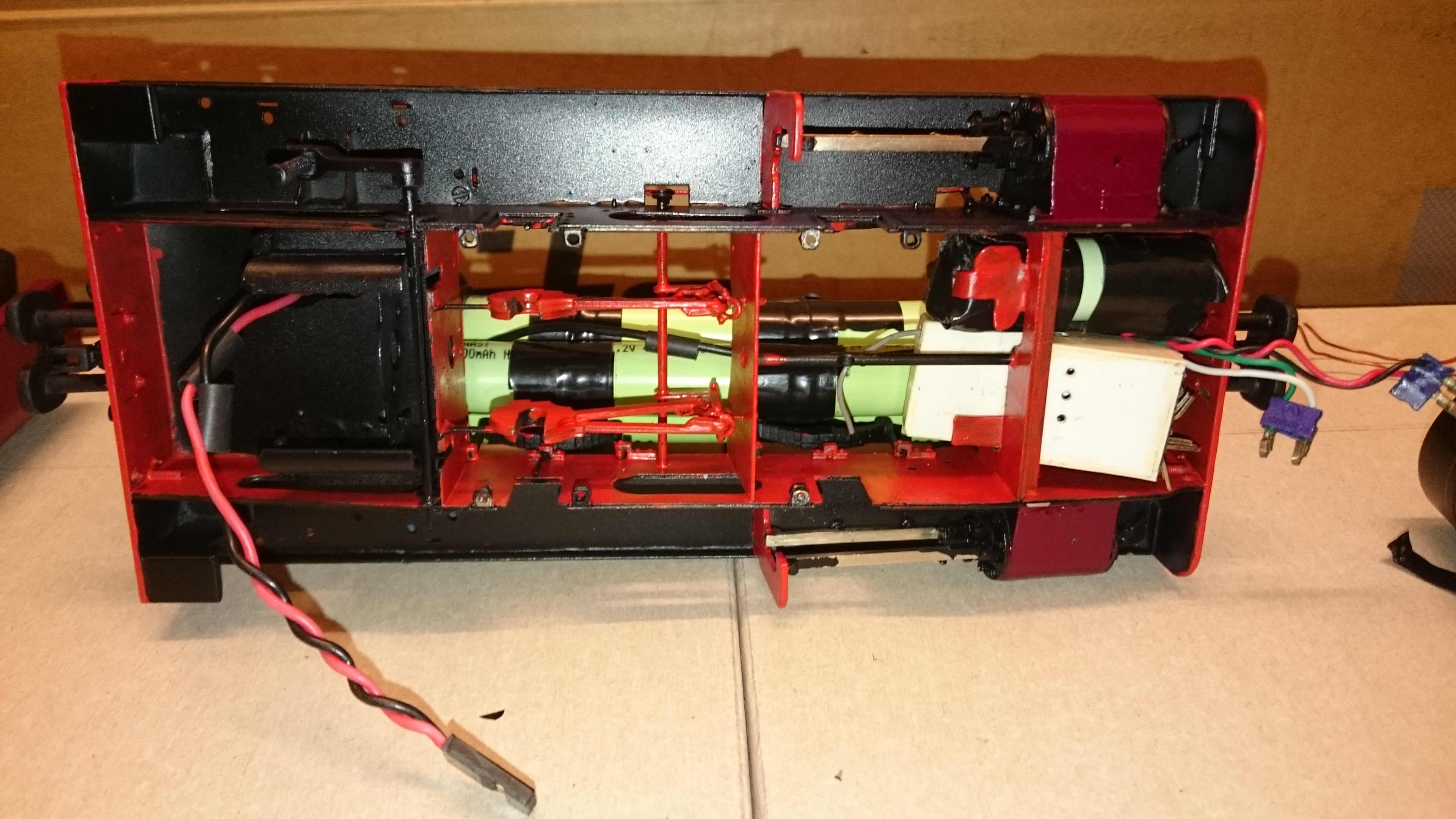

Hole cut in front frame stretcher for 10th battery and receiver (seen from rear):
Underside of frames with 10th battery and reciver:

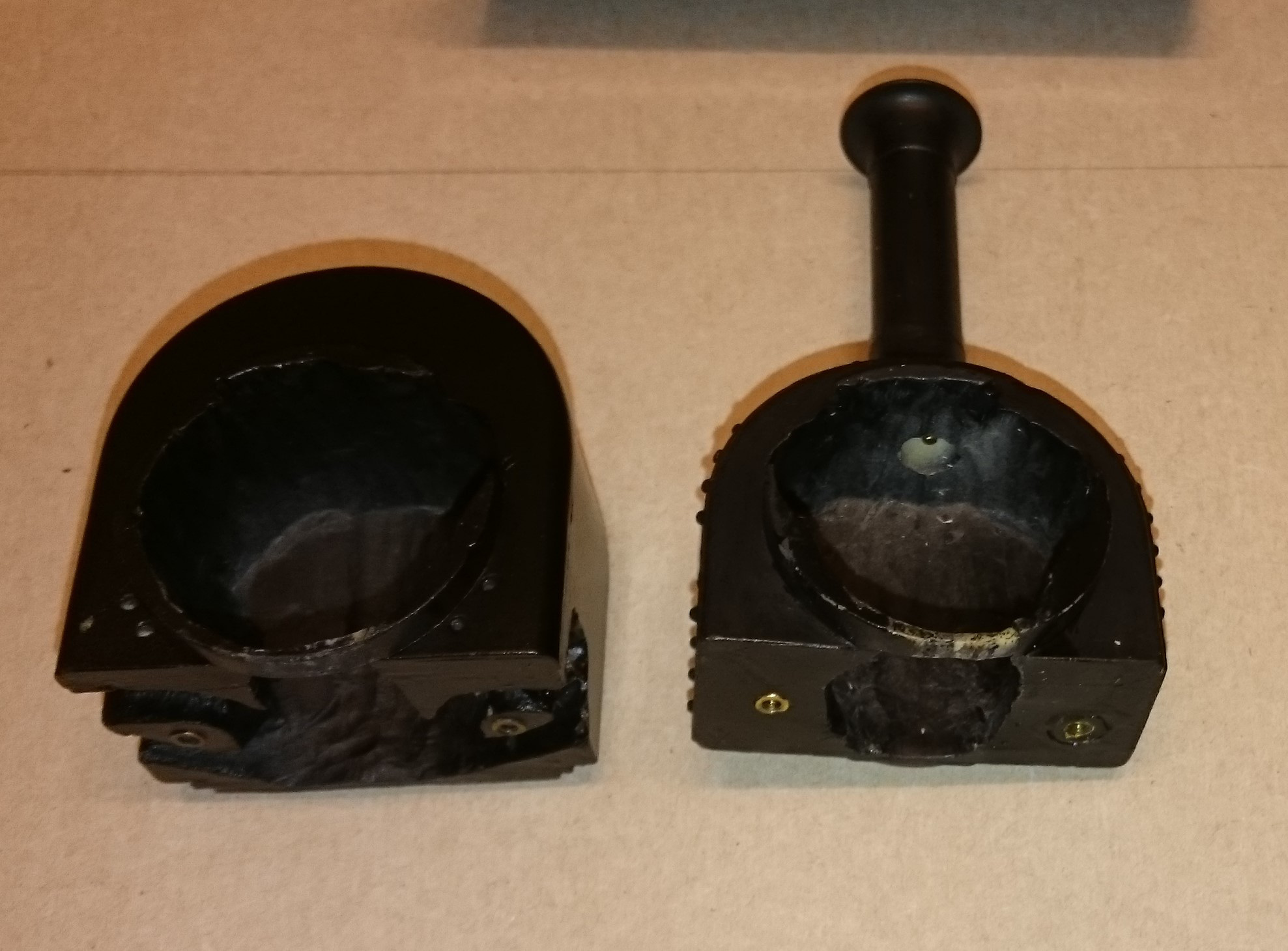

Closeup of modified fire-box and smoke-box (NOTE passages cut in underside of fire-box to allow wires to pass to bunkers (all wires pass through boiler, smoke-box and fire-box)):

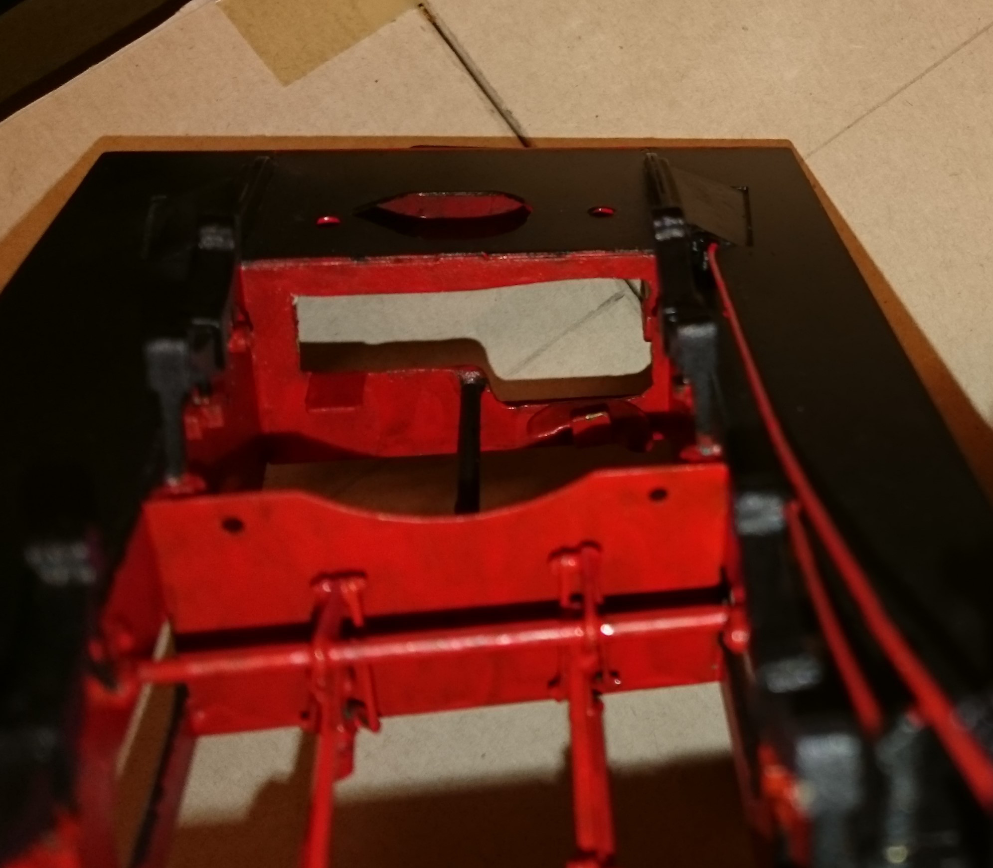

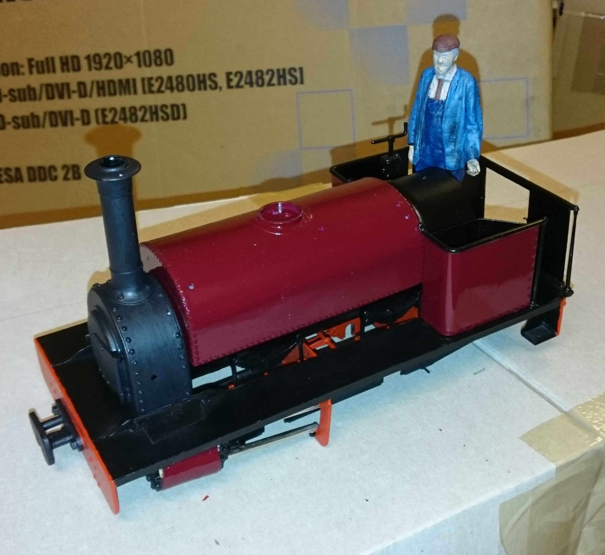

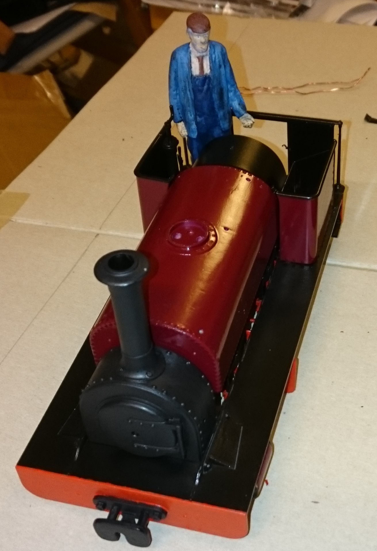

Work in progress (disclaimer; no R/C components fitted for these pictures, getting all the wires and components to lie correctly for it all to fit takes a bit of poking and fiddling around):
Current state is that nearly all the base colour is done, just (JUST!!!!) painted details to add then weathering and overcoat of satin to tie it all together visually (currently too blocky and shiny).
Left side:
