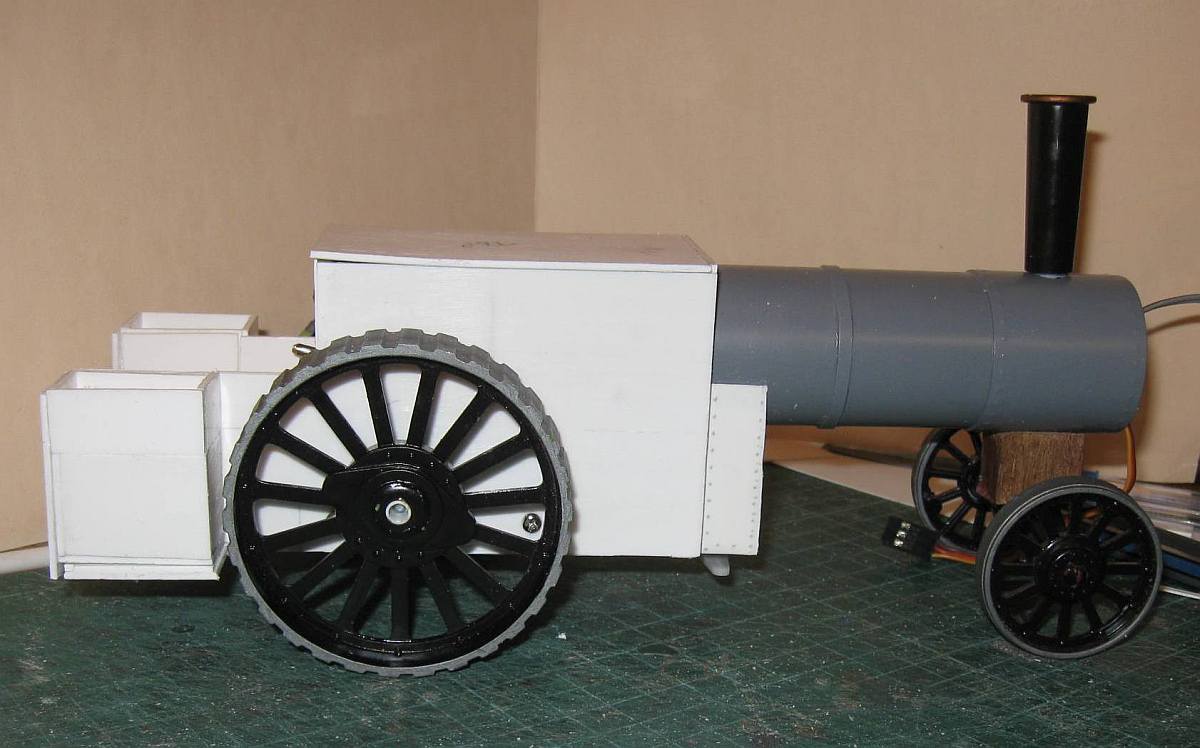

But I’ve bent my rules again and decided to build a radio controlled (road) traction engine.
Maybe I can drive it around the loungeroom? But it would be nice to see it trundle along Lilyvale’s main street. To do this it will need to be able to have a turning circle of max 30cm.
If all else fails I can mount it on a flat car.
Making the wheels has always been the impossible sticking point for me, but when ge_rik mentioned he had a simple model he didn’t need, I took it off his hands.
It turned out to be too small for me to put RC in, but I used the wheels and started from scratch to build the body.
I had an old solid vacuum cleaner hose 36mm dia and it looked right for the boiler. I also had a Tamiya motor/gearbox, I’d bought long ago but was too wide for a 45mm gauge loco. It seemed the speed would be slow enough for a traction engine, even with it’s large dia wheels.
So I started the design, based on the parameters of
• boiler dia 36mm
• Wheels 90mm dia
• motor dimensions of 75mm long x 30mm high x 35mm wide
• and needing four AAA batteries.

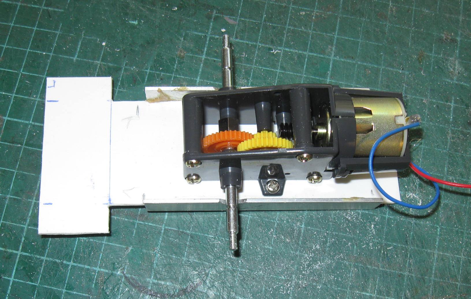

The main ‘box’ (what else can I call it?) contains the motor with the boiler above.
The motor is screwed to a base of 1.5mm styrene with aluminium angles to allow it to be screwed up into the main ‘box’, which is hollow. The top of the box is held on by magnets. The boiler contains the hobbyking 2.4 GHz receiver and I’ll use my own design Picaxe controller for :
• speed (using the Picaxe PWM command and a FET),
• direction (5V relay with DPDT contacts) and
• steering (Servo, using chains to the front axle).
All this is inside the boiler and will pull out of the from smokebox.
The batteries are four, NiMH AAA 900 mAh cells mounted under the floor of the driver’s standing space.
I don’t think I can find space for a speaker, so there will probably be no sound system.
Here it is roughly put together to check how it looks.
I've now got as far as getting the RC electronics to work so I can test if it will really work and if I should continue.
This video shows the progress so far - the basic body shape, undercoated but no detailing
It also shows test driving it around Lilyvale main street which is the purpose of the whole exercise.
https://youtu.be/TrooWm2IwOo
There are 2 problems:
1) the horrible gear noise (how come I never noticed it before?)
2) the steering - the front wheels don't have enough grip. I think I need more weight over the wheels but have little space to fit any.
I have tried putting a couple of rubber bands around the wheels and that has helped enough to convince me I can somehow over come the problem. It can actually turn the sharp corners of the street which was my main worry.
I have even managed to test the idea of programming a set sequence to run it over a set route without my driving it. (So I can drive my train and have the traction engine trundling along the street in the background.)

Great looking transformation, Greg. If anyone can program a Picaxe to control her movements up the street, then you're top of the shortlist. Maybe you'll have to fit sound, to mask the gear noise
- Posts: 6051
Re: Building a radio controlled (electric) traction engine
Looking good so far Greg - like the way you ran across the grass whilst turning!
As for the weight on the front wheels, it looks as though the front axle is mounted to a block of wood under the smokebox, currently? Could you cast a block of lead to do the same thing?

I've never tired casting lead. But it's a great idea - maybe I can fabricate it somehow.philipy wrote: Sat Apr 21, 2018 7:48 am Looking good so far Greg - like the way you ran across the grass whilst turning!![]()
The plastic chimney is hollow, so it's another possibility to be filled with lead.
Maybe some lead sheet around the motor would reduce the noise too

Sunday update.
I managed to bash a bit of lead into a cylindrical shape which gave me 20g in the chimney. Then 25g under the electronics board and a circular piece of 25g glued on the inside of the smoke box door. A great improvement, even without the rubber band tyres.
I also rewrote the picaxe program so the steering has a delay and now takes 1 second to go from centred to full right or left. Looks a lot better.
And I reduced the max angle of turn of the front axle from 45 degrees, and can still get it to turn within a 70cm dia circle (measured over the outside wheels).
So now it's time for a bit more modelling of the details like cylinders - I've decided they will be static. And the roof.
[Don't you hate it when you make a model and show to your wife trundling around the floor and she says " that's cute - but what is it?"
