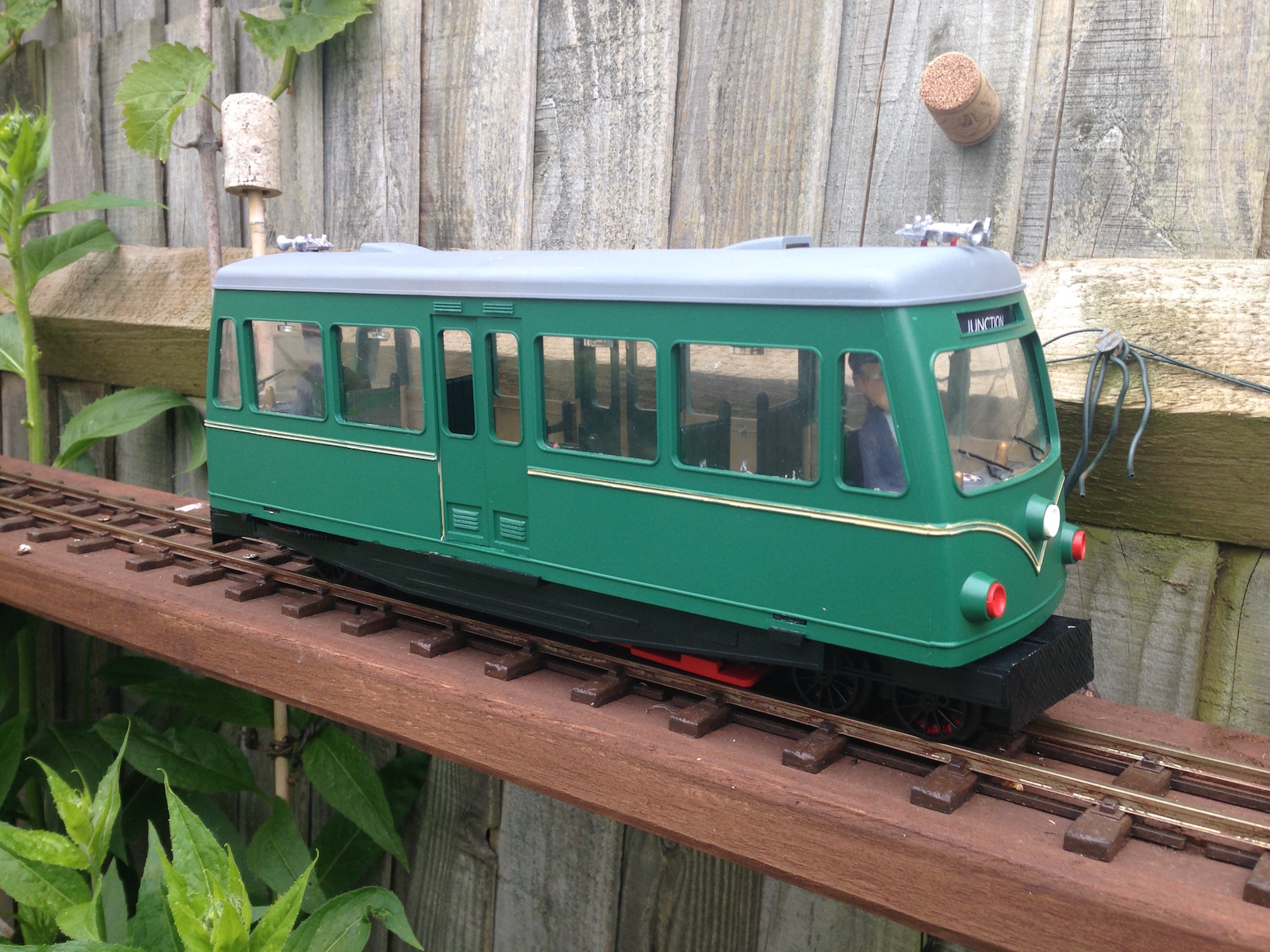

My faller has also been taken out of service recently after doing the easier refit earlier this year (repaint etc) - come to the same conclusion it needs a proper power unit and RC for my e2e line - it is lined up for my Christmas hols loco works job
Here's it earlier in the year ex-works

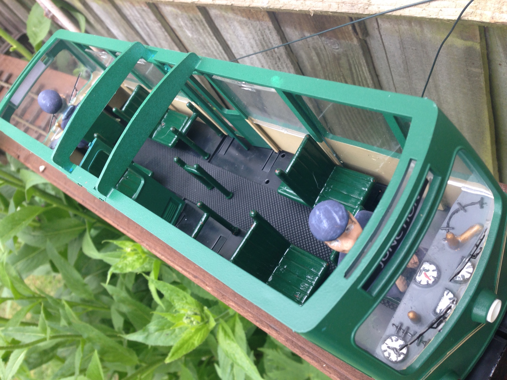

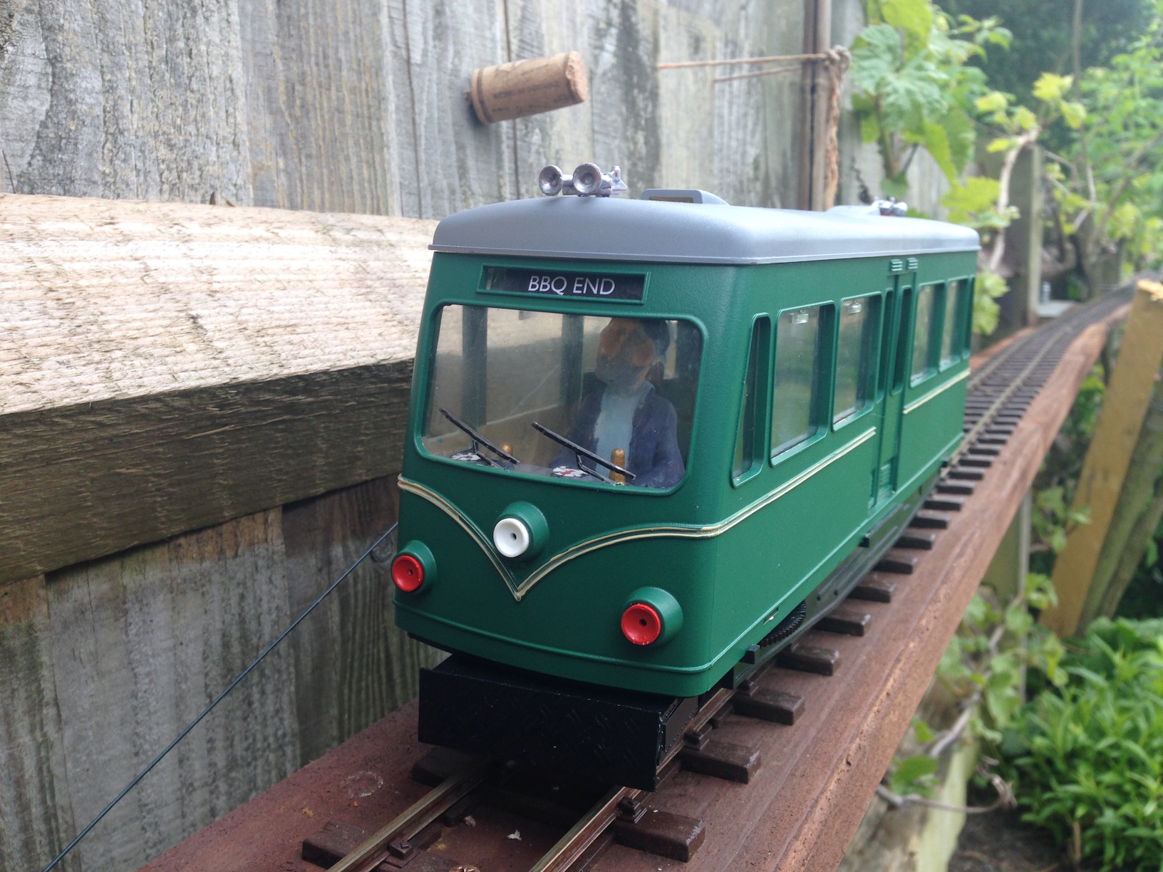

Jim, I take your point about the bogies, they are pretty horrendous and I thought about changing mine but haven't bothered so far. However, no need to fill it up with batteries, I still have one of the original Faller motors which I assume are nominally 12v ( I haven't checked) but it runs nicely on one 3.7v LiPo. Hobby King do nice flat profile ones and I've got the battery, Deltang Rx, on-off switch and charging socket all in a plasticard housing hidden between the underframe trusses.
PB240001 2.JPG (288.03 KiB) Viewed 14185 times
PB240002 1.JPG (219.21 KiB) Viewed 14185 times

That's a nice conversion that you have done there.
I think yours may have been a battery one originally as the wheels appear to be plastic so it could be a 3v motor.
Did you cut the power bogie down or is it original?

Big Jim wrote: Fri Nov 24, 2017 3:22 pm That looks nice. What power unit are you going to use?
Mmm - thats the challenge Jim- i haven't sorted one yet - umming and arring about using the Swift Sixteen one (and the non powered one ) I was toying with doing something a bit cheaper (remember I originate from Yorkshire) but having seen the coach to railbus conversion in the latest SMT, which uses the Swiftsixteen stuff, the chassis does look a nice job with that unit and the bogie sides you can buy .......where did I put my Santa list??????
Phillip - when I first got it, (as per the photos) it did happily plod around but I do want it to do some regular stopping and the switch thing on the side is hard to operate to stop it - with my big hands I often knock it into reverse, or derail it - so I did try a cheapo -(ex remote car) Rc with it - just forward and back and no ESC - which worked ok but because I had to splice the RC into the feed, I was finding it was now stuttering at times when running on the track (fine when its on blocks) - so I was thinking I probably need more power to run the motor (mines just a 3V battery job) and the RC - so going forward I want more volts in there involving more rechargable batteries as well as getting a upto date RC receiver/ESC (i.e.) Deltang that I can run through my TX20.
I also found as it ran, it wallowed along, building upto wobbling at points - on two occasions when I was operating it RC, the wobbling built up to such a degree that it fell off the track and down into the flower bed - on both occasions no permanent damage but it made my think I could do with some more weight low down - which again will put stress on the existing motor.
Thirdly because my line does have some gradients and some are on fairly tight corners, the current motor was prone to stalling at those points so having more weight and potentially more powered axles may help - I have even considered having two powered bogies but not sure if that would be overkill
I know I will have to sacrifice some of the passenger space to allow the motor in there (Parcels area mi thinks) and probably have a raised floor in part of the space for batteries and RC - I'm thinking I'll build a new chassis to hold everything, including new seating and then let the body sit on top of that (which some simple catch or screw to hold it in place) - however, once i start , sure things will change!

Yes they are plastic wheels and yes I did cut the power bogie down. I also looked at reversing it to put the wheels at approx the same distance from the end as the non-powed bogie, but decided it was too much work!
I can't remember if there was a battery compartment, and my memory tells me I removed pickups but I can't be sure. My non-powered trailer car certainly still has a battery box, but that came from a different source so is no guide.
They do both wobble, especially over points, as Mark said, but havent had major derailing. That horrible reversing lever was the first thing I removed, but I installed a Deltang Rx65b from the beginning and it works well with the Faller motor on a 3.7v battery.
