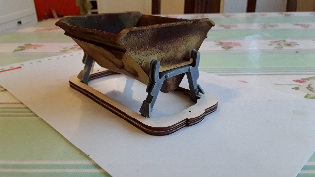

Unlike Tom I've gone for a single build at a time. The body of the tipper was formed from 2 layers of .25mm styrene. Being thin it buckled and bowed giving a very unrigid bucket. I half expected this and lined the lip with piece of evergreen section. Trimmed up it didn't turn out too badly. I'd run a squirt of superglue around the inside edge to give a bit of strength. On adding the brackets decided to hide the fixing holes with acrylic discs. I have decide that if I trim the inside of the tipper supports the bucket won't rock whilst being moved. The bucket has been sprayed with high build primer.
In view of the problems I had with the pva I have used superglue for all wood joints.

Have added some plasticard to the body top and sides to give a more steel effect (hopefully). I have also added some axlebox covers and a few rivets here and there to give a bit of texture. The ends have received a coat of white for number panels so the next stage is to mask and then spray dark grey. The loctite has arrived but need to make a jig to ensure the back to back is central or my axleboxes will be poked out!

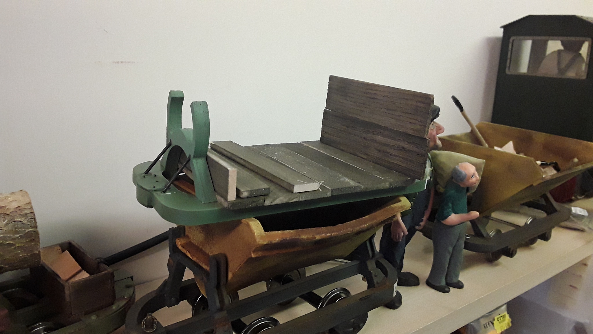

Posted: Thu Sep 28, 2017 8:14 pm
by bazzer42
Not quite finished but getting close. Still need to glue the axlebox frames in and weather them to match the chassis. I feel the next build may use the chassis to build the general purpose wagon I've wanted to do for ages...

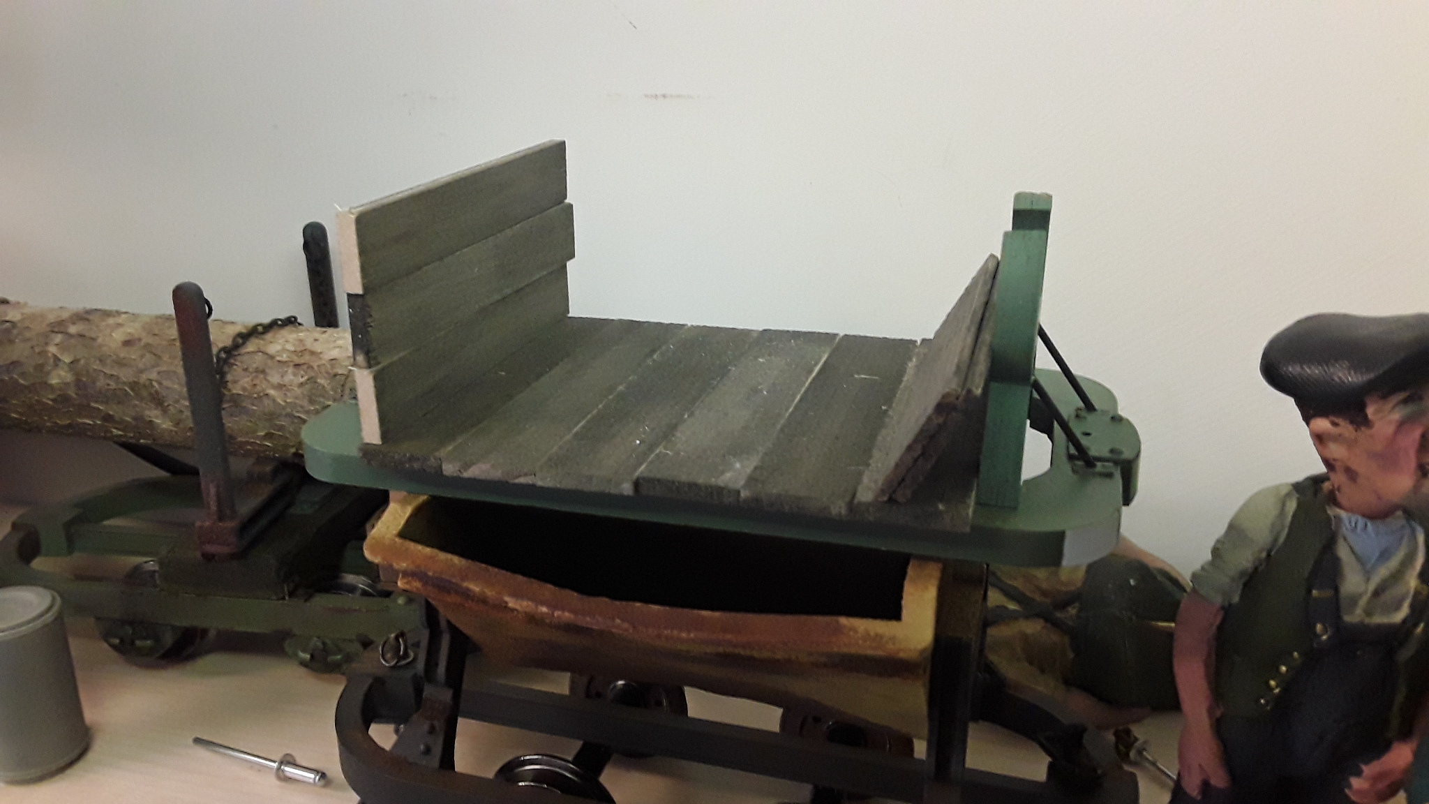

Build 2 is going to be a wagon I've been hankering to do for a while. Bulkhead ends and removable side planks depending on the load. Added some end rods to the tipper supports from 2.4mm rivets dipped in blackening liquid. A fiddle to do and need to fill in around the tipper supports where my drilling got a little enthusiastic.
