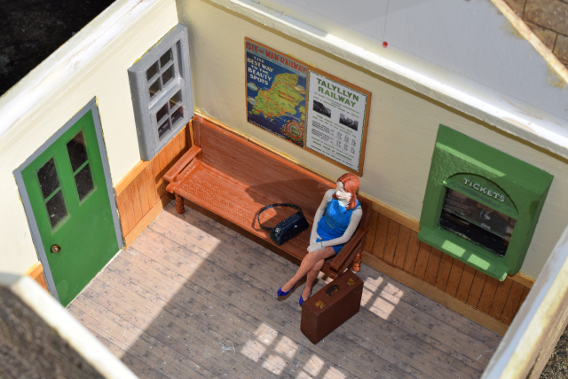

A year or so ago, in my thread on my signal box and junction, and a project growing like Topsy, I mentioned the future plan for a new branch station, to be called Lower Bench. In my current thread on 3D printing I have also alluded to this project, a couple of times. Well now has come the time to unveil the first part, incorporating at least some of the printed items I've posted about, plus a few that I haven't mentioned so far.
DSC_0002 small.jpg (374.85 KiB) Viewed 11145 times
DSC_0003 small.jpg (363.23 KiB) Viewed 11145 times
So; the door, the window, the fireplace, the fire, both figures, the 3 suitcases, the girl's handbag, the waiting room seat and the ticket window, are all 3D printed, as is the gas light which hangs from the ceiling once it is in place. The drawings for the 2 figures and the suitcases I downloaded, but everything else is home drawn.
The floor is 2D printed using a laser printer on self adhesive matt vinyl. The posters I found on the net and again are laser printed on matt vinyl, stuck on varnished 1mm ply.
The wall paneling is 1mm ply with lines drawn on, as is the skirting, and the dado is coffee stirrers. Oh, and the coal scuttle is part of a black silicone sealer nozzle!
More to come in due course. It should hopefully speed up a bit now that I have this detailed interior completed.

Great stuff Philip, I too admire the coal scuttle idea, along with all the other items. It all looks so very typical. I imagine the roof to that building will be removed many times.

Grant, that's an interesting point. It would be nice to be able to remove it, but in the interests of keeping out creepy-crawlies, and much more importantly, water, it will have to be glued very tightly I'm afraid. Although this section is single storey, if you look top right of the first picture you'll see that it sits against the gable wall of a 2-storey section. There is a projecting chimney coming down that wall in the centre, as well, and there is no way I can think of to waterproof a wall-roof junction like that.

I particularly like the suitcases and handbag- very realistic - as much to do with the quality of painting as the 3D printing

Very impressive Phillip, very impressive indeed. I think the floor is one of the most realistic ones I've ever seen. If you'd told us you'd sliced up coffee stirrers up for floor boards and tacked them down individually I would have believed you from the photos' :thumbup:

I did a google search for something like "Victorian floor board pictures" and then went through the results until I found something like I was looking for. Then straightened the parallax in a very old version of PaintShopPro, cut out the best/most even colouration selection of boards and multiplied them side by side ( look for the repeat pattern) to fit. I did adjust the colour slightly because the original was a bit more golden brown than I wanted. Then as I said, it was simply printed, using a laser printer, on self adhesive vinyl sheet ( i.e sticky back plastic - do I get a Blue Peter badge?? :lol: :lol: )
