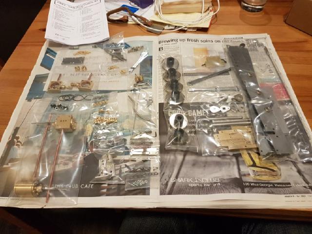

First things first, I'm a long way from having a railway of my own, living as I do in a small rented apartment in Vancouver, but I had been planning on a loco purchase for a while ahead of my visit home to the UK. Two weeks before I left Vancouver, I had the opportunity to pick up some unbuilt Brandbright kits, so my 'workbench' currently looks like this:
Not a bad problem to have, but I'd better get cracking! (On a side note, note also the bar of English dairy milk in the background. To be rationed as long as possible!)

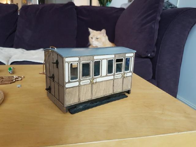

Just realised I've not put a pic up of the finished body. Will do so when I get home from work.

Finished coach body, awaiting wheels:
And now, this!

That coach is as pretty as a picture Ted, you should be well pleased with a thoroughly professional job there.
PS your cat seems to be taking a rather dim view of things!!!
