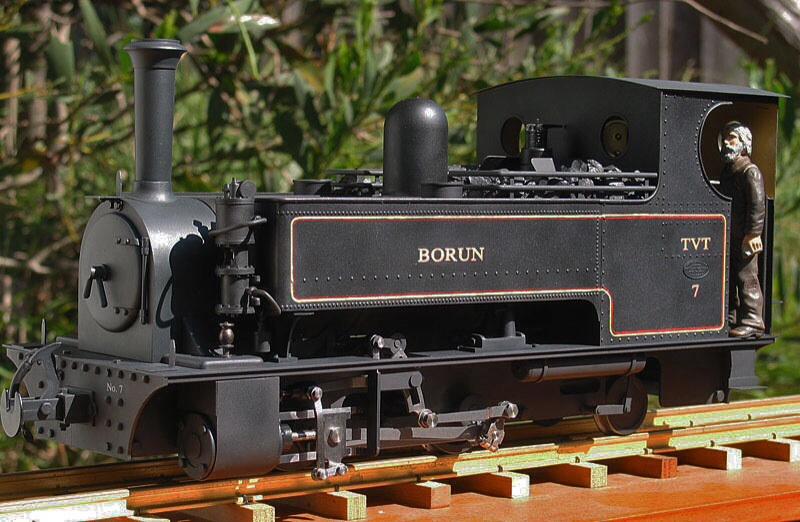

I use Humbrol gloss enamel straight out of the tin and do the lining with a bow pen. I've found enamel works better in a bow pen if it is applied to a gloss surface and isn't thinned. Thinning lowers the surface tension and the line tends to spread out. The same happens on a matt finish, even if the paint isn't thinned.doublereefed:122475 wrote:However, I'm stumped on what kind of paint to use. The RH standard gloss paint seems difficult to get anything to adhere to.
I have a tubular pen similar to the Bob Moore pen, or the Easi-Liner, but haven't used it for a while. I find the bow pen more flexible to use, as it can be adjusted for a wide range of line widths. With the tubular pens you need a different pen for every line width.
I haven't lined a Roundhouse loco, but haven't had any problem getting enamel to stick to their paint when over painting. Roundhouse use a two part paint which is very resistant to solvents, so if lining goes wrong it can be easily wiped off with thinners, without any damage to the paintwork, before starting again.
Any lining and lettering needs a clear finishing coat to protect it, otherwise it starts wearing off in areas that get a lot of handling.
Practice lining with whatever pen you choose on a piece of metal painted with well cured gloss enamel, until you get the hang of it. Start with straight lines and work up to corners.......
I use a 6" plastic ruler for straight lines, with a couple of thin spacers stuck on the bottom surface to space the ruler up far enough that paint can't creep under it and then do the corners free-hand with a brush. You can make up templates out of plastic sheet (again with spacers) to use for lining. this lets you do the straight bits and the corners in one hit.
Another technique I've used in smale scale is to draw out the lining on clear waterslide transfer film with the pen and then apply the transfer to the model. Might be a bit unwieldy on a garden scale model, but useful for small areas.
There are several good books from the UK available about lining small scale models. The technique is much the same for larger models.
Ian Rathbone's book is still in print.
https://www.amazon.co.uk/Modellers-Hand ... 1905184549
There are photos of a couple of my lined models below. I'm no expert, as I don't get a lot of practice, but I'm happy with the results.
