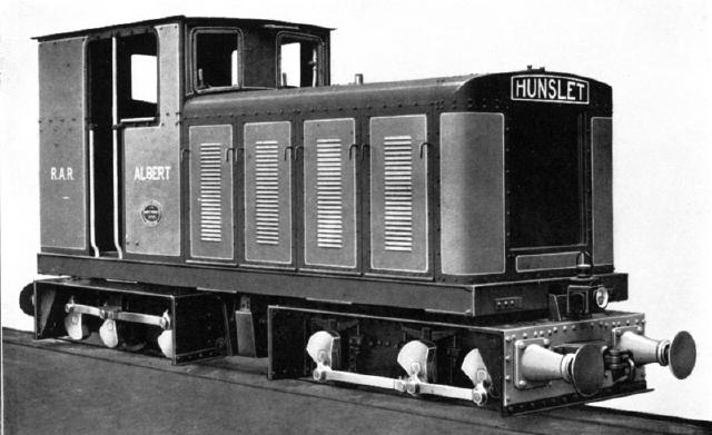

-steves-:119806 wrote: Not sure what you been by the "2 mechs" part, could you explain it for me.
This is a builders photo of a Hunslet diesel from the 1930s, used on the 18" gauge railway at Woolwich Arsenal. The bogies look like two small diesel chassis. The loco is a B-B, not a C-C, the end cranks are on a layshaft and are part of the drive mechanism, not a third axle.
Using two 0-4-0 mechanisms and some weights with a single body gives you a large diesel with more power for longer trains, or for hauling dead steam locos back home.

Loving that Hunslett, I have 2 smaller chassis that could be easily adapted to take a drive lay shaft and I pretty sure I could knock up some soft of extra shaft and bearings as I have done this before, my problem generally comes with the accuracy of the holes in the chassis compared to the additional crank length and it then not turning properly :( I am sure I have some metal that I could practice with, well thats potentially another 2 chassis taken care of, I think that only leaves one or two now :)

-steves-:119837 wrote: Loving that Hunslett, I have 2 smaller chassis that could be easily adapted to take a drive lay shaft and I pretty sure I could knock up some soft of extra shaft and bearings as I have done this before, my problem generally comes with the accuracy of the holes in the chassis compared to the additional crank length and it then not turning properly :( I am sure I have some metal that I could practice with, well thats potentially another 2 chassis taken care of, I think that only leaves one or two now :)
Personally, I wouldn't bother adding the layshaft, as a 2' gauge loco would have more space between the wheels for the final drives and unlike an 18" gauge one, may not need a layshaft.
There were some 2' Hunslet diesels in South Africa that had similar bogies, but without the layshaft. You'll find a photo near the bottom of this RMWeb page.
