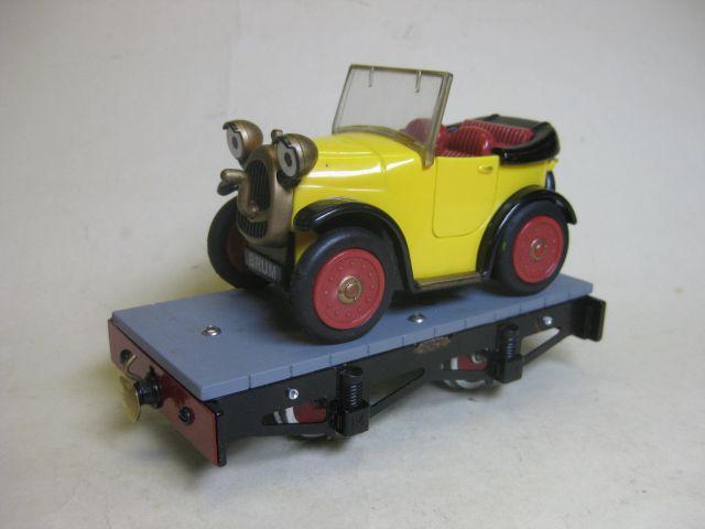

Mamod based wagon originally a log wagon with a 'Brum' plastic toy as a load. A pair of Mamod buffers have been modified to act as centre couplings.

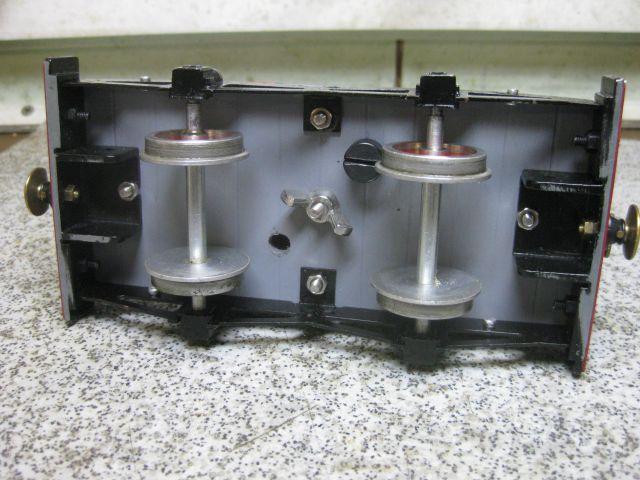

With this wagon the load is held on with a wing nut so it can easily be removed so a camera can be fitted.

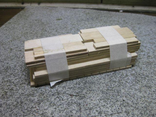

Only a few Mamod based wagons have been made as even second hand they are quite expensive given the large numbers of these wagons that we use. So a wooden wagon was made the same size and the same coupling height as the Mamod version. The design is simple and uses only one type of wood 1/8" modelling plywood.
This plywood was cut to size on a circular saw which uses a cars 12 volt window motor for power.
Usually enough plywood is cut for up to 10 wagons which are assembled when needed. There is enough cut plywood for 5 wagons here.

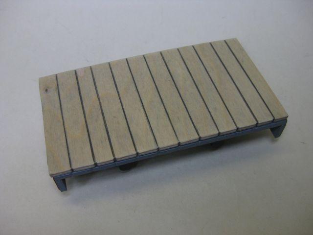

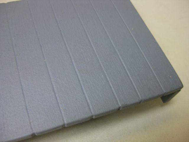

To simulate planking the plywood is scored with a Biro and the sides nicked with a file.
When painted the planking looks fairly realistic.

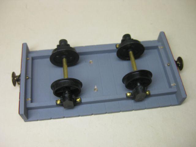

Over the years many different axle boxes have been used but in recent years the Binnie Festiniog 2 bolt wagon axle box has been used. The axle box has been drilled so that it can be attached to the wagon's sills.
A wagon with the usual 24mm wheels fitted in this case also a Binnie product. The axle boxes have been cut down for the narrower sill used.
Up until quite recently I have had enough Mamod buffers to make into couplings along with red painted buffer beams.

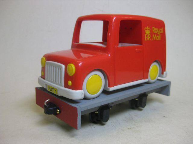

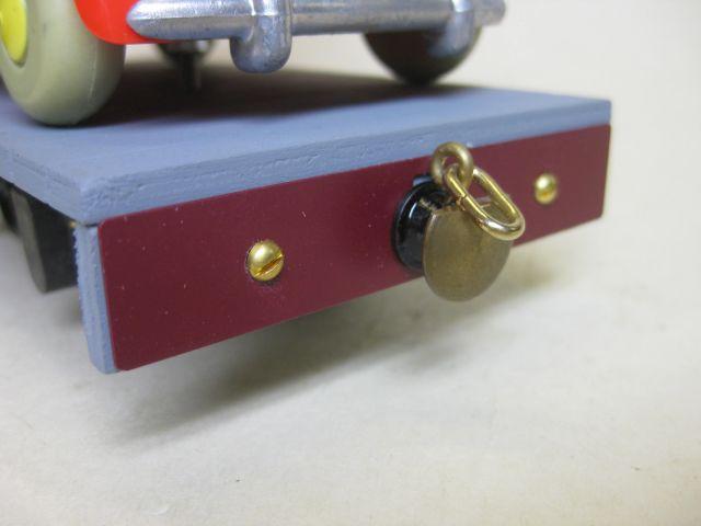

This is the wagon just completed with Postman Pat's van as a load. The wagon uses 16mm wheels and as I have run out of Mamod buffers it has modified Binnie Bumper Carmarthen couplings on a painted buffer beam.
All of the last 10 or so wagons made I have had to buy new all the fittings which goes a bit against the grain. The gift of Binnie wheels kept the cost of three of them down. I know that some people don't like using plastic wheels but I have used many and not had any problems with them. I have wagons 25 years old running on old Hornby plastic wheels, there are some Playmobile as well. I think if you want to make inexpensive wagons and have to buy new: axle boxes ,wheels, axles and couplings using Binnie products the cost of the hardware for one 4 wheel wagon is £5. The plywood and the screws possibly add another 0.50p, I have no connection with Peter Binnie but I do use his products that I find good enough for the job they do.
