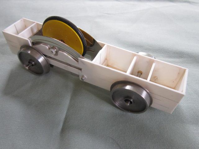

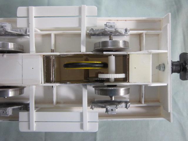

Well, it's been some time since I bought my 'Zecar' and things have gone very quiet on this thread, but at last I have made mine into a working vehicle.
The wheelbase has been extended with a plasticard frame and metal wheels fitted. The driven axle running in its own original bushes and the trailing axle in brass. The axleguards are cosmetic and have no contact with the axles.
The finished vehicle is a goods van which can be run with any train combination.
Further build details can be found on my 'Time to build a railway'... thread.
