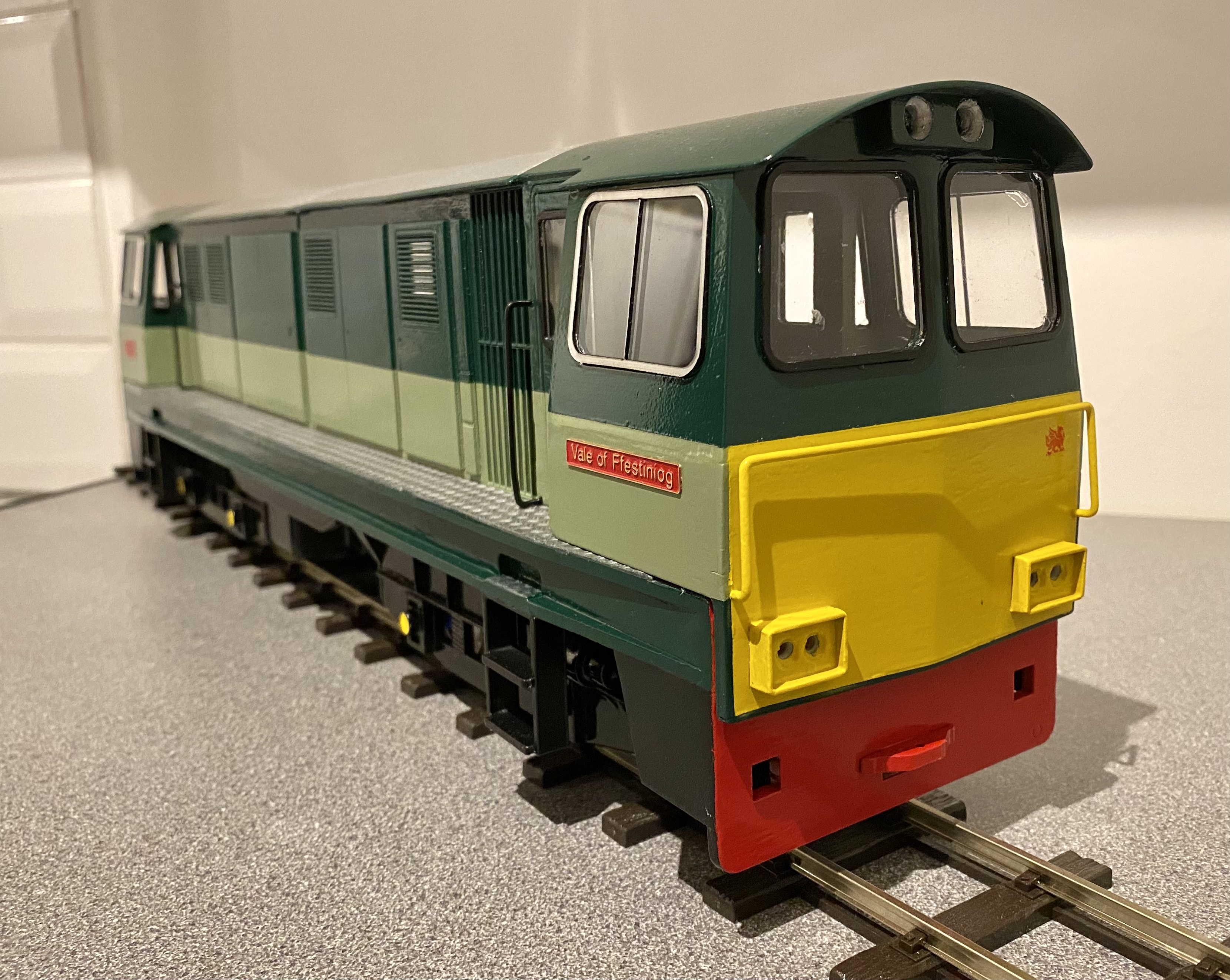

A few more photos to show current progress. I'm not happy with how the front 'yellow' lights are looking but have a plan to tidy them up. Everything else is looking good though I think! Does anyone have any suggestions for what to use for vacuum pipes?

I wrapped the front light fittings with some plasticard. Once I’ve drilled out the holes for the LEDs I might give it one last coat of yellow.

That's really improved the light mounts George. The yellow looks 'solid' enough in the picture. Does it need another coat? Good stuff. Looking forward to the inaugural run.

Yes that really sets the light off nicely.

It’s going to look terrific.

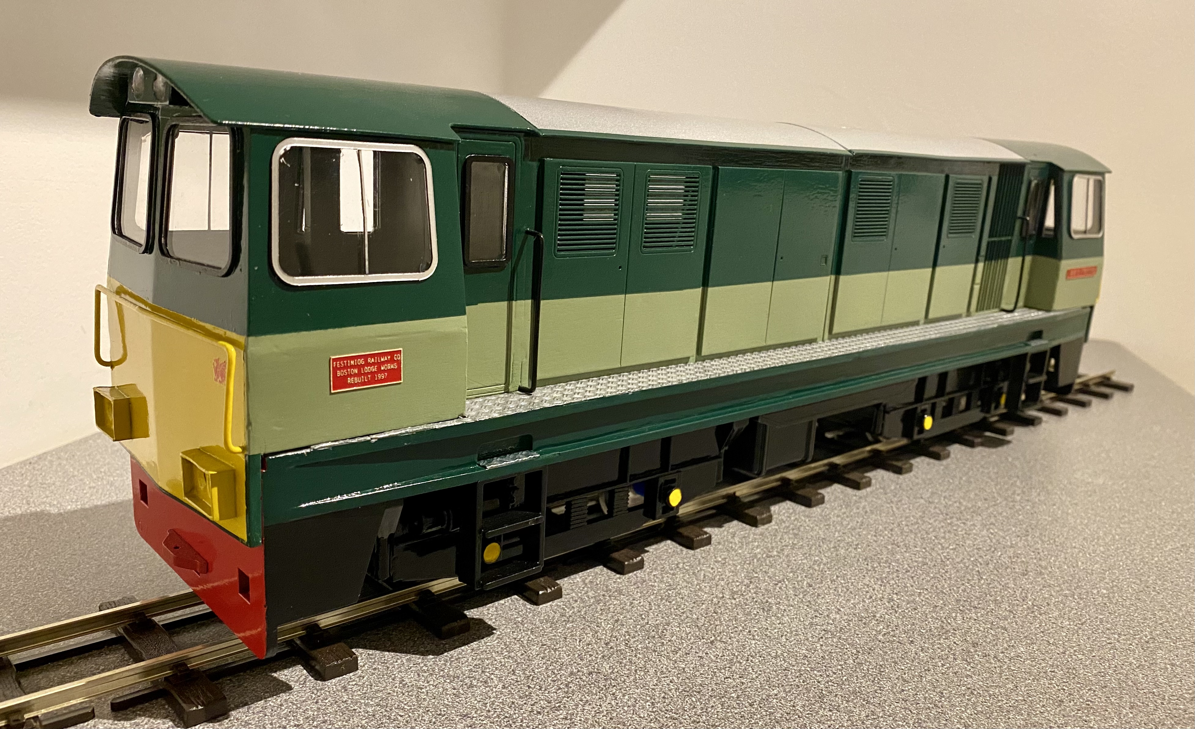

The model is now atheistically complete bar fitting of some Brandbright vacuum pipes. When I got to fitting the window frames I realised one set, the aluminium ones, were missing from the kit. Peter was very quick to send out some replacements so great service there. The plates are from light railway stores - they took four months or so to arrive but I’m pretty happy with the quality. https://www.lightrailwaystores.co.uk/pr ... 423?_pos=1

Now that does look smart!

Looking very good, indeed.

I had initial doubts about this kit but you have transformed it into a thing of beauty.. congratulations.
