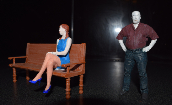

Something a bit different this time...
Last weekend, having got the fire and gas light sorted, I realised that the waiting room really needed somebody actually waiting in it. I have a few figures in stock but none of them are seated, which is what I wanted. I went to the 'DSP 3D' website with the intention of buying a couple of suitable characters. However they were displaying a notice saying they were working on the site, "please come back later". This went on for 3 days and in the end I got fed up and went off trawling the 'net. I hadn't realised before but there are loads of companies producing 3d figures for various computer game, CG film, architects and other designers. I think they are intended as the starting point for customisation in the various industries, so needless to say they are pretty pricey. However, a lot of them offer a few freebies to entice the potential customers in. Most of the freebies are standing, arms akimbo, but I did find one rather tasty young lady, sitting down. So this is the result, alongside a fella I got at the same time. It isn't exactly high resolution, but she has been rather viciously scaled down and the printer has given the poor girl a fairly ropey looking face, but it will be Ok indoors where she is difficult to see!
Actually, I had a bit of a problem printing her, because if you imagine the machine working up from the floor, it has to print quite a lot of supports because she is sitting on nothing, with her legs crossed and off the ground, so the first bit of 'her' that it comes to, is the point of a stilletto heel. It was then trying to print the rest of the leg, balanced on that point and it just ain't feasible! In the end I solved the problem by drawing a solid box under that foot, so that the shoe was resting on something solid, and then cutting it off when the print was finished.
DSC_0002 (1).JPG (172.14 KiB) Viewed 10976 times
BTW, she is sitting on a lump of BluTak which is why she appears so high.
I have been playing with a few others bits and pieces as well, one of which may be Ok with some more development ( or may be a complete disaster) so I'll expand on that later, and one project which has turned out far better than I thought possible, but isn't ready for public consumption just yet.

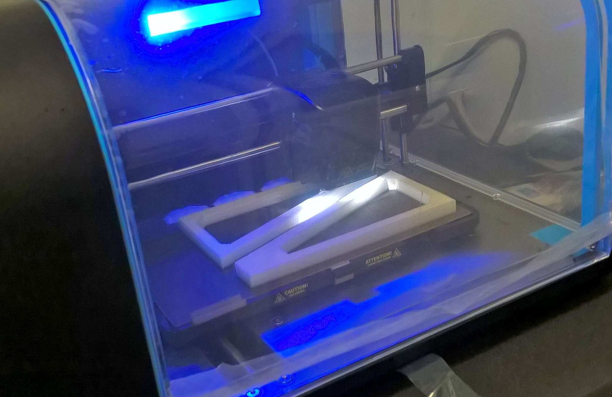

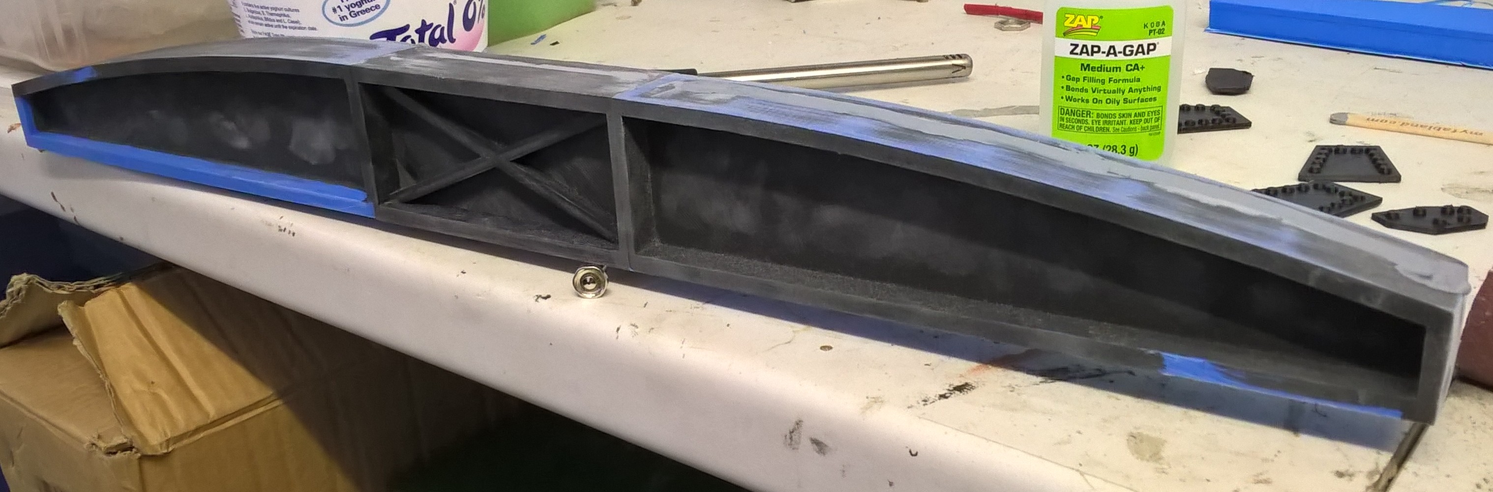

Bridges anyone?
The two faux bridges being made are made up from several printed parts, both based on WHR bridges. For a group member...
The assembled one is 20" long, the glaslyn style one being printed will be 30" when finished.

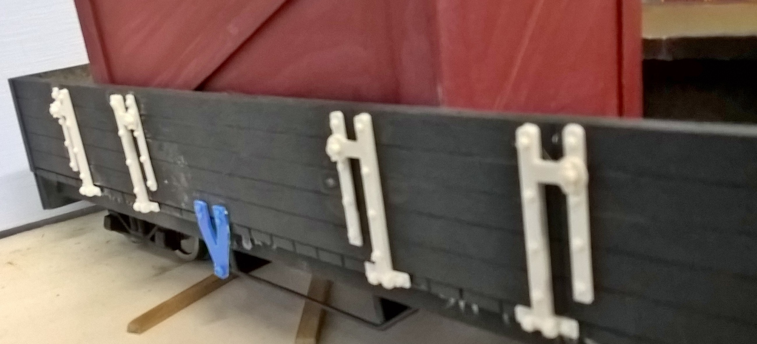

Wagon strapping?

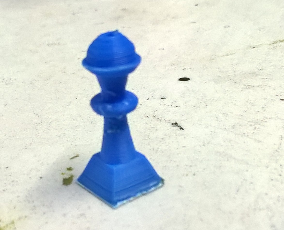

And some finials for a model of Woody Bay station (another group member).

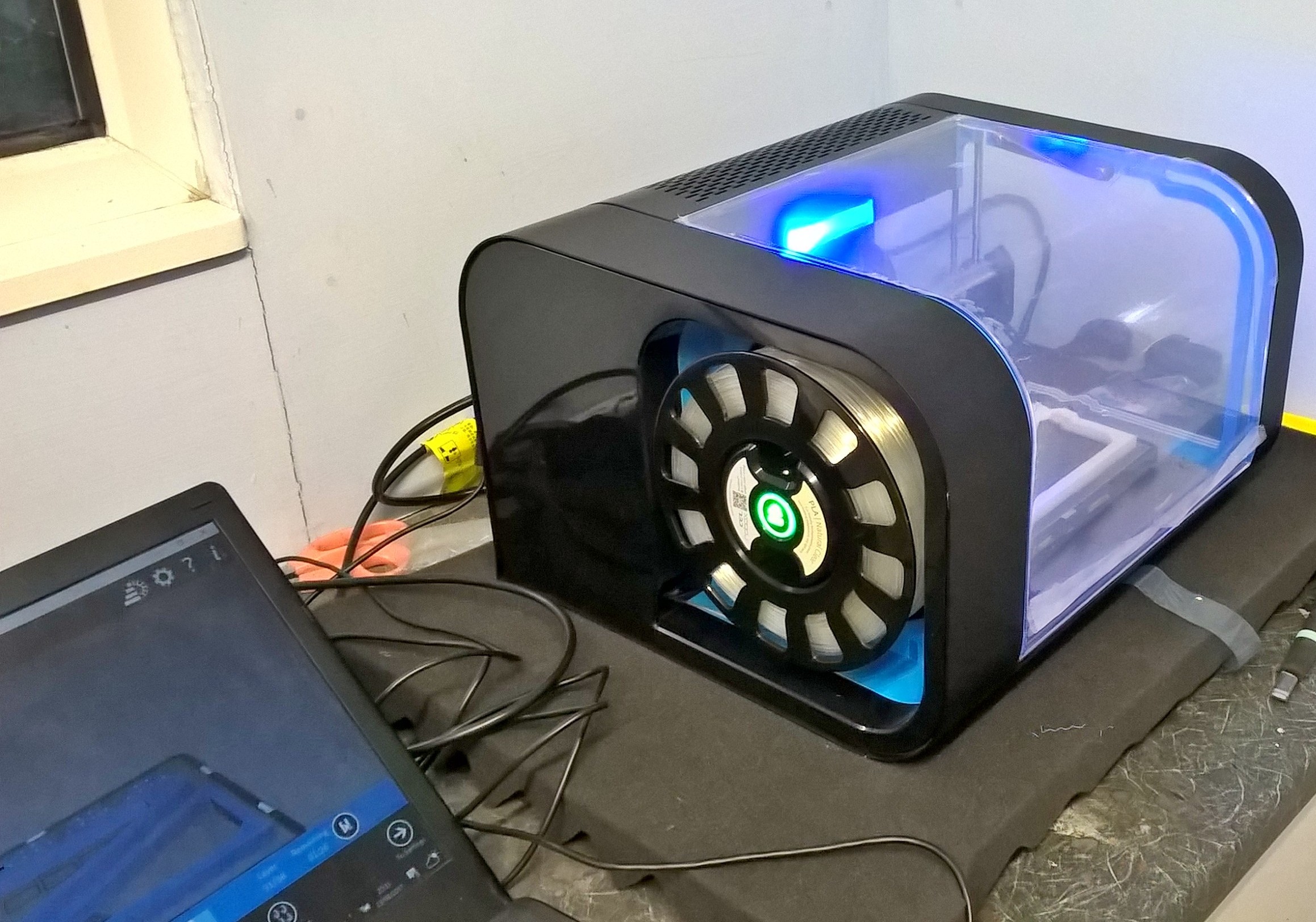

Finally, a picture of the CEL Robox...

They look interesting ( and big!). What filament are you using?
I do like the wagon strapping, very nice.
The finial I am jealous of, I haven't manged anything that complex yet. What material do you use to support the overhangs?

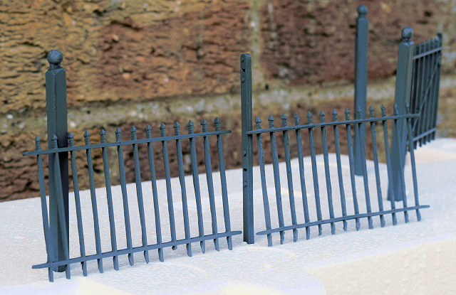

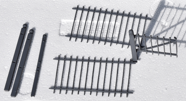

I'm currently wrestling with a 'wrought iron' fence. The verticals are about 1mm x 1.5mm but I can't get the two sides to print as one piece together i.e I get two vertical strips about 0.4mm wide with a gap in the middle which is about 0.2mm wide. The drawing comes up as perfect, when I've checked it, so it must be my machine settings.

Post by philipy » Tue Aug 29, 2017 10:49 am
I mentioned previously that I was struggling with something that might be a disaster and then a few days ago I said I was struggling with a wrought iron fence. Well, it's still not perfect, but with the 6ft Rule in play I think it's just about acceptable.
Printed in ABS so its reasonably flexible and hopefully will withstand the attentions of Sparrows if not Pigeons and @*&%$! cats.
DSC_0005 small.jpg (246.35 KiB) Viewed 10344 times
DSC_0003 small.jpg (434.69 KiB) Viewed 10344 times
The fence panels will slot into the holes in post faces. The gate hinges do work atm, but I think I will probably glue them when its all in place on the platform.

Brilliant - the effort you put in on these is definitely worth it

Some really fantastic work, love the wrought iron gates. :thumbup: :thumbup: :thumbup:
