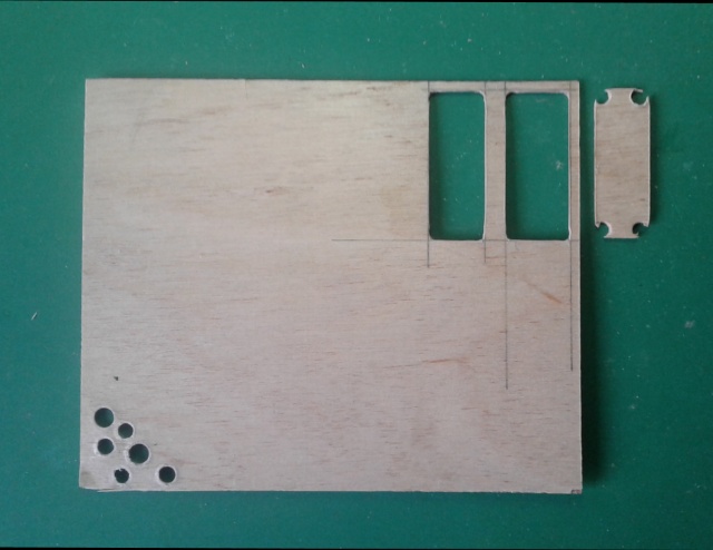

Quite pleased with my first two trial attempts using the leather punch and craft knife in thin plywood. Just a little cleaning up needed.
I am going to give it a go with a small piece of the proper beading. David.

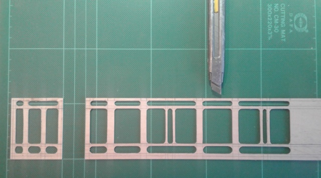

Hi all
It's not easy and its not quick but it's do-able.
I have done 11 cutouts out of a total of 80 and it is getting easier as i learn how to work the files and hold the wood.
For the window cutouts I am using the leather punch but only making a small hole, about 3mm, and not quite in the corner. I am then using a needle file to to enlarge the hole into the corner and then using the knife to cut the straight sides.
For the top slots i am using the punch again a couple of mm from each end and then using the small file to enlarge the hole to allow me to use a larger file to enlarge the hole to the end and top and bottom of the slot, then use the knife as before. The bottom slots are done in exactly the same way exapt that i need to use a third file to enlarge the hole to the required diameter. As luck would have it i already own round files whose diameter equals the widths of the slots i am cutting so allowing me to get an exact size of end curve.
Using a tip from Grant on this forum i am using the file like a drill in my hand, twisting it lightly to enlarge the hole slowly without forcing it. Progress so far.
I am getting better and neater. It will take a couple of weeks i think but i will persevere. I may redo the panel on the left later as some of the corners could be better. One thing i only noticed this afternoon is that the beading around the opening windows does not have curved corners at the bottom, only at the top for some reason.
David.

Progress report. End of day 3. The knife is over the 1st class (centre) door so i am over half way on side one. It is SLOW going but i am getting there. Bet you can't guess which bits i was most worried about breaking. But so far so good.
I will leave you all alone for the next few days while i crack on but will post again when i get towards the end of this marathon. Did i say only 80 holes to cut?

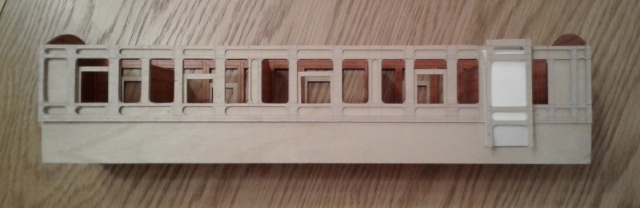

It's been a very busy summer for us with home alterations and so modelling has had to take a back seat.
A week or so ago however i was able to restart my beading and apart from cleaning up i think it is just about finished.
Each side is made up of 3 parts including the one for the guards ducket. This particular piece has to be elongated to follow the curve around the ducket. I think fine glasspapering is the next job on all pieces including the body prior to priming.
There is some more beading to add below window level but as this is to be all body colour i could add it before painting starts.
David.

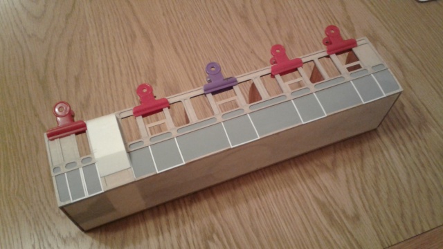

While cutting and sanding the last little bits of beading, i have applied and sanded 2 coats of primer on the coach body below the waist. This is because in the past i have been a little disappointed with the finish of painted wood due to not enough primer coats before the top coat allowing the wood grain texture to be too prominent.
I can now start to add the lower body beading knowing that when i prime and add the top coat it already has a smooth primer surface. If i glued the beading onto unprepared wood, even if i sanded it to a good finish first, the primer coat would make the woodgrain stand up. This would then be more difficult to sand down again with the beading in place.
I have decided to paint the upper body and beading separately first and glue after to allow the cream panels to look crisp behind the red beading. David.

Have spent time today adding beading below window level. Looking at the photo of the coach in service, I needed to cut two sizes. One, the same thickness as the upper beading and one a smaller profile for around the doors. The thicker one i used a knife along a cutting rule with the thin ply used previously and for the smaller profile i needed 20 thou. thick and only 1mm (40mm) wide. For this i used a balsa stripper from a well known internet auction site. Progress so far. I clipped the upper beading temporarily in place to act as a guide for cutting and gluing the lower. The ducket was also used to accurately space the gap needed. The beading below the ducket is now also glued in place and when the ducket with its beading is finally in place i intend to use a little filler to give a seamless join between the two. David.
