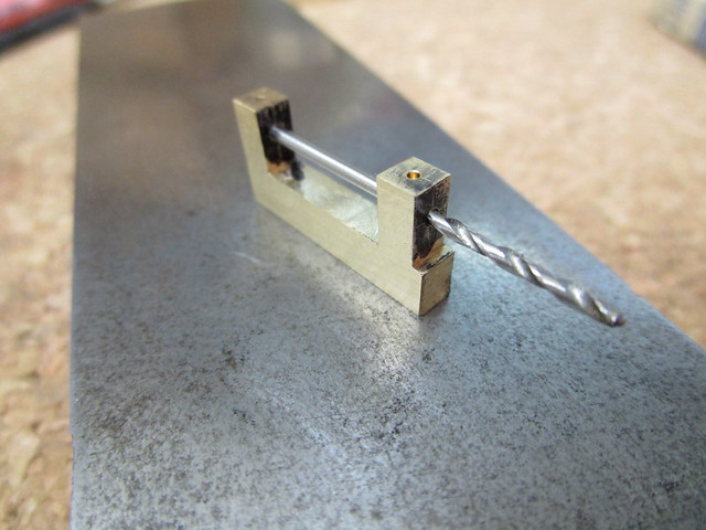

"Hey Feathers, nice save on the 1.00mm holes for the pins, you nearly wrecked that centre finder by turning on the mill at 2500 RPM rather than 110 rpm you goose." "Preston, I am not a goose, I am a penguin this week!" "what ever you are this week Feathers, you are lucky management saved that expensive centre finder"
