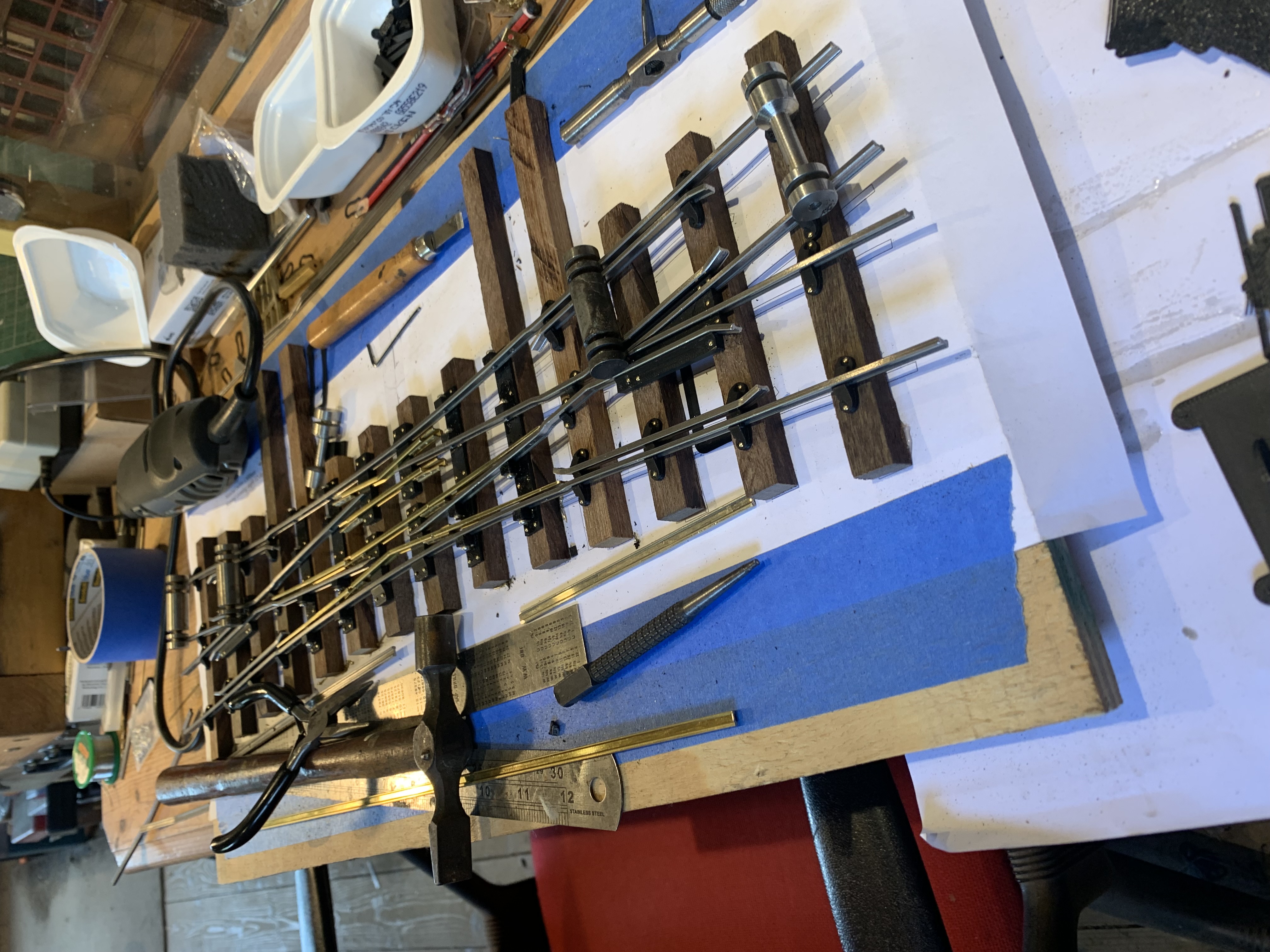

Almost ready to lay track. There are 11 lengths of track made up and 3 points here:
and a double slip almost ready:
I am wondering about actuators for the points. Something printed in the short term I think.

That double slip looks very impressive, Trevor.

philipy wrote: Tue Apr 22, 2025 9:31 am That double slip looks very impressive, Trevor.
Took lots of effort to make it - three mornings in all. I just hope it works as well as it should.
Posted: Tue Apr 22, 2025 11:56 am

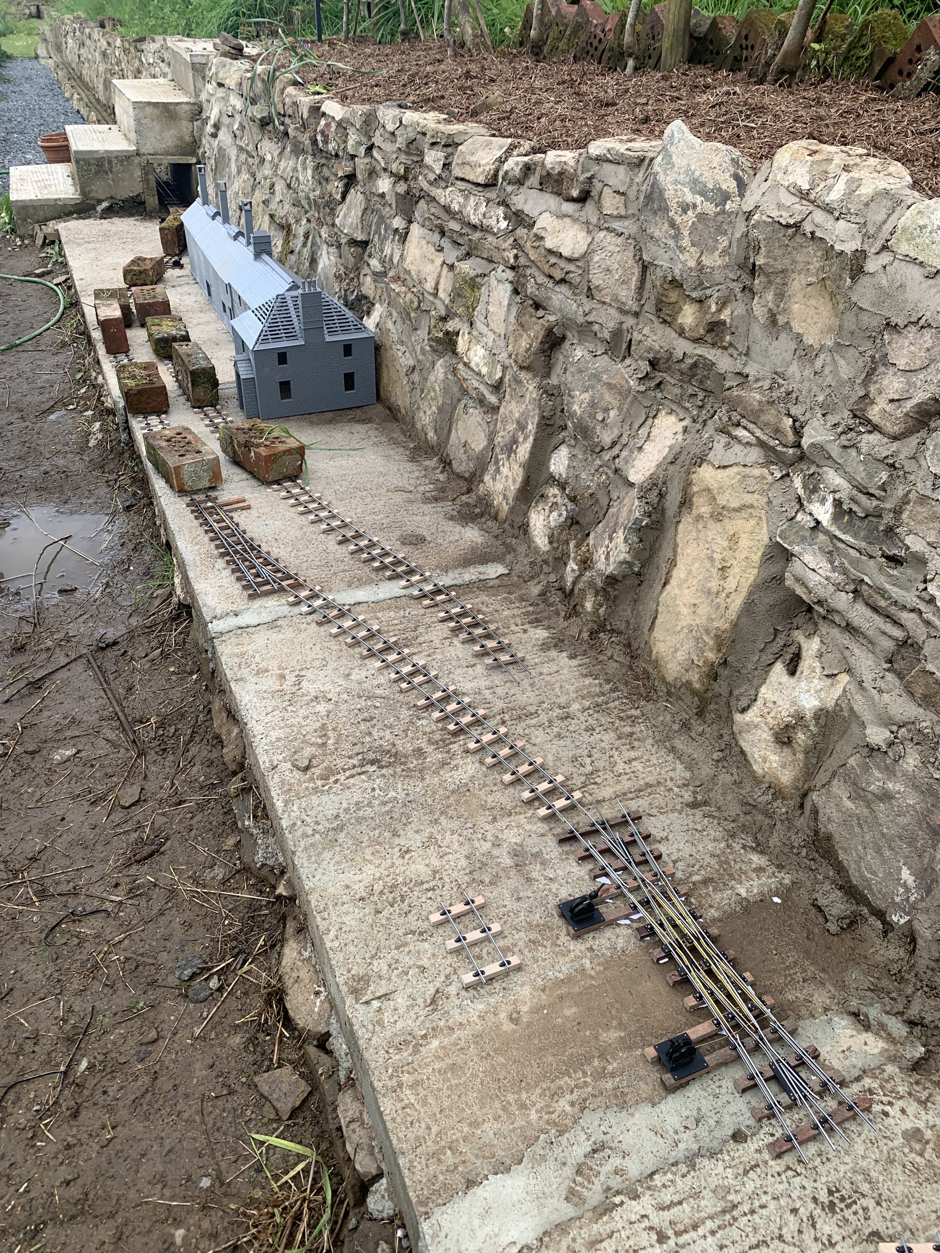

Today I started to lay the track work:
Only problem I can see at the moment is that I think the point levers are going to hit the sides of the rolling stock - so a modification might be required. Oh and I need to order more fishplates.

Trevor Thompson wrote: Wed Apr 23, 2025 8:45 pm
I did wonder about that when you posted the initial picture yesterday. I had exactly the same problem when I printed my own point levers.

Posted: Thu Apr 24, 2025 8:02 am
That slip looks even more impressive in situ
Posted: Thu Apr 24, 2025 9:45 am
by Trevor Thompson
ge_rik wrote: Thu Apr 24, 2025 8:02 am That slip looks even more impressive in situ
I will see if it works this afternoon when it is all connected up.
Having made it, I have worked out how it works! in that each point lever "points" to the road it is set for. So in the photo it is set for as a crossing connecting the far left road to the near right road. I think I can cope with that.
