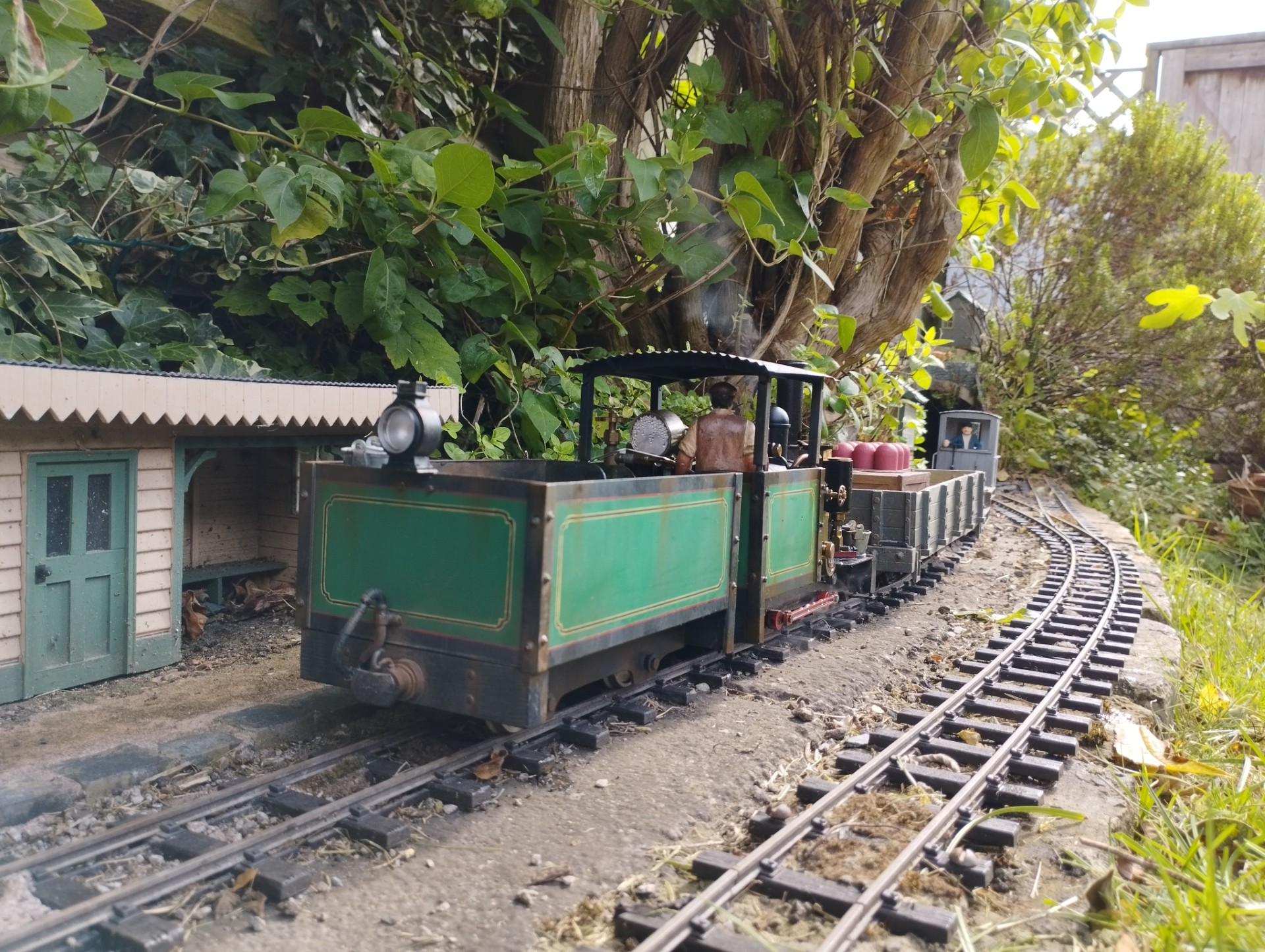

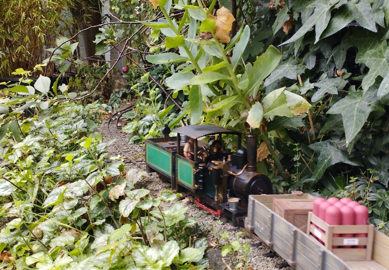

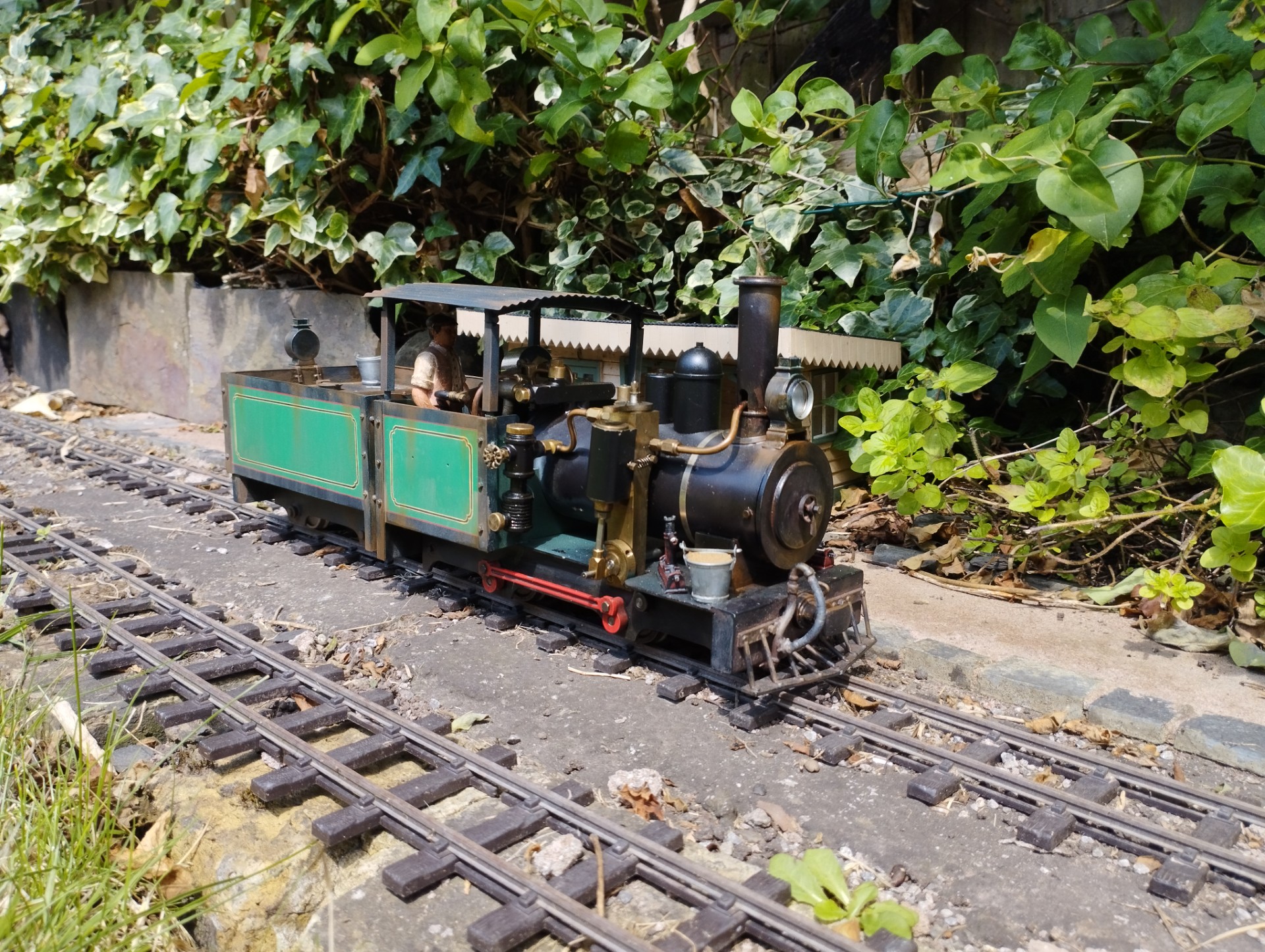

Hi all,
The Regner revamp is almost complete, with the loco posing for official photographs yesterday:
Daisy finished 1.jpg (858.73 KiB) Viewed 69049 times
Daisy finished 2.jpg (793.66 KiB) Viewed 69049 times
Daisy finished 3.jpg (627.79 KiB) Viewed 69049 times
I honestly don't know what "Daisy" represents exactly - a German/US/colonial loco that's inexplicably painted like a Victorian express engine, yet allowed to get covered in grime (which looks a little more subtle in real life!). There's much about it that suggests industrial service, yet it has vacuum brakes. And a very generously proportioned tender...
In reality, when I spend a good chunk of my modelling time trying to recreate actual historical stuff fairly accurately, I think it's just nice to mess about sometimes!
Alas, the test run wasn't a huge success, with the loco really not happy pushing the tender in reverse, which is kind of essential on my end-to-end line! The problem appears to be the coupling between the two where both theory (that a solid link between two multi-hight couplers would prevent buffer locking when, in reality, it just swivels out of the way) and practice (I didn't get 'em at the same hight) were flawed.
For now, I'll revert to running without the tender, but in the medium term I think big old semi-circular Dareeling-style couplings should do the trick...

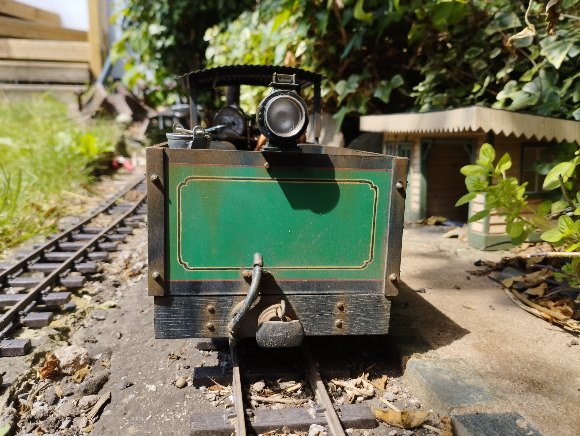

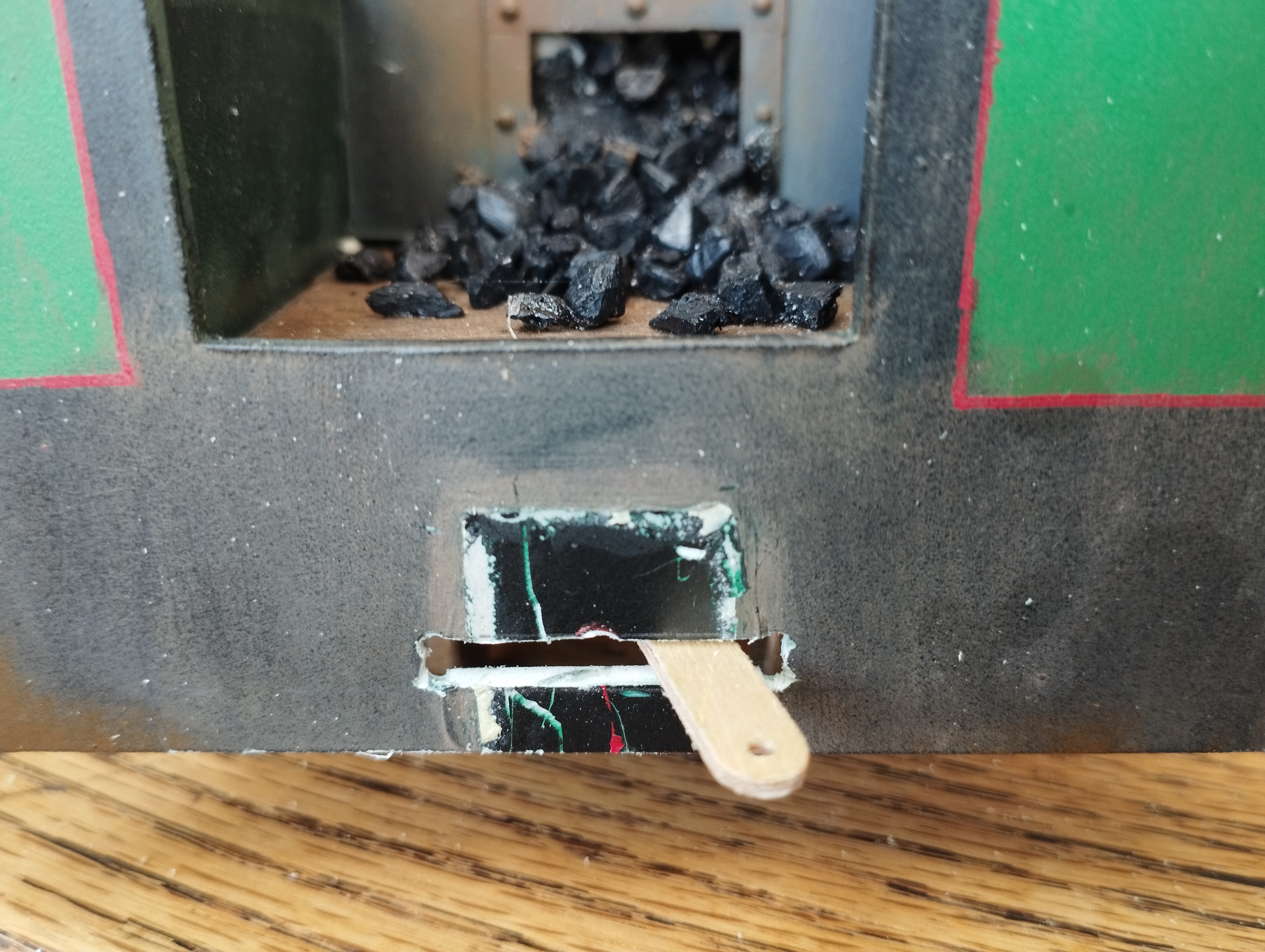

That makes a whole lot of sense. I happened to have this afternoon off work, so I've made a rough version of what I think you were suggesting - I removed the buffer/coupling from the tender, cut a slot instead, and added a new, much longer drawbar, pivoted about 3/4 of an inch back.
It's all temporary and untidy for now, but if it works ( I may not be able to test it for a while) I'll tidy it up and find a length of brass strip to make a permanent drawbar. Keep your fingers crossed!

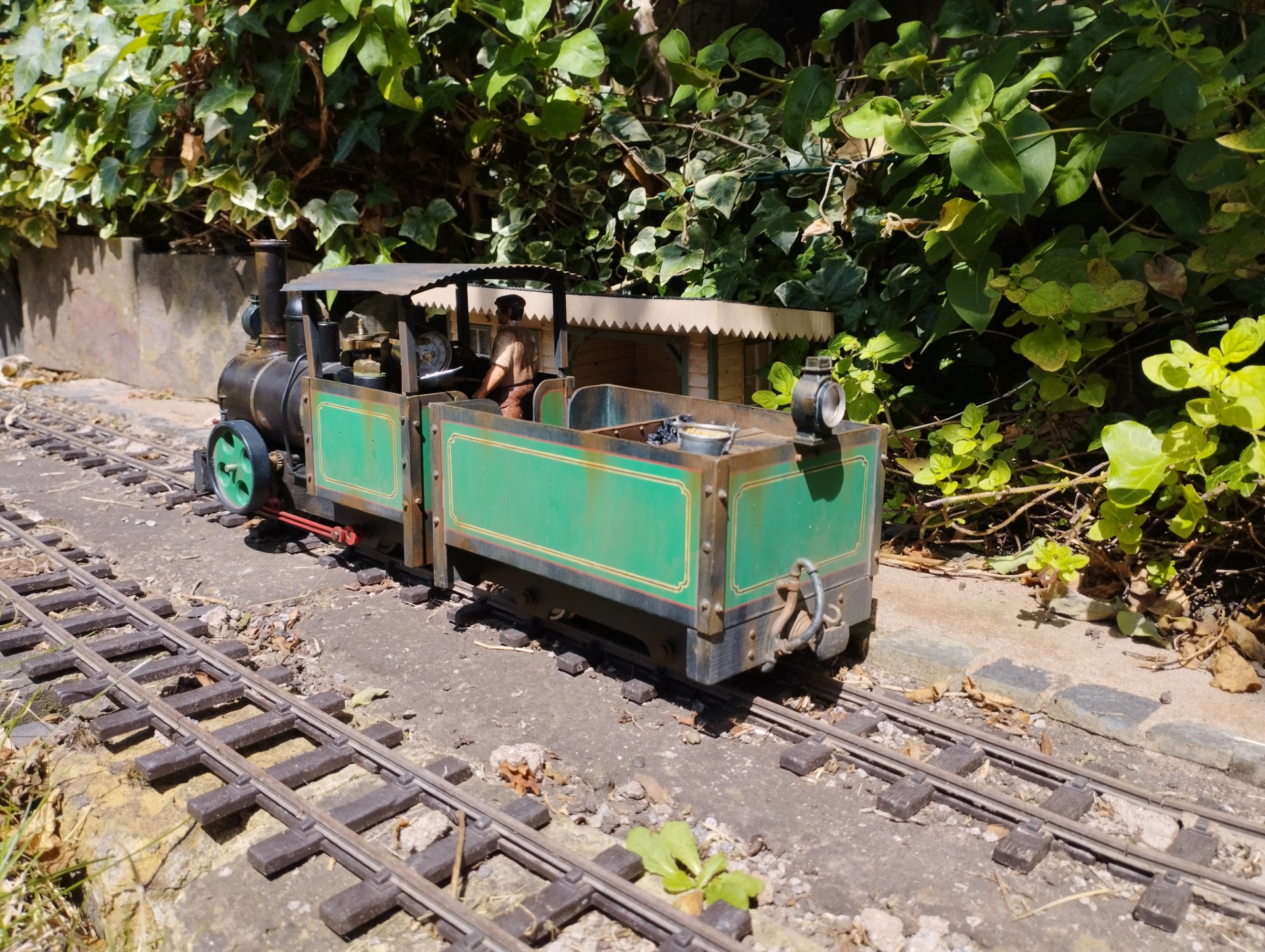

In the end, I went for a very hi-tech solution and created a new drawbar from a bit of discarded cable tie I found in the street. Time will tell how long-lasting it is, but it seems to combine strength and flexibility in a way that seems to work pretty well. The loco trundled along happily in both directions, including over some pretty ropey track and through reverse curves - here are some photos to prove it...
Many thanks for your help!
PS The front lamp's fallen off, Araldite wasn't up to the heat! I'll get myself some silicone adhesive, which I think is what I must have used when I first attached it several years ago...
