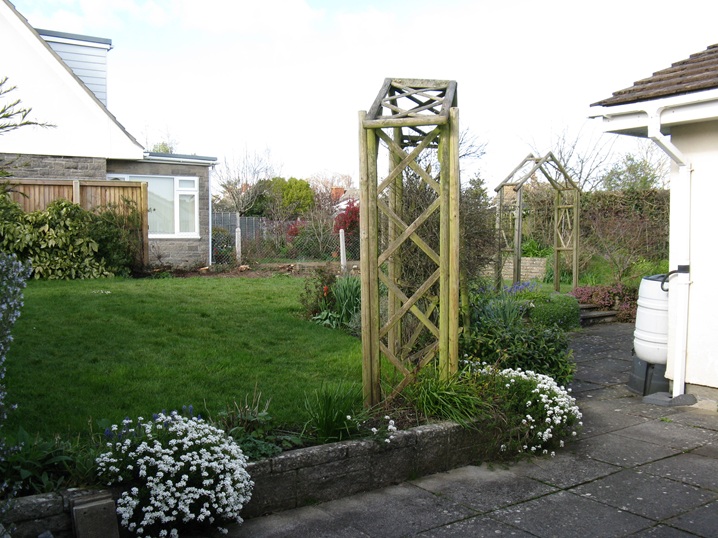

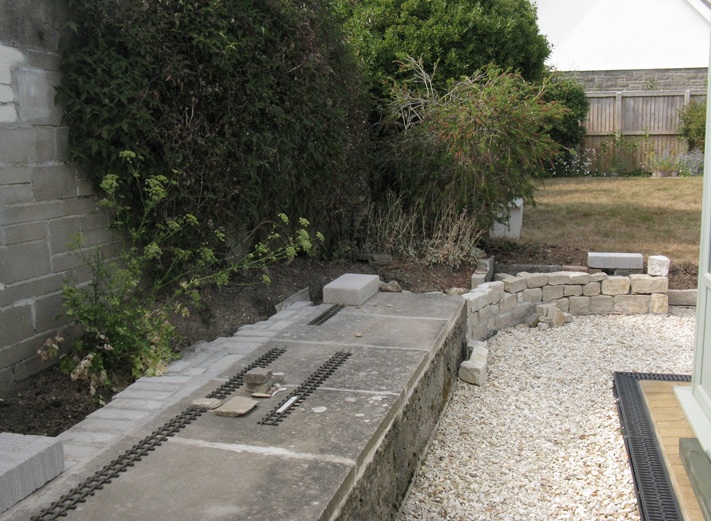

Well, 2025 saw much less progress than I hoped for. The replacement of the conservatory made a big hole in the spring-summer period and then the summer and autumn saw numerous domestic and personal issues demanding urgent and extensive attention. However, the generally milder temperatures have helped extend the construction season into December and I have been able to continue block laying and concreting until recently.
The photo below shows the south or garage end of the steaming up/cool down station yard. A new wall was built as a ‘counterscarp’ to the garage wall itself, to reduce damp problems. A dividing wall was constructed to parallel the existing (low) patio wall and act as the second base wall for slabs. The space in between was filled with flint rubble and some tatty old bricks, once compacted this forms a secondary supporting base for the slabs and allows any water percolating through to drain away via weepholes I created in the old and new walls. The strip next to the garden wall was excavated and much vegetable matter and rotted manure mixed in – when I’ve finished repointing the wall and it’s painted (spring 2026?) then I’ll plant a couple of climbing plants and some lower ground level items.
The height of the slabs now is around two blocks (laid on their largest face) and mortar layers below the ‘cat flap’ in the garage wall. I plan a ‘spine’ down the [central] edge of the slab for the main line and will add support for the loop and sidings when I am clearer as to exactly where they are going. The idea is that when everything is built and tested, I’ll put some earth/gravel/compost in the spaces in between and this will let me grow some ground cover plants in the station area so it’s not all bare stone and track. The slabs are laid on a slight slope so water should drain towards the path. I hope that this and various weepholes I’ll include in the track support walls will stop these areas being too boggy.
On the other side of the garden, I had to attend to other significant civil engineering works due to last year’s Storm D’arrrgh. Two retaining walls (and much drainage!) were installed for the raised flowerbed in the corner. The boundary side of this has been planted with hazel and hawthorn, together with some wild flowers – experts might be able to spot the Red Campion and Herb Robert. Some bulbs are in there too. Somewhere!
Backtracking towards the photographer, the line of blocks went in on an approximate five foot radius curve – these are not the finished PW but placeholders, so plant roots will not be disturbed when the time comes to lay the track permanently. I expect it to be two years or more before I reach this corner, it is down in Stage 3 (of 3) of construction.
I attach a revised plan – this may well change again when construction springs out of the garage ‘bridgehead’. The main change is the expansion of the ‘other’ station in the corner – I thought two or three extra sidings would be very useful both for extra operating interest and for coping with guests’ stock on running days for the local group. I do wonder how popular an end to end (‘I’ or ‘Y’) system will be until I can finish the circuit? We will have to pay attention to our signalling. Provisionally, I plan to adopt Tal y llyn practice, with limit of shunt and ‘U’ boards going in on the trackside. I don’t mind acting as a blockman or bobby but I seem to be in a minority in the local group there, so I’m working on most signalling and point changing being done by the driver(s).

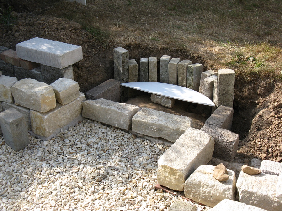

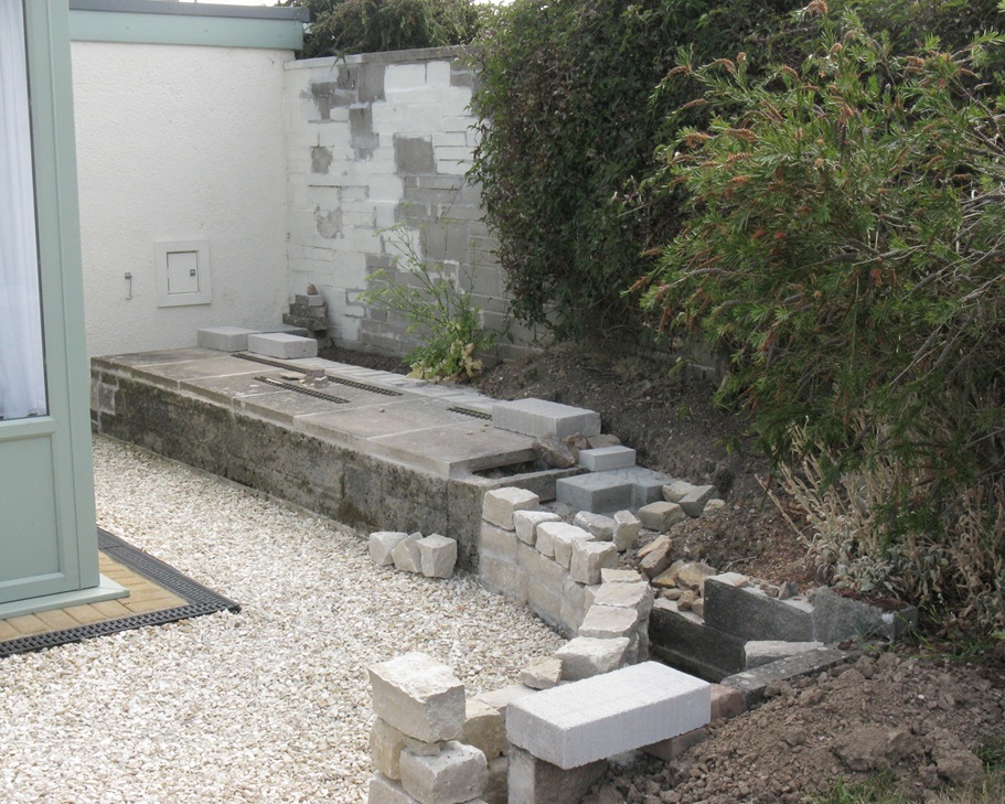

A little more then
As there were well over a hundred slabs and I was still convalescing from major surgery, builders were employed to do the heavy work. Most of the slabs were lifted - some were cut to provide edging for a new path - and channel drains were installed. A heavy duty membrane was laid and chippings spread on top. A trench was cut to provide a foundation for the new garden wall (photo below). Even allowing for potential open days for the 16mm Association local group, we didn't need that large a patio. And I wanted a more aesthetically pleasing wall, rather than concrete blocks.
A 'little later' and I've laid some Purbeck Stone blocks on the foundations the builders installed. The new steps are slightly recessed, about where the left clump of (white) Iberis is in the first photo. I hope the layout is reasonably obvious, with a pair of steps up to the lawn. The white template is a piece of foamboard, cut to provide a guide for laying the blocks in a smooth arc. That area will be filled with drainage stone and chippings - the aggregate blocks will be covered by these and only the Purbeck stone side walls (not yet placed) will be visible. I'll include a sequence of weepholes to ensure good drainage.
The railway will pass over on a removeable bridge at about another block higher than the one laid flat on the LHS. About where that block is will be a point (a Y?) and the other chord (on the far side as pictured) will curve off to the top left and away up the garden. The whole top left is what I have called 'rockery' in my original plan before I started looking hard at the Callistemon and wondering whether I really want to (or can!) lose it. (If I do, there's a very good chance I will try for the suggestion of putting a triangular junction in).
