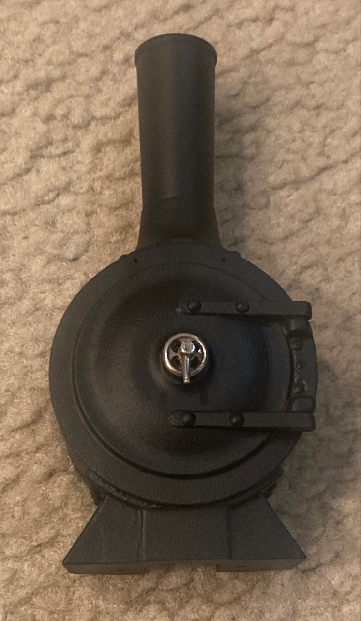

What do people think about this?
Good enough for the boiler/smokebox?
- Posts: 1191
Re: Newcomer Roundhouse Billy Build
Long as you've thoroughly cleaned the metal with meths (denatured alcohol) or any other paint prep solvent, you can't go wrong with engine enamel.
- Keith S
- Posts: 1668
- Location: Canada
Agreed. I think that will look fine on your smokebox.Old Man Aaron wrote: Thu Jul 21, 2022 3:29 am Long as you've thoroughly cleaned the metal with meths (denatured alcohol) or any other paint prep solvent, you can't go wrong with engine enamel.![]()

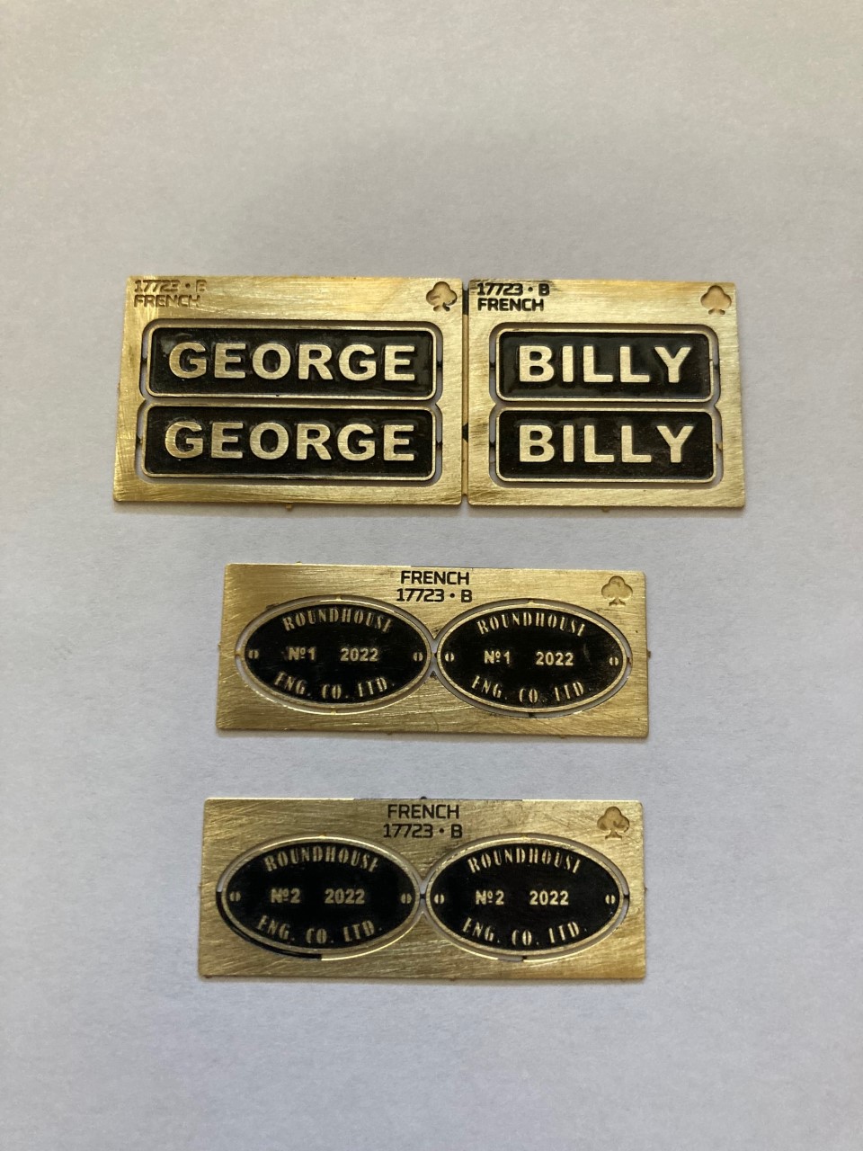

Name and works plates have arrived from Narrow Planet
(Not very original names

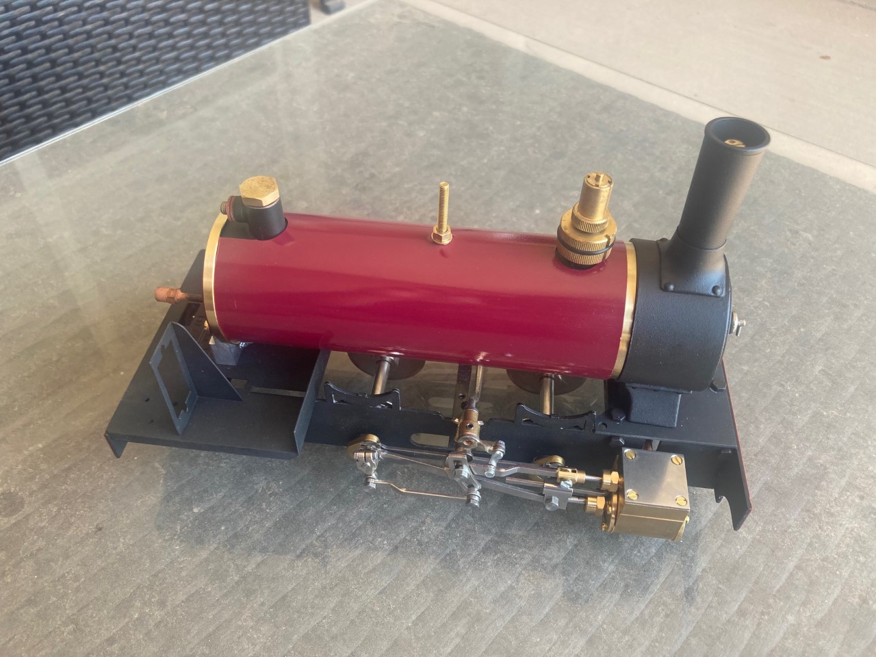

First update in forever!
Temp has dropped slightly so I'm trying to get as much painting done as possible. I've completed the smokebox and boiler and am now trying to touch up some parts and paint the boiler wrapper.
The chimney was painted with U-POL acid etch primer and the smokebox and boiler were then primed and painted with the Rustoleum engine enamel. I'm not sure if the boiler should have been painted but it looks good - fingers crossed that the paint holds up during normal use.

Boiler wrapper painted. I'm a bit disappointed in the colour (it's a lot more pink than I'd anticipated) but it will have to do.
The finish is ok but not great, so I've ordered some polishing compounds to try to buff it up a bit.

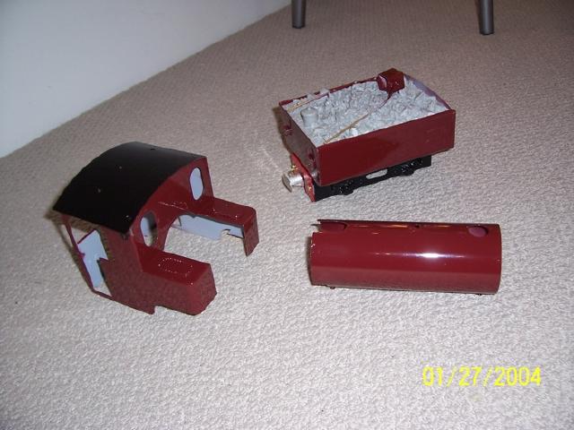

Well I think it's a nice colour, anyway. There is (was?) a brand in Canada called "Tremclad" that was marketed as a "rust paint". They came out with a line of "designer" colours and I chose the "Wild Raspberry" colour for my locomotive, because it was similar to the "Victorian Maroon" colour that Roundhouse uses. Then, I thought, why not paint my "Brandbright" passenger coaches the same colour? Well I built one of the Brandbright coaches, but that coach took me a long time to build and I haven't built the other two, and since then Tremclad has ceased making that colour, and so now I mustn't damage my locomotive because it will be very difficult to find matching paint. Also my remaining coaches will be a different colour when I build them, which is irritating.
As for the paint, it was actually kind of unsuitable until I baked it in the oven. You can't tell unless you lift the dome off, but the first time I steamed the engine, the paint softened and the dome sank into it. Obviously this isn't visible when the dome is on, but happily after baking the whole thing got a lot nicer looking anyway.
Well, regardless I think you'll end up liking the colour. The locomotive will look a lot different once it's assembled anyway, for the better.
Here is the colour change I noticed on mine.The fresh paint was lighter and thicker looking than I had expected, but after baking it became harder and the texture changed from a superficial gloss to a real enamel look. The two pictures are also about ten years apart. The paint you used is likely a much higher quality than mine, as well.
