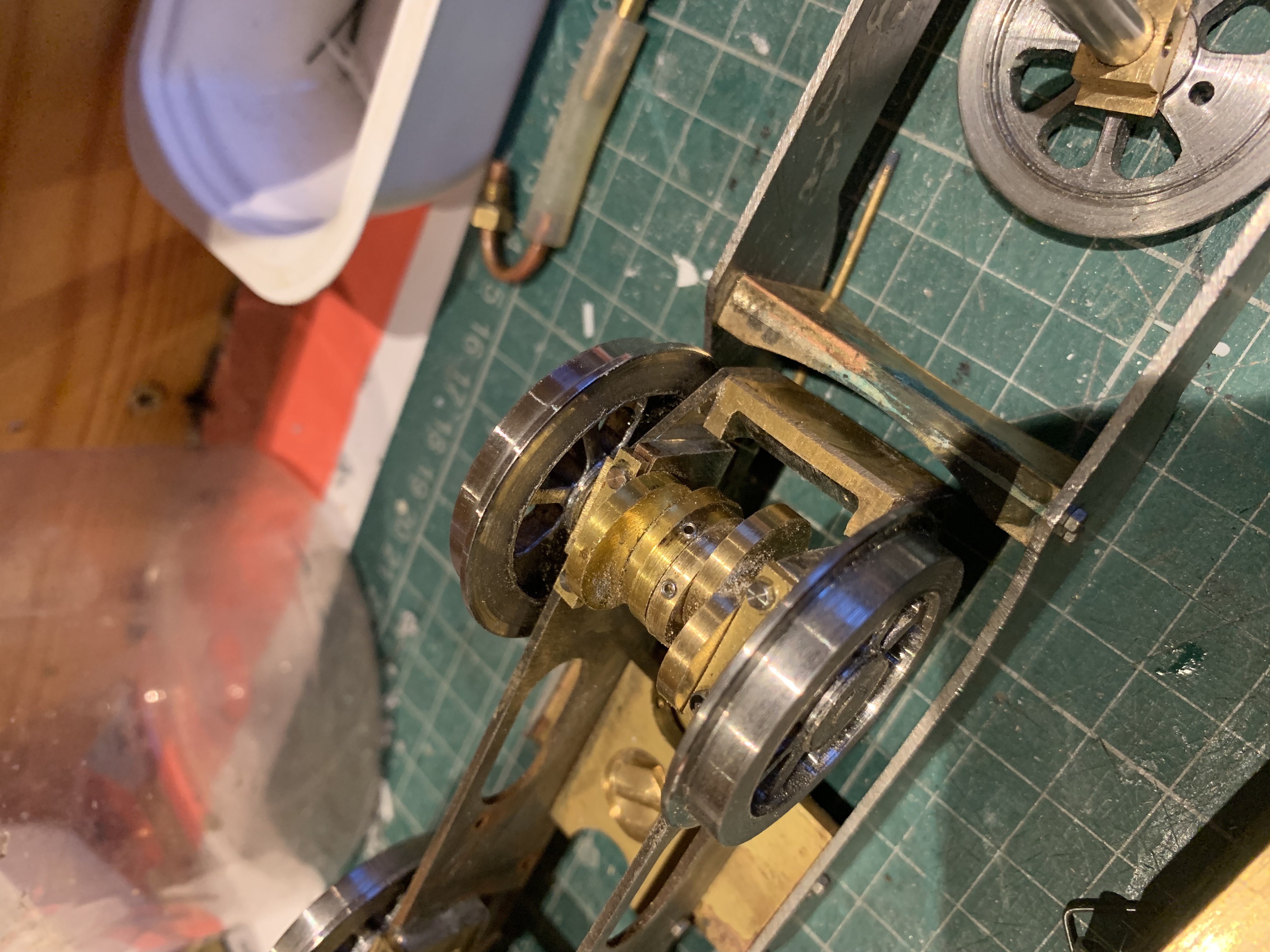

So I have set the eccentrics on to their carriers:
The carrier is 15mm diameter and the eccentrics are 16mm diameter. They were assembled using bearing lock and quickly pressed against a block of brass. By holding the carrier flat on the bench while pressing the three components against the brass, the eccentrics were locked in a position which will mean that the valve opens just after the piston has reached the end of its travel - in both ahead and reverse. When the motion is made and all connected each pair of eccentrics can be adjusted so that the valve timing is the same in both directions.
I thought I was going to silver solder the eccentrics, but the lock tight method seemed easier. Rather than rely on lock tight alone I have bored through all three components and fitted a clockmakers taper pin. I fixed that with bearing lock as well. So one set pinned, and the other pinned and filed up:
The eccentrics mounted on the axle, and all fitted to the frames:
Both bogies are in the same state - both have the eccentrics and axles in place. These two inboard wheels on each bogie are fixed to their axles with bearing lock, and quartered by eye. When the lock tight has cured I will drill and pin these wheels in place. The other axle can't have its wheels mounted permanently until the coupling rods are fitted.
So the eccentric straps are next, and I am working towards assembled valves and valve gear.

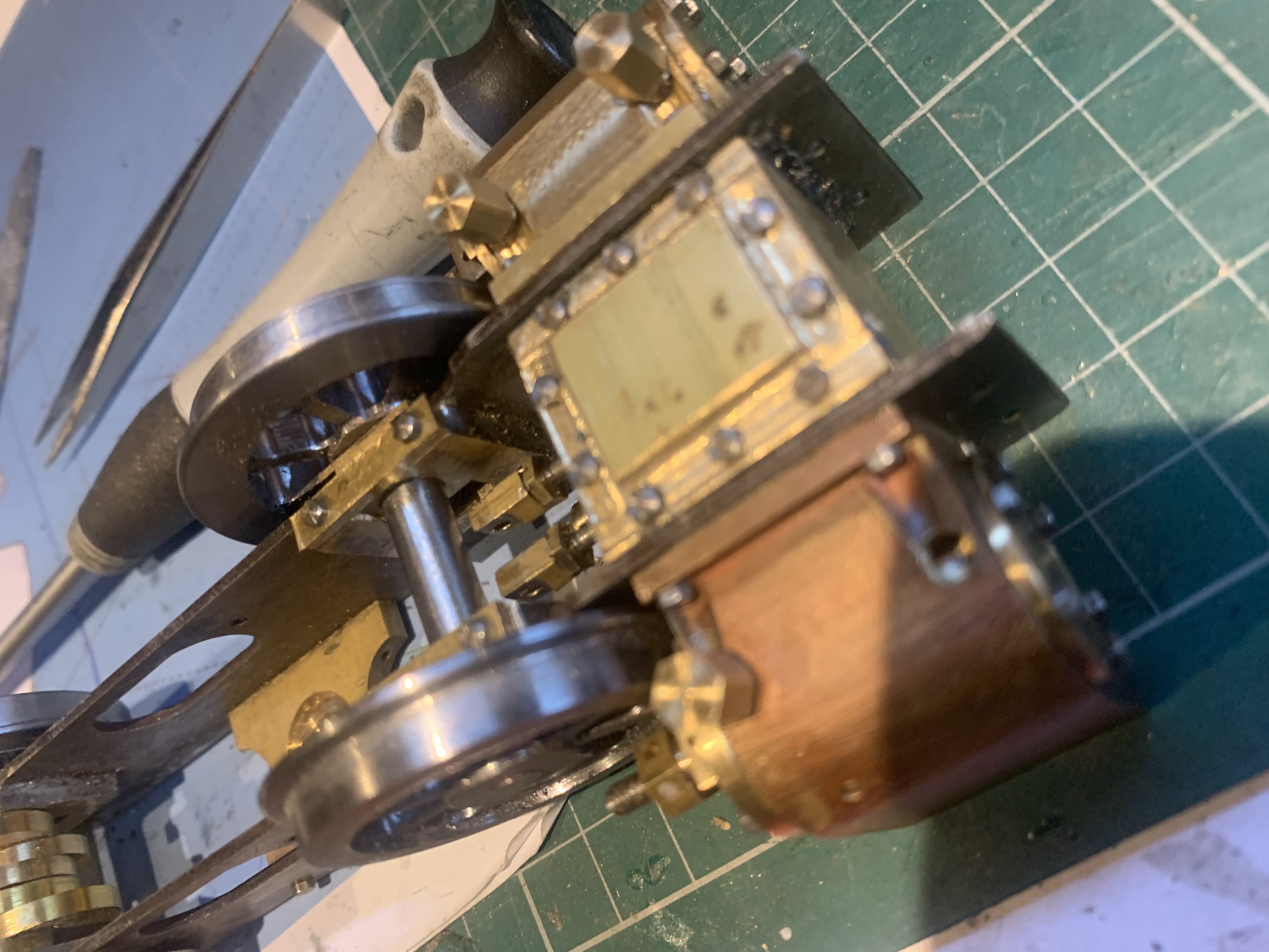

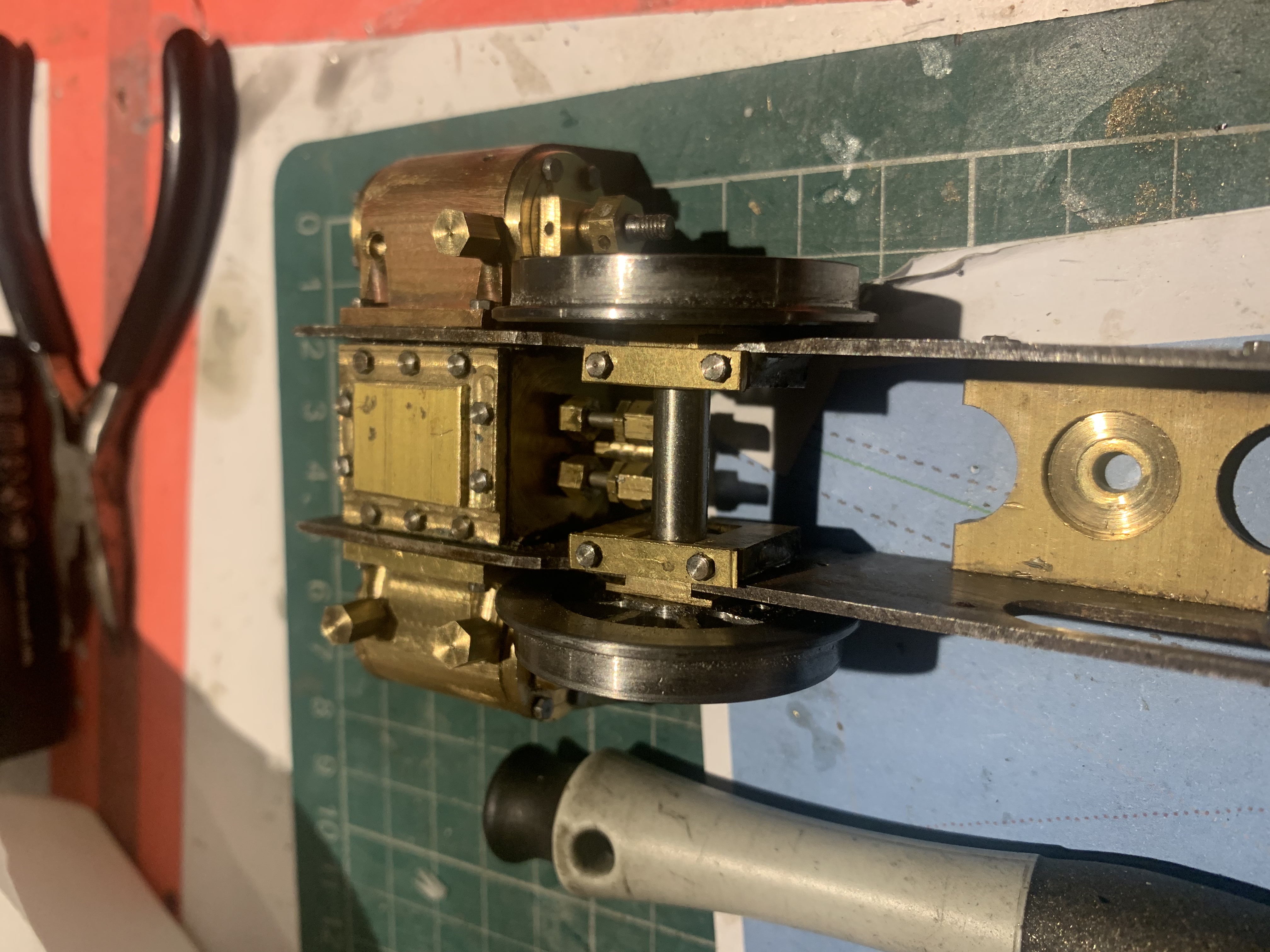

The first bogie now has its valves fitted permanently (hopefully!). Each cylinder has its end covers fitted using a lock tight gasket fluid. The cylinders are also fixed to the frame using the same sealant. The valve stems are in roughly the correct setting, and it is all assembled:
The cover has been fitted with a paper gasket, and the holes drilled out for fixing it in place.
The steam intake is a third fitting which is just visible below the valve guides in both photos. The exhaust will be made from 3mm copper pipe and will exit the cylinders at the top between the frames before being joined together. The details of how that will work will be clearer (to me) once the boiler is made. So the front end assembled and steam tight:
I have tried it out on 25 psi with the air line, and I can confirm that each piston shoots in and out as the appropriate valve is moved.It is reassuring to see that the valve stems clear the front axle! So, apart from having lost a couple of half made automatic valves, I can repeat all of this on the second bogie.

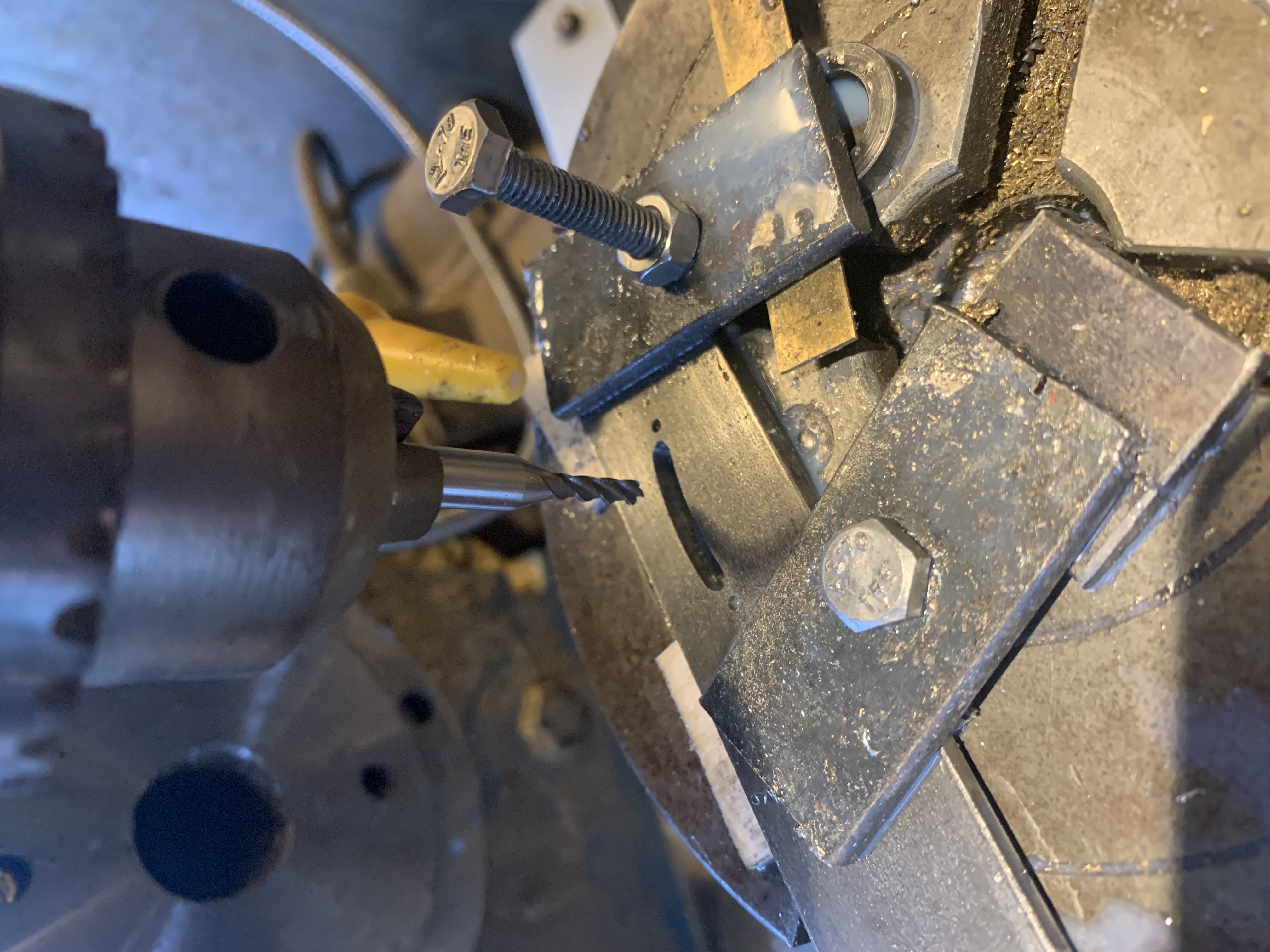

Today I started to make the expansion links. I am making them out of 3mm thick mild steel, so that involved coolant oil, and one of my rotary tables. This one has a flat bed which I can fix metal strips onto. The metal was held down so that the centre of the strip was 42.5mm from the centre of the table. That gives the expansion link the correct radius.
The drawing:
Having set up the table so that the centre of the milling head was lined up with the centre of the rotary table, I just had to move the X axis the 42.5mm to set the radius. All the milling and drilling can then be controlled by rotating the table. Milling the slot:
The finished slot and the holes to take the eccentric rods. I then milled out the outline of the link.
I have diverged slightly from the drawing - in that the slot is 3mm wide not 2mm wide - I think that will make it easier to make the block which slides up and down in the slot.
The first expansion link finished:

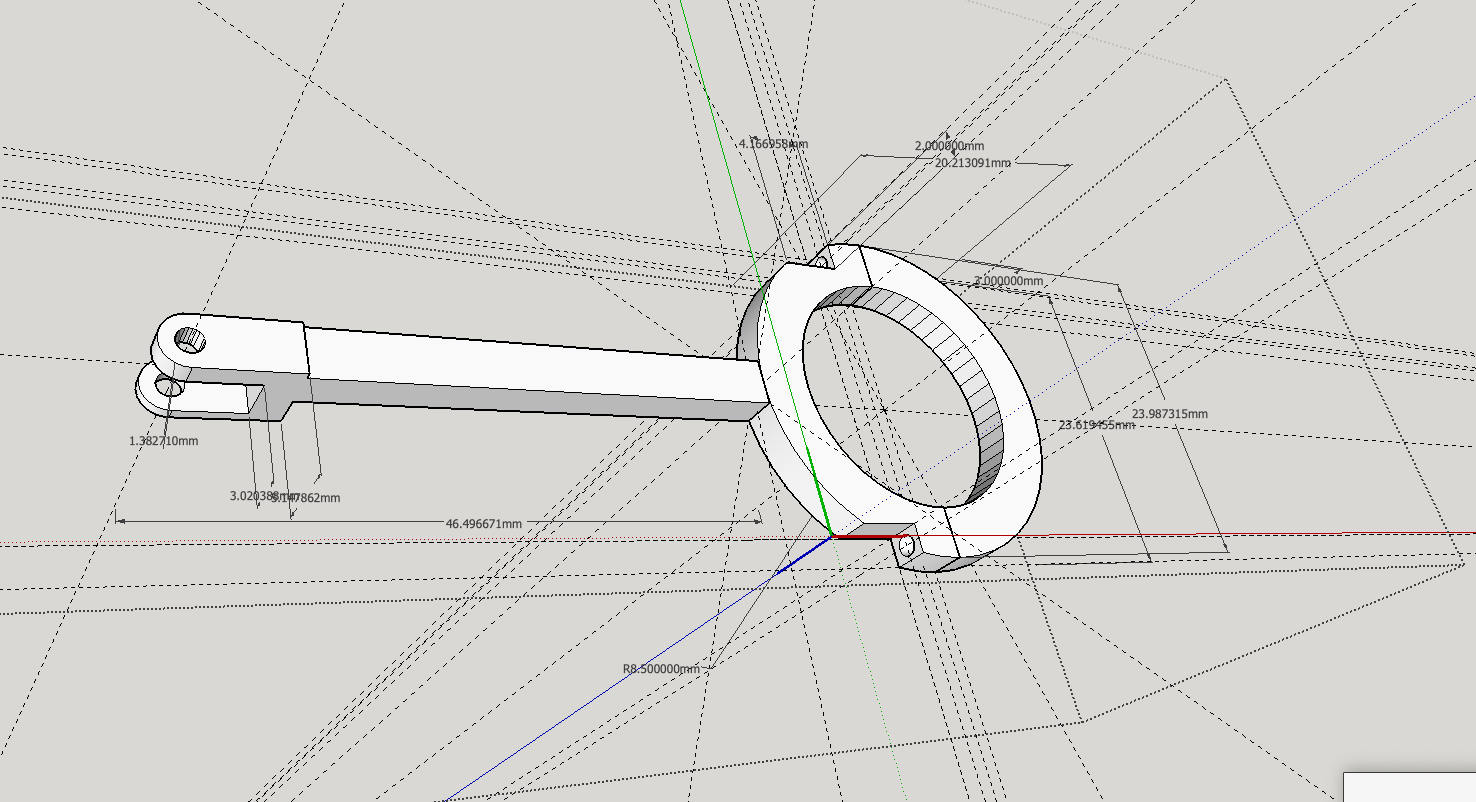

and I have started on the eccentric straps. This is what I am trying to create:
and a detail:

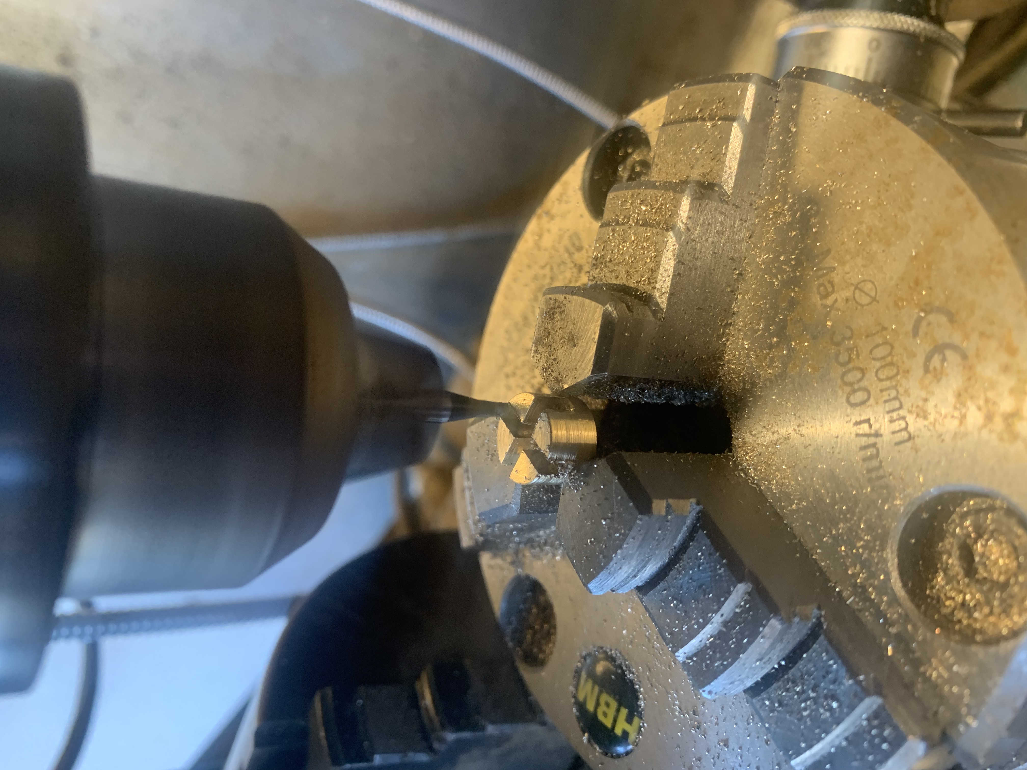

I started off hacksawing out 8 off 25mm square blanks, and drilling an 8mm diameter hole into each of them. That enabled me to mount two of them at a time in one of the mandrills I use for making wheels:
The next task is to turn the outside diameter down to 24mm diameter. I hope to then be able to mill out the slots and drill and tap the holes (10BA) which will hold the two halves of the eccentric strap together. Then I plan to saw the two halves apart, clean up the sawcut and bolt the halves together. Hopefully I can then hold each strap in the chuck while I turn the inside diameter to size.We will see if it works! Then I have to repeat it 7 more times.
Turning the outside diameter to size:
