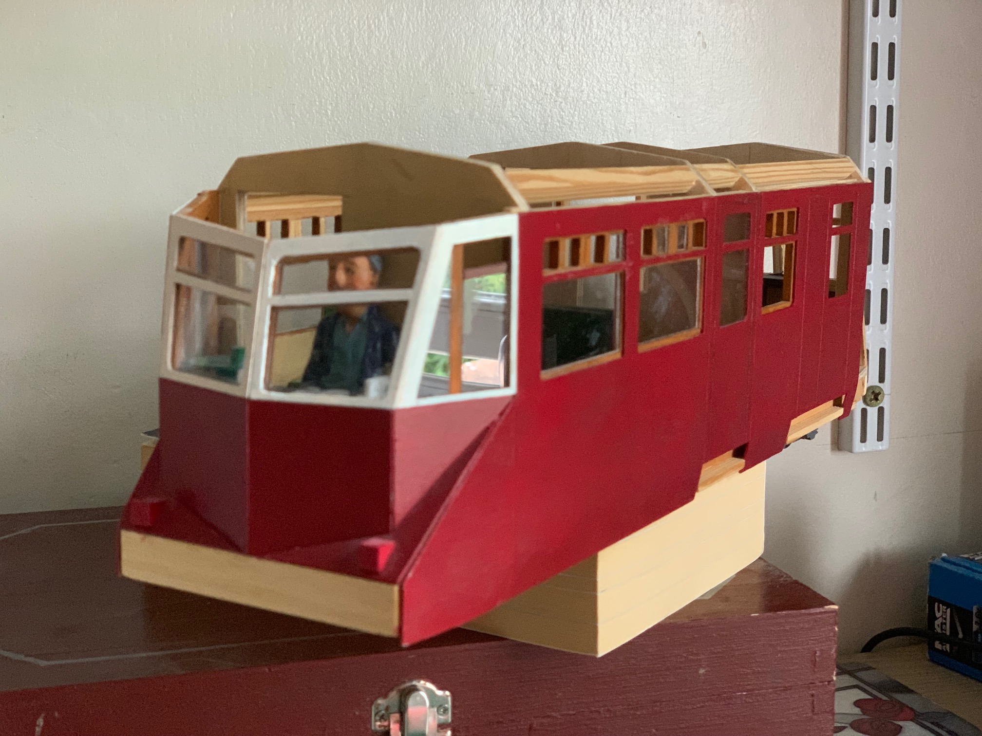

Posted: Wed Jun 26, 2024 9:02 pm
by Seb_N&BLR
A bit of progress including cab detail. The driver looks constipated so I might touch his face up, it’s not my strong suit :D
Re: N&BLR Ongoing Projects thread
Posted: Thu Jun 27, 2024 1:25 am
by LNR
Either that or he just drove through a red signal!
PS figures and faces are not my strong point either.
Posted: Thu Jun 27, 2024 10:19 am
LNR wrote: Thu Jun 27, 2024 1:25 am
Get a female relative or friend to suggest some judicious make-up. Slightly rosy cheeks make quite a difference.
Posted: Thu Jul 04, 2024 1:14 pm
by Andrew
The photo of the railcar in your hand shows what a chunky beast it is (the railcar, not your hand...) - very impressive!

Posted: Tue Dec 02, 2025 7:45 pm
by Seb_N&BLR
Thanks Aaron, sorry for the slow reply. Yes it is frustrating about the tree and a somewhat down-heartening experience walking down the garden at the moment. Thanks for the suggestion re roof construction, I will definitely be looking into that option.
Railcar is now mounted on both its bogies, and both ends are streamlined with glazing and cab window surrounds still to add at the brake-van (no.2) end. I ended up repurposing a random plastic-framed bogie I’d inherited, with resin SS bogie frames cosmetically added, which meant I could avoid learning all the wrong ways to drill out resin axleboxes. Roof-aside this project is getting perilously close to actual successful completion and I’m now thinking about the battery-box assemblies for beneath the floor.
I think the centre-buffer suits the Swindon style!
Posted: Wed Dec 03, 2025 9:25 am
I do love the front end profile. Well worth the extra effort it must have taken.
It's looking great!
