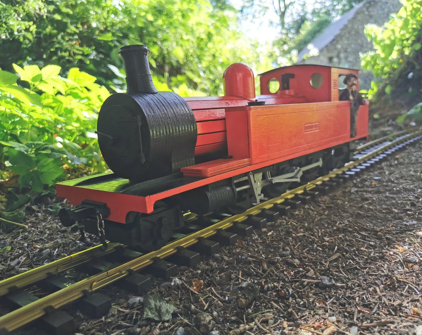

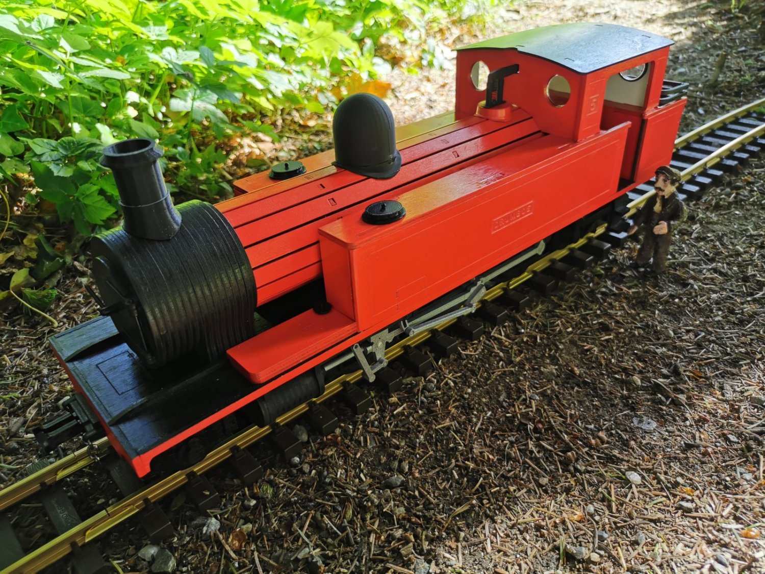

Leonard wanted to take her out for a test run, lot of discussion back in the works as whether the steam dome should be red or black. what do we think?
Red steam Dome
Red steam Dome
Black Steam Dome
Black Steam Dome
Mr Forbes who was watching down from the signal box also declared that maybe the tops of the water tanks should be black
The red looks very pinky is this picture,
some gauges and portholes have been added, looks like also Leonard has let the fire go out
Re: Donegal Railway Class 5 Drumboe 15mm scratch build
Posted: Sun May 31, 2020 12:37 pm
by Jimmyb
Yep, dome and top of the tanks black, but that is just my opinion ;)
Posted: Sun May 31, 2020 4:33 pm
by tom_tom_go
I like the black as well.

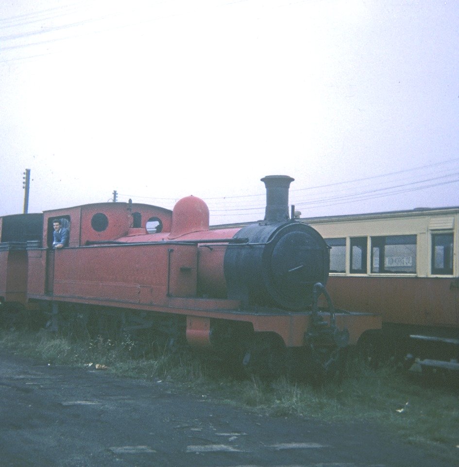

Looking through books and pictures I have, both Drumboe and Meenglas had red domes when they were sitting in strabane during the 60s after the railway closed,(see pic below) but all the running photos I have when the railway was operational, show them with a black dome.
Columbkille which was apparently freshly painted and put in storage around the closure, also has red dome, as she can be seen inside the FVR museum. So think the red domes may have been a change in the last couple of years of the railway.
Think for my model the black dome will look better to break up all the red.
