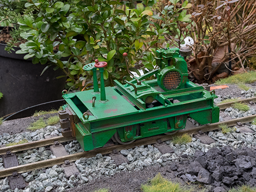

The Lister project continues with a look at the livery in daylight. As you can see it looks better for matting down and some light weathering.
Lister reflection.png (477.33 KiB) Viewed 12042 times
A slightly elevated view allows a comparison of weathering techniques. I find weathering where the surface is worn away (eg the footplate wear where the driver's feet sit) is best achieved by literally wearing it down with light wet and dry to reveal the previous layer. However I find built-up weathering ( eg the grime in corners of the frames or the rust on the grill) is best with building up by layers of paints powders and dyes. An overall light spray of ModelMates weathering dye (rust) gives a patina of use. I did like the oil colour (it really looked like a oil-water separation effect) but have run out and the company is no more. If anyone knows of similar products I would be grateful for the heads-up.

by Big Jim
What, no easy-start?
Have you tried the Humbrol range of weathering washes?

Big Jim wrote: Fri Jan 05, 2018 4:12 pm What, no easy-start?
Looked at them with uncertainty, but saved from the decision by the sheer amount of empty spaces on the rack!
