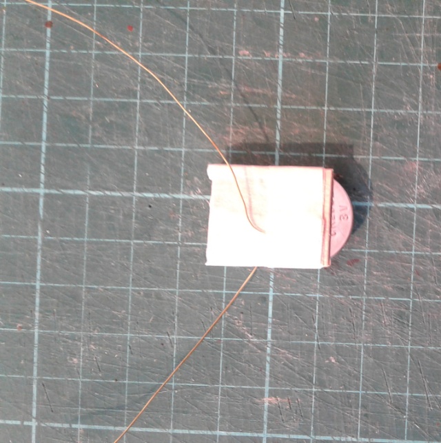

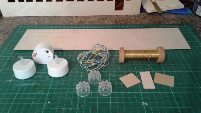

As said previously i need to sort out the lighting in the roof so that i can then get the compartment partitions to an acceptable height. So this is what i have been up to over the last few days.
Firstly get the items together for this part of the project.
3 battery tealights (3 for 1 pound from local pound shop) to give me 3 flickering orange leds, a button battery with 2 spare and a small sliding switch with 2 spare.
A small amount of wire for connecting the leds etc.
Small pieces of wood to make a thin battery box.
Thin brass (or copper) wire for making the connections in the battery box.
3 lamp globes (plastic tops from fruit shoot bottles).
Piece of thin ply cut to size for the internal roof panel.
The battery box is made of a small piece of balsa the thickness of the battery (3mm) and two larger pieces of thin ply for the sides. There is a small hole in each of the sides through which the thin brass wire is threaded to make contact with the sides of the battery. The three pieces of wood are then glued together allowing the battery to be slid in. I also wrapped a piece of masking tape around the box to help hold the battery in place. The battery can be replaced using a pair of pliers. A photo may help to explain all this.

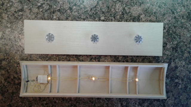

Hi all
I have now glued the leds into the roof using a hot glue gun and wired them in parallel. The battery box is now in place and held in place with a sticky pad. I have soldered the switch into the circuit on longer wires coiled round as it is to be glued to the internal roof panel which may have to be removed occasionally to replace the battery.
I have also marked and drilled holes in the internal roof panel to take the lamp globes. This panel has now to be scribed and screwed with an upwards curve onto the frame of the roof.
This is the roof of my buffet coach and shows the effect i am aiming for. You can see the switch on the left hand side.

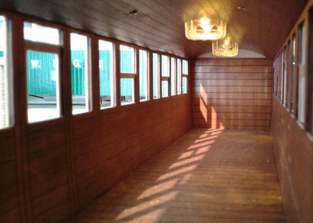

Hi all.
Spent the last couple of days finishing the roof. I have scribed boards onto the ceiling panel and cut a small slot for the switch to be operated through. I then coloured the panel with mahogany stain and marked and drilled for 8 6mm brass woodscrews. I then had to glue 8 wooden pads onto the underside of the roof for these screws to screw into. The switch was then epoxyed to the roof panel before screwing the panel to the roof frame. I used epoxy resin glue (araldite rapid) because it doesn't creep into the switch and jam the mechanism like a liquid glue would. You can just see the switch on the right hand side.
I couldn't resist this shot through one of the guards compartment windows.
I can now concentrate again on the compartment partitions.

Posted: Mon Jul 17, 2017 10:31 pm
Speechless..... there's a first!
Re: NWNG Railways No.1
Posted: Tue Jul 18, 2017 3:42 am
by LNR
Looks very comfortable already, even without seats!
Posted: Tue Jul 18, 2017 9:40 am
by SimonWood
That internal shot is just astonishing.
Posted: Tue Jul 18, 2017 12:25 pm
by markoteal
I had to look a few times to check it wasn't a real 1:1 shot - the other coach in the background does make it very realistic as well as the quality of the fit out.
Posted: Tue Jul 18, 2017 7:17 pm
by bazzer42
Have to agree with everyone else, that internal shot is as close as it gets.
