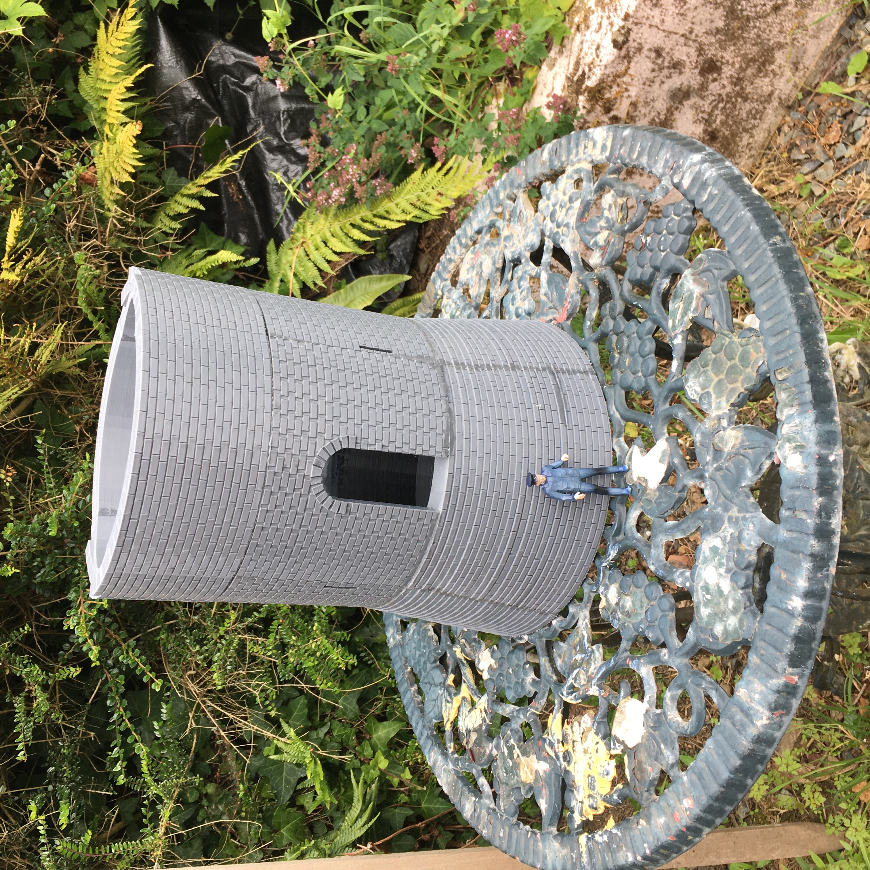

The main tower is now complete, and is in the process of being painted:

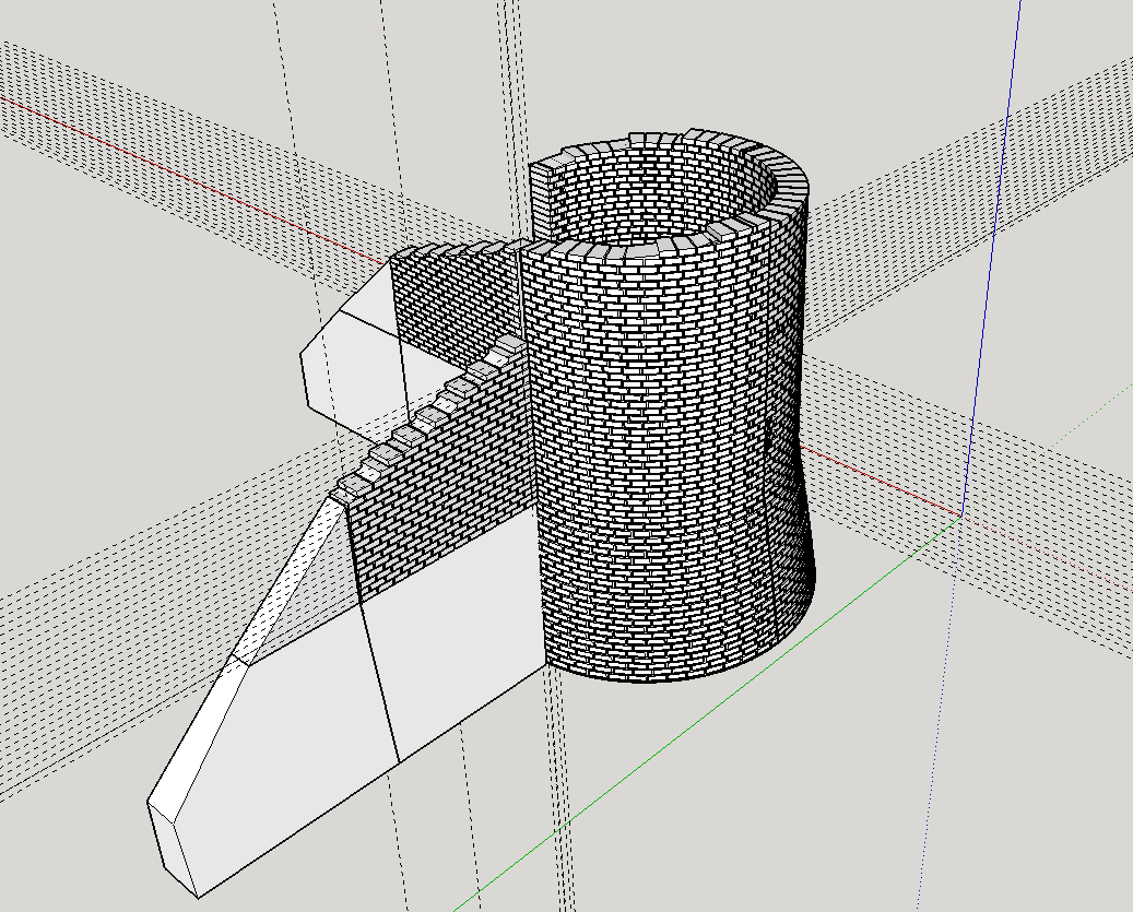

Now I am preparing the outer walls and their towers for printing:
Screenshot 2023-07-04 at 08.12.18.png (140.93 KiB) Viewed 15730 times
The outer towers are based on the main tower reduced to 3/4 size. Both the inside and the outside will be visible so I am adding the stonework embossing to the inside. Because these are in sections I will be able to create towers and walls of different heights and shapes using the components. Excuse all of those guide lines on display - I didn't want to delete them yet as they are there to make sure the stonework aligns from one section to the next.

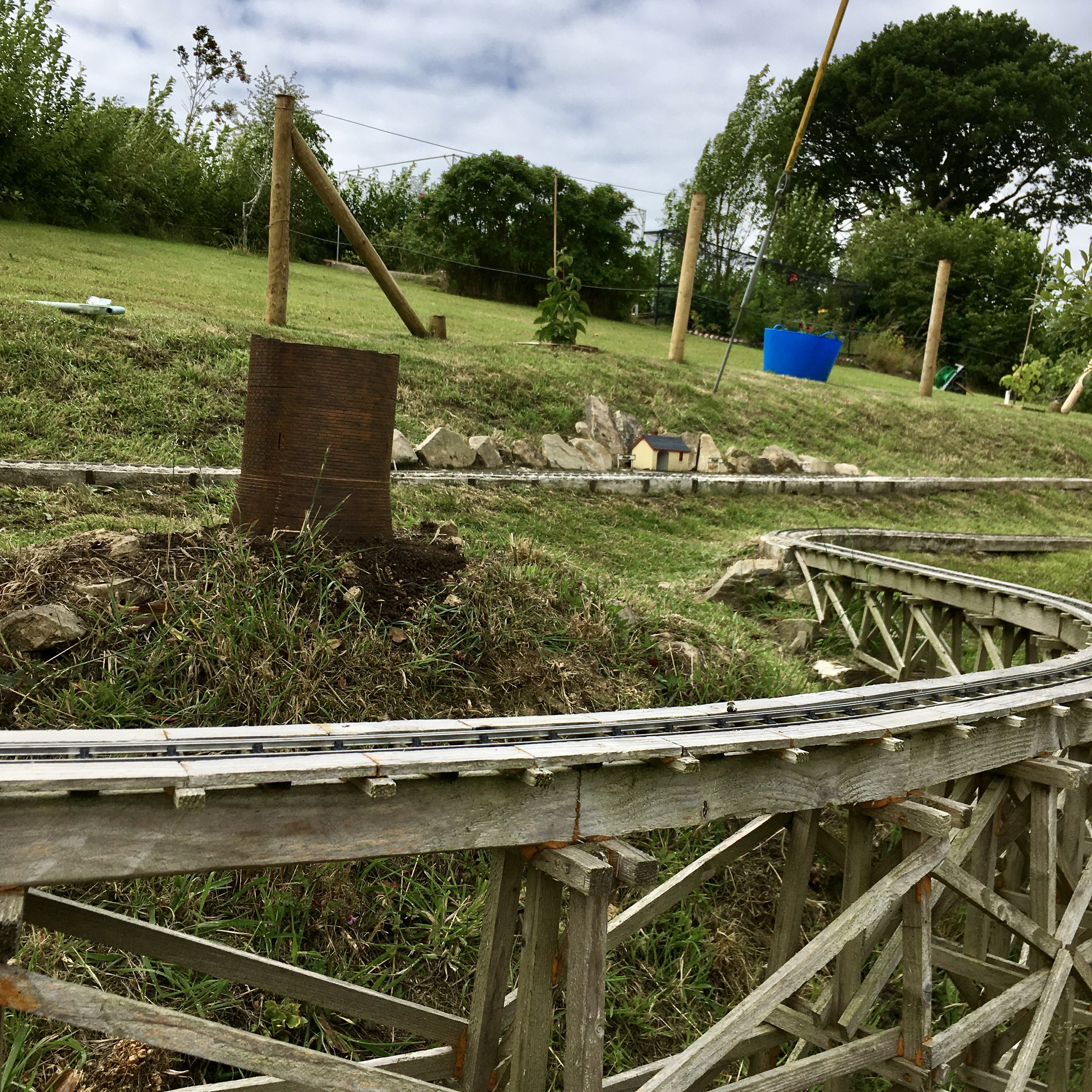

I have just installed the main tower of the castle. A couple of photos:
The second photo looks as if the tower isn't vertical. I think the horizon isn't level in the photo - remember the track is all at an angle. The fence posts in the background don't look level either and they are all at different angles so it is difficult to tell from the photo. I will get the spirit level out though - that photo makes me doubt myself!

Trevor Thompson wrote: Fri Jul 07, 2023 11:40 am I have just installed the main tower of the castle. A couple of photos:
I have checked the level and adjusted it - and retaken the photo with a bit more care to get the horizon level! (The second photo looks as if the tower isn't vertical. I think the horizon isn't level in the photo - remember the track is all at an angle. The fence posts in the background don't look level either and they are all at different angles so it is difficult to tell from the photo. I will get the spirit level out though - that photo makes me doubt myself!)

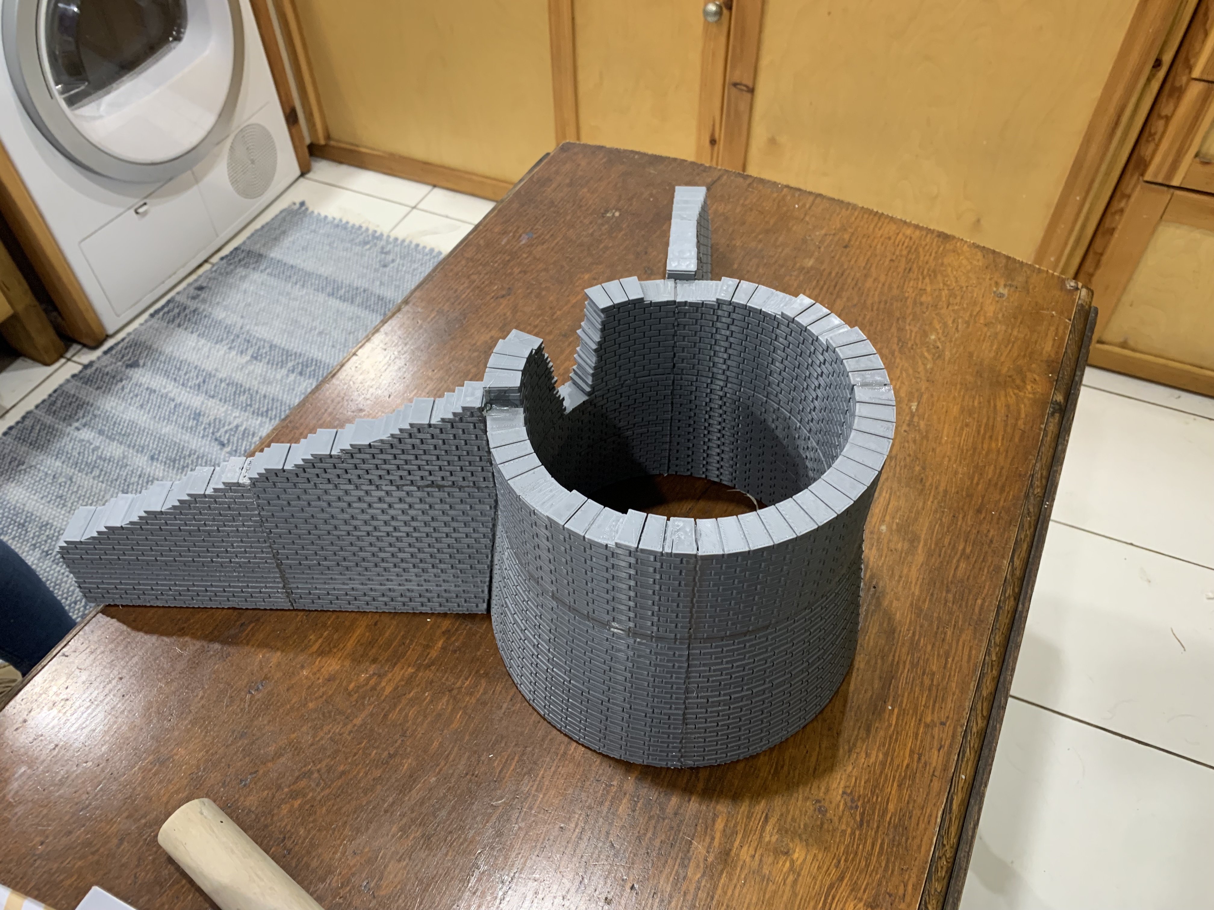

It is a while since I added anything to this thread - I haven't abandoned the project but other things have got in the way. I have steadily been printing parts for it.
This is the first wall tower, with its remains of walls. Another is printed ready for assembly. Then another one is required for the back of the castle.

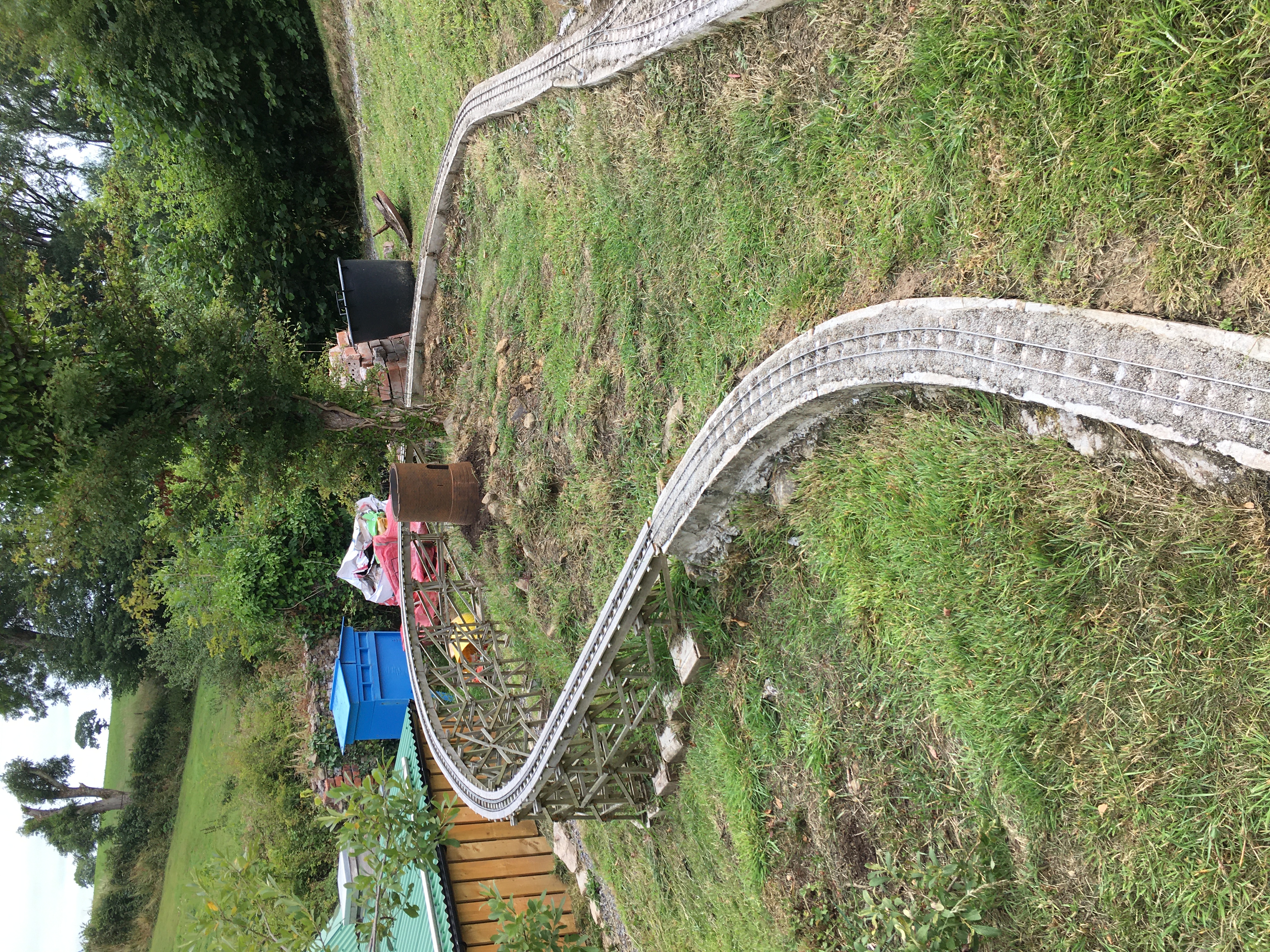

It has been a while since I have been able to get outside to do anything on the railway.

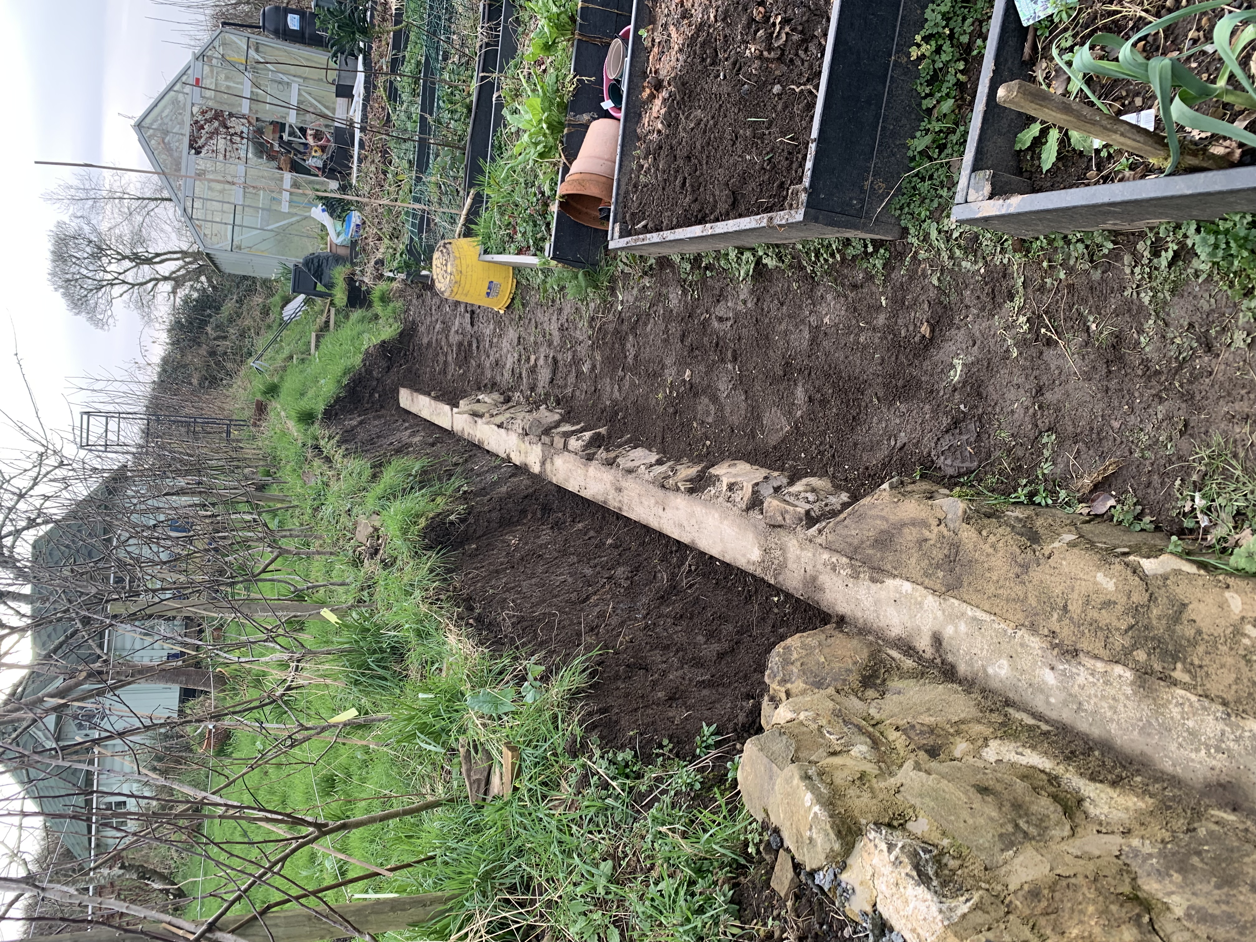

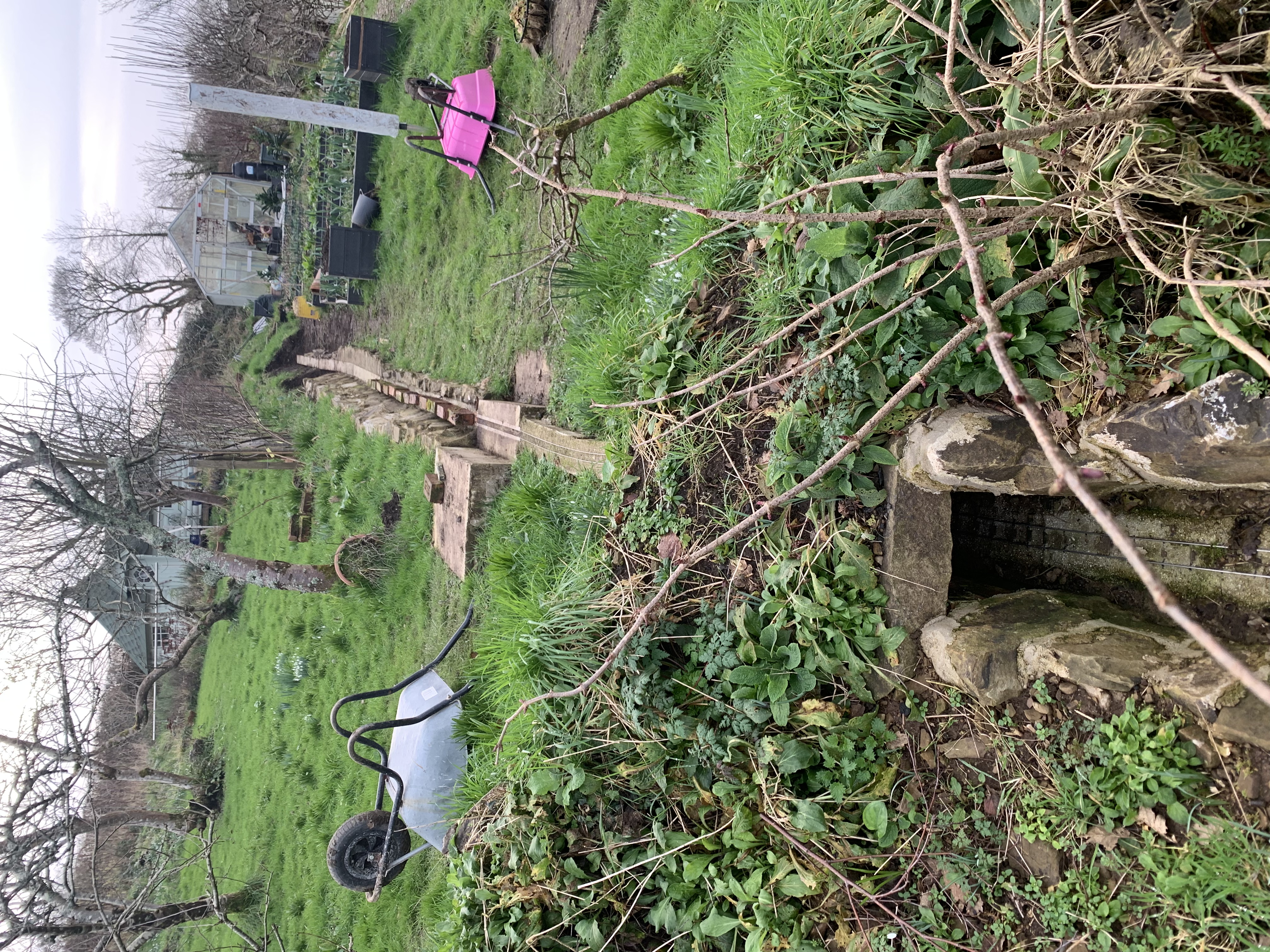

Since we have had some dryer (well less consistently wet) weather I have resumed work on digging out for the extension. I didn't get as far as I had intended with it last year - I got distracted by a major project which had nothing to do with railways - and that took my attention from August until October.
So I have laid 4 lengths of track from the steps towards the greenhouse, and prepared for the next section of retaining wall. You might also be able to see that the trackbed is now only 12 feet away from the steps at the far end.
and the groundwork in more detail:

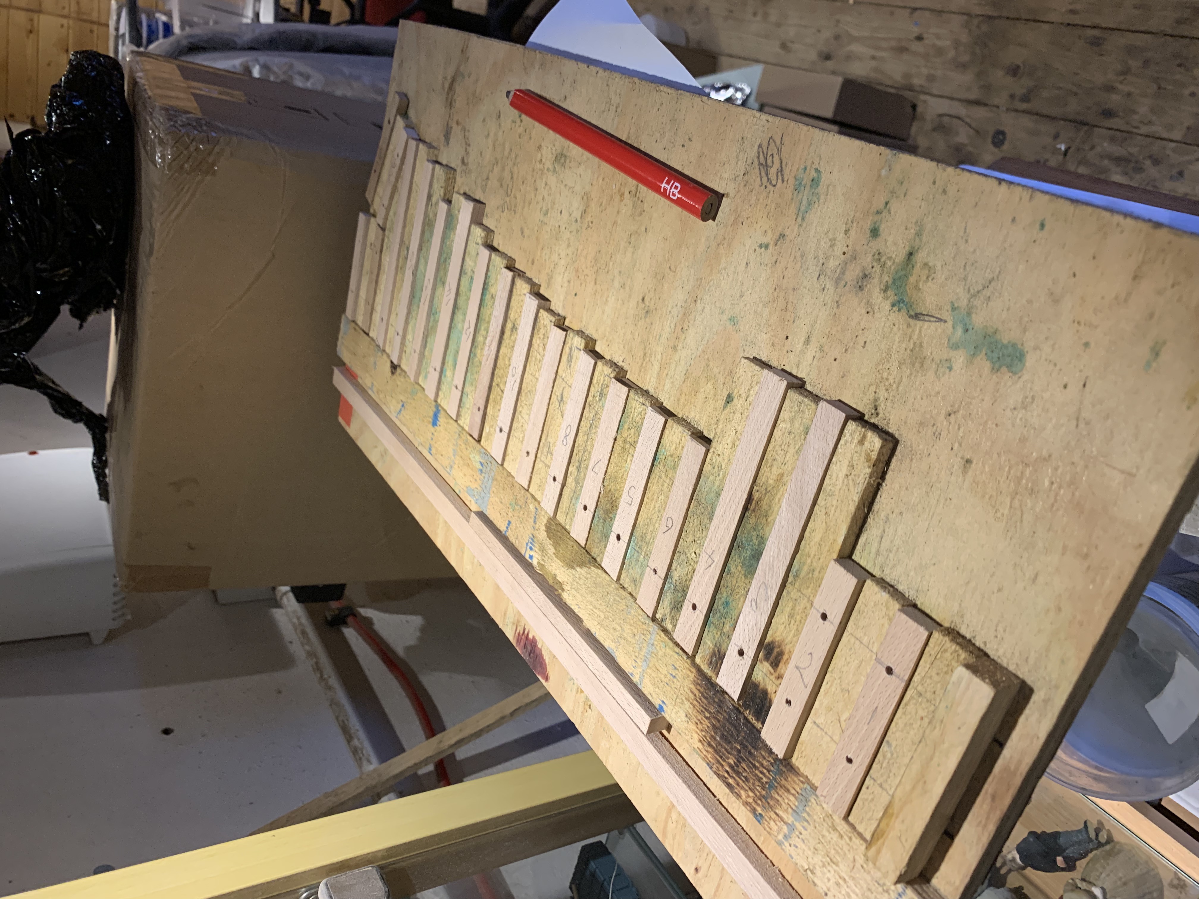

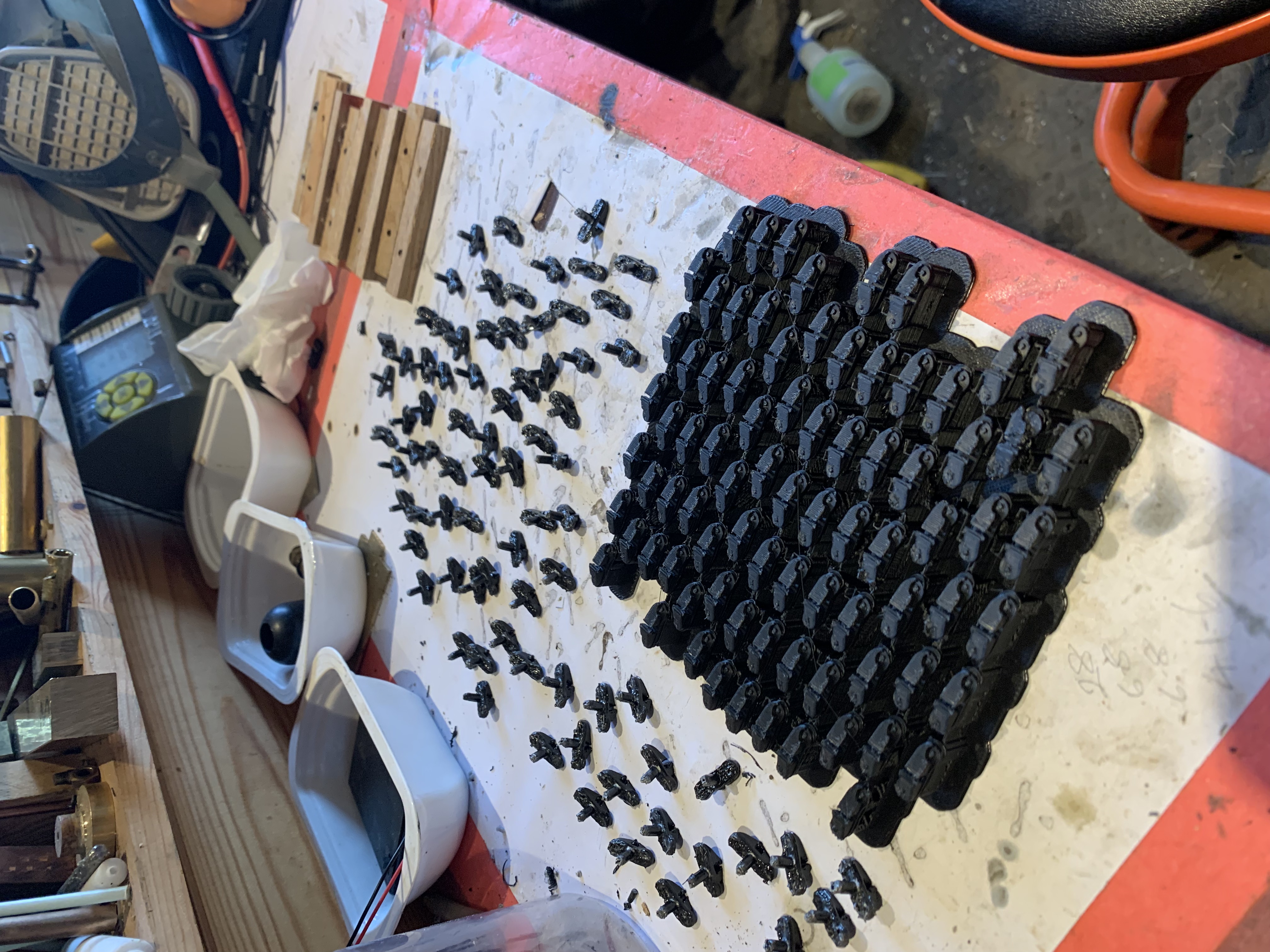

I have planned to add a passing loop at the end of the four lengths of track, at least it will feel like I have been making progress. You might recall that the last track I laid had filament printed chairs. I wasn't sure that they would be strong enough - but they have lasted well, and I am going to use them from now on. I have refined the design and am printing them using the "fine" setting on my slicing software which makes the steps in the finished print far less obvious. It takes a lot longer 17 hours to print 80 chairs. I have been wetting the chairs in a tank of acetone before using them. This seems to make them significantly stronger. I am currently using Oak sleepers which Phil kindly made for me with his bandsaw. The chairs sitting on end on the bench have been in the acetone and are waiting for it to evaporate, before being fixed to the sleepers:
I have started to make the first point, and these are made with more sleepers from Phil, this time from Beech. Now that I am making my own chairs I have decided to go back to using chairs in the points as far as possible, minimising the brass strip soldered to the rail. To that end I have designed the special chairs for the points, and will print them shortly. I hope to be able to bolt the chairs adjacent to the point blades to the rail with 10BA bolts. We will see if that works in due course.
The sleepers are partly prepared and are now soaking in preservative.
